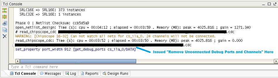

王刚
2018-10-19 15:03:00
在GUI中执行操作时,您可能会在Tcl控制台中观察到相同的Tcl命令。
-----------------------不要忘记回答,kudo,并接受为解决方案.-------------
以上来自于谷歌翻译
以下为原文
When you performed the operation in GUI, you may observe equivalent Tcl commands in Tcl Console.
Don't forget to reply, kudo, and accept as solution.

李亚祎
2018-10-19 15:18:58
在“删除未连接的调试端口和通道”操作期间发出的唯一TCL命令会调整端口的宽度。
没有显示任何实际将通过频道列表,删除未连接的频道并相应地移动剩余的频道号。
而不是试图删除未连接的通道,任何人都可以推荐一种方法将错误降级为警告,以便构建过程可以继续吗?
再次感谢。
以上来自于谷歌翻译
以下为原文
The only TCL command that's issued during the "Remove Unconnected Debug Ports and Channels" operation resizes the width of the port. Nothing is shown that would actually go through the list of channels, remove the unconnected ones and shift the remaining channel numbers accordingly.
Instead of trying to remove the unconnected channels, can anyone recommend a way to demote the error down to a warning so that the build process can continue?
Thanks again.
