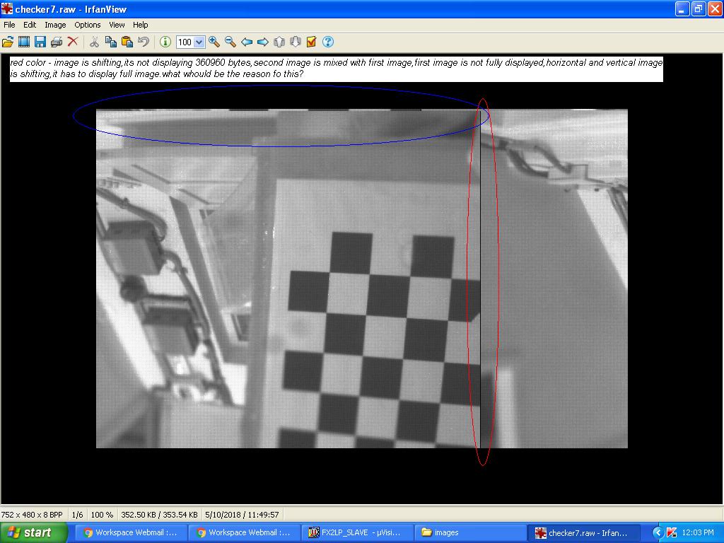

你好,
我有接口的图像传感器在SlaveFIFO模式与FX2LP这,我已经修改了控制中心的PC side.image传感器显示的图像分辨率是752x480 60每帧图像帧second.what曾经在PC机上显示是变化的,这意味着第一架(部分)是不玩第二帧(部分)在DelPaly中。
为什么会发生这种情况?是因为数据丢失吗?FX2LP和Windows不同步?我怎样才能解决这个问题?我附上了图像显示。
帮助我。

  Hello,
I have interfaced image sensor to fx2lp in slavefifo mode and for this,i have modified control center to display the image in the pc side.image sensor is 752x480 resolution with 60 frames per second.what ever the image frame is displaying in the pc is shifting,that means first frame(partial) is displaying with second frame(partial) in the dispaly.
why it is happening?is it because of data loss?fx2lp and windows are not in sync?how can i solve this problem?i have attached the image display.
help me.

你好,
你能比较发送到PC的帧和在应用程序上显示的帧吗?
1)使用像USBLyzer这样的协议分析器,获取一帧的数据
2)在主机显示之前,获取主机应用程序所看到的一个帧的数据以供显示。
比较这两个数据。如果它们是相同的,那么问题就不在PC机/应用程序侧。它可以与图像传感器/ FPGA / FX2LP。
如果不是,问题是主机应用程序代码。
当做,
-马杜
以上来自于百度翻译
     以下为原文
  Hi,
Can you please compare the frame which is sent into PC and the frame which is displayed on the app?
1) Use a protocol analyzer like USBLyzer and get the data of one single frame
2) Get the data of one single frame as seen by the host application, right before it is sent for display
Compare the two data. If they are same, then the problem is not with the PC/App side. It could be with the image sensor / fpga / fx2lp.
If not, the issue is with the host application code.
Regards,
- Madhu

  Hi sir,
we dont have USBLyzer,any other debug process.
thanks for your replay.
regards,
geethanjali.

UsBy泽是一个软件分析器。你不需要任何其他的硬件。从这里下载:
Download USBlyzer,USB嗅探器和数据分析器软件
以上来自于百度翻译
     以下为原文
  USBLyzer is a software analyzer. You don't need any other hardware. Download it from here:
Download USBlyzer, USB Sniffer and Data Analyzer Software
