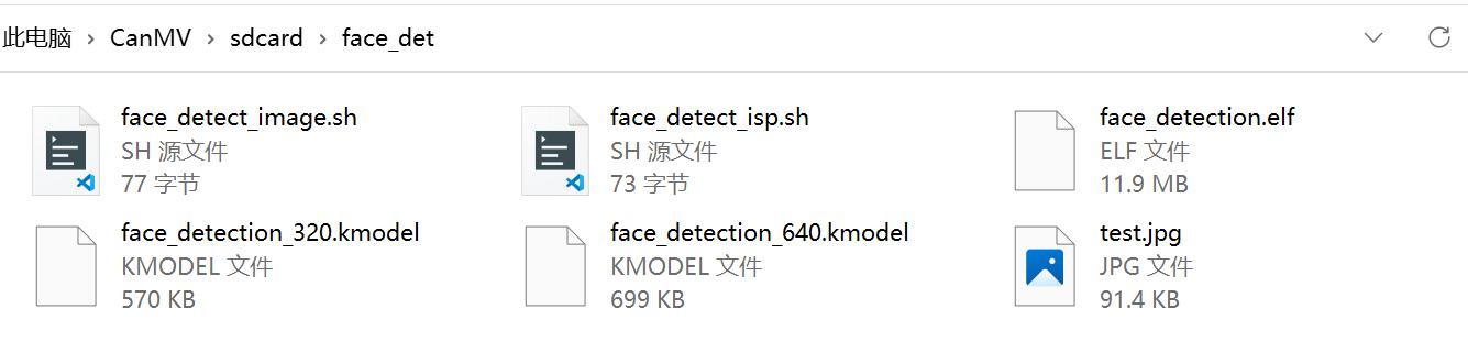

按照示例将face_detection编译好后,拷贝到sd卡中:

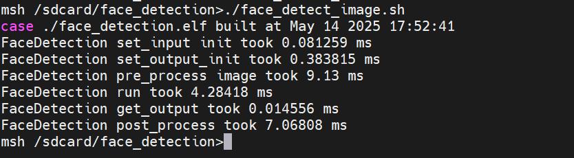

shusheng@D-01117KD7-1705:~/ai_module/rtos_k230/src/rtsmart/examples/face_detection/k230_bin$ riscv64-unknown-linux-musl-addr2line -e face_detection.elf -a -f 0x00000002003452a00x00000002003452a0_ZN6nncase7runtime4k23013mmz_allocator12sanity_checkEv??:?        按照你的步骤做了测试,推理结果正常,你重新烧录一下固件试试。
