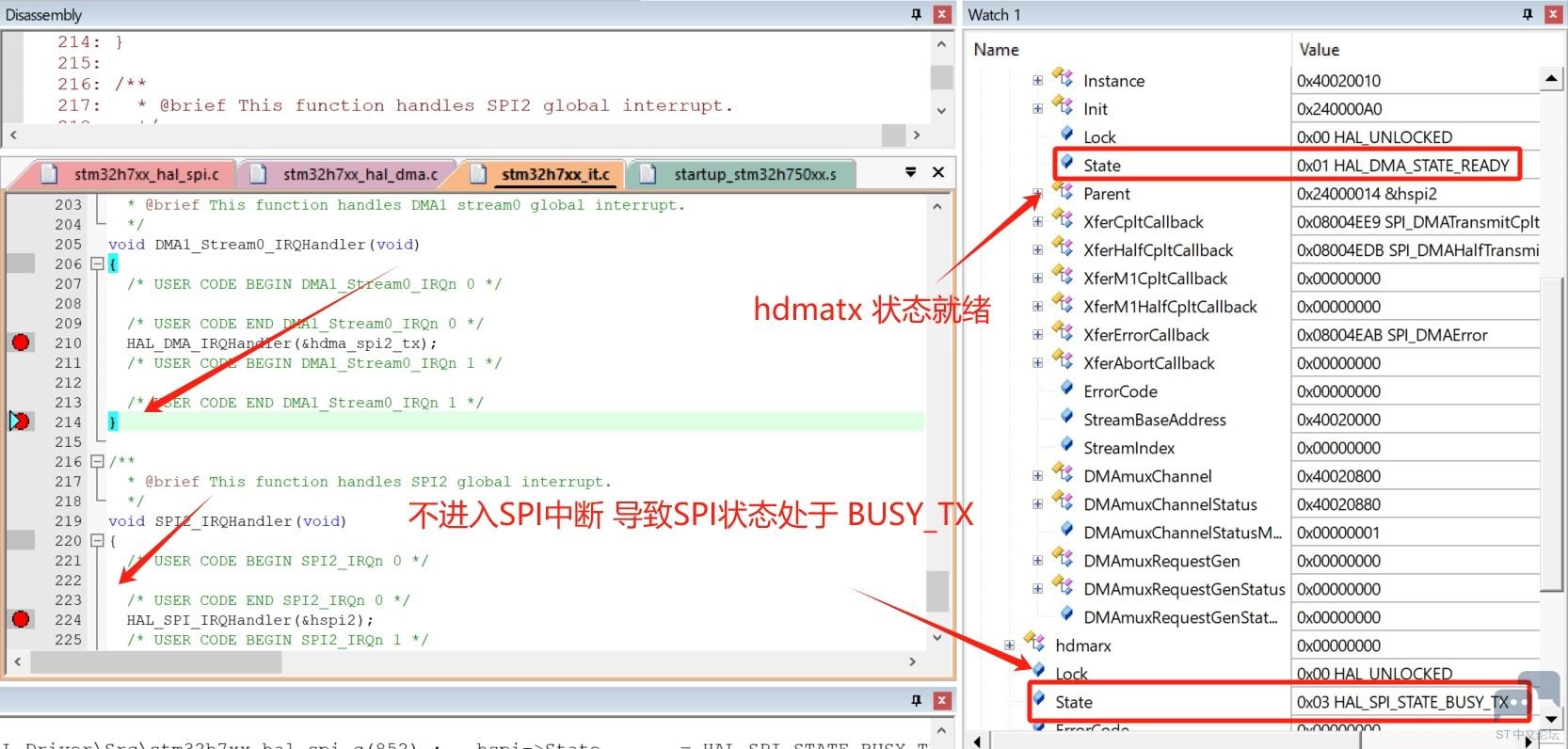

STM32H750XBH6- ART-Pi使用HAL_SPI_Transmit_DMA()函数初次发送时,不进入SPI中断怎么解决?
主控:STM32H750XBH6- ART-Pi
开发环境:CubeMX+MDK V5.27问题背景: DAC芯片需要使用32bit SPI 目前使用轮询方式工作正常 需要硬件SPI+DMA加快速率1.在仅仅更改:以下三项为8bit byte时,单字节的DMA发送是能够多次发送的,功能正常
hspi2.Init.DataSize = SPI_DATASIZE_32BIT;---------------->8BIThdma_spi2_tx.Init.PeriphDataAlignment = DMA_PDATAALIGN_WORD;------->BYTEhdma_spi2_tx.Init.MemDataAlignment = DMA_MDATAALIGN_WORD;------>BYTE2.当前代码使用HAL_SPI_Transmit_DMA()函数初次发送时,能够在逻辑分析仪上看到波形出现(能进入DMA中断),但是不进入SPI中断,导致SPI_Busy3.当前代码由于处于Bus状态导致之后所有DMA发送直接返回
SPI配置项:
void MX_SPI2_Init(void){/* USER CODE BEGIN SPI2_Init 0 *//* USER CODE END SPI2_Init 0 *//* USER CODE BEGIN SPI2_Init 1 *//* USER CODE END SPI2_Init 1 */hspi2.Instance = SPI2;hspi2.Init.Mode = SPI_MODE_MASTER;hspi2.Init.Direction = SPI_DIRECTION_2LINES;hspi2.Init.DataSize = SPI_DATASIZE_32BIT;hspi2.Init.CLKPolarity = SPI_POLARITY_LOW;hspi2.Init.CLKPhase = SPI_PHASE_1EDGE;hspi2.Init.NSS = SPI_NSS_SOFT;hspi2.Init.BaudRatePrescaler = SPI_BAUDRATEPRESCALER_16;hspi2.Init.FirstBit = SPI_FIRSTBIT_MSB;hspi2.Init.TIMode = SPI_TIMODE_DISABLE;hspi2.Init.CRCCalculation = SPI_CRCCALCULATION_DISABLE;hspi2.Init.CRCPolynomial = 0x0;hspi2.Init.NSSPMode = SPI_NSS_PULSE_ENABLE;hspi2.Init.NSSPolarity = SPI_NSS_POLARITY_LOW;hspi2.Init.FifoThreshold = SPI_FIFO_THRESHOLD_01DATA;hspi2.Init.TxCRCInitializationPattern = SPI_CRC_INITIALIZATION_ALL_ZERO_PATTERN;hspi2.Init.RxCRCInitializationPattern = SPI_CRC_INITIALIZATION_ALL_ZERO_PATTERN;hspi2.Init.MasterSSIdleness = SPI_MASTER_SS_IDLENESS_00CYCLE;hspi2.Init.MasterInterDataIdleness = SPI_MASTER_INTERDATA_IDLENESS_00CYCLE;hspi2.Init.MasterReceiverAutoSusp = SPI_MASTER_RX_AUTOSUSP_DISABLE;hspi2.Init.MasterKeepIOState = SPI_MASTER_KEEP_IO_STATE_DISABLE;hspi2.Init.IOSwap = SPI_IO_SWAP_DISABLE;if (HAL_SPI_Init(&hspi2) != HAL_OK){Error_Handler();}/* USER CODE BEGIN SPI2_Init 2 *//* USER CODE END SPI2_Init 2 */}DMA配置项:
void HAL_SPI_MspInit(SPI_HandleTypeDef* spiHandle){  GPIO_InitTypeDef GPIO_InitStruct = {0};  RCC_PeriphCLKInitTypeDef PeriphClkInitStruct = {0};  if(spiHandle->Instance==SPI2)  {  /* USER CODE BEGIN SPI2_MspInit 0 */  /* USER CODE END SPI2_MspInit 0 */  /** Initializes the peripherals clock  */    PeriphClkInitStruct.PeriphClockSelection = RCC_PERIPHCLK_SPI2;    PeriphClkInitStruct.Spi123ClockSelection = RCC_SPI123CLKSOURCE_PLL;    if (HAL_RCCEx_PeriphCLKConfig(&PeriphClkInitStruct) != HAL_OK)    {      Error_Handler();    }    /* SPI2 clock enable */    __HAL_RCC_SPI2_CLK_ENABLE();    __HAL_RCC_GPIOI_CLK_ENABLE();    /**SPI2 GPIO Configuration    PI1     ------> SPI2_SCK    PI2     ------> SPI2_MISO    PI3     ------> SPI2_MOSI    */    GPIO_InitStruct.Pin = GPIO_PIN_1|GPIO_PIN_2|GPIO_PIN_3;    GPIO_InitStruct.Mode = GPIO_MODE_AF_PP;    GPIO_InitStruct.Pull = GPIO_NOPULL;    GPIO_InitStruct.Speed = GPIO_SPEED_FREQ_LOW;    GPIO_InitStruct.Alternate = GPIO_AF5_SPI2;    HAL_GPIO_Init(GPIOI, &GPIO_InitStruct);    /* SPI2 DMA Init */    /* SPI2_TX Init */    hdma_spi2_tx.Instance = DMA1_Stream0;    hdma_spi2_tx.Init.Request = DMA_REQUEST_SPI2_TX;    hdma_spi2_tx.Init.Direction = DMA_MEMORY_TO_PERIPH;    hdma_spi2_tx.Init.PeriphInc = DMA_PINC_DISABLE;    hdma_spi2_tx.Init.MemInc = DMA_MINC_ENABLE;    hdma_spi2_tx.Init.PeriphDataAlignment = DMA_PDATAALIGN_WORD;    hdma_spi2_tx.Init.MemDataAlignment = DMA_MDATAALIGN_WORD;    hdma_spi2_tx.Init.Mode = DMA_NORMAL;    hdma_spi2_tx.Init.Priority = DMA_PRIORITY_LOW;    hdma_spi2_tx.Init.FIFOMode = DMA_FIFOMODE_DISABLE;    hdma_spi2_tx.Init.FIFOThreshold = DMA_FIFO_THRESHOLD_FULL;    hdma_spi2_tx.Init.MemBurst = DMA_MBURST_SINGLE;    hdma_spi2_tx.Init.PeriphBurst = DMA_PBURST_SINGLE;    if (HAL_DMA_Init(&hdma_spi2_tx) != HAL_OK)    {      Error_Handler();    }    __HAL_LINKDMA(spiHandle,hdmatx,hdma_spi2_tx);    /* SPI2 interrupt Init */    HAL_NVIC_SetPriority(SPI2_IRQn, 0, 0);    HAL_NVIC_EnableIRQ(SPI2_IRQn);  /* USER CODE BEGIN SPI2_MspInit 1 */  /* USER CODE END SPI2_MspInit 1 */  }}
