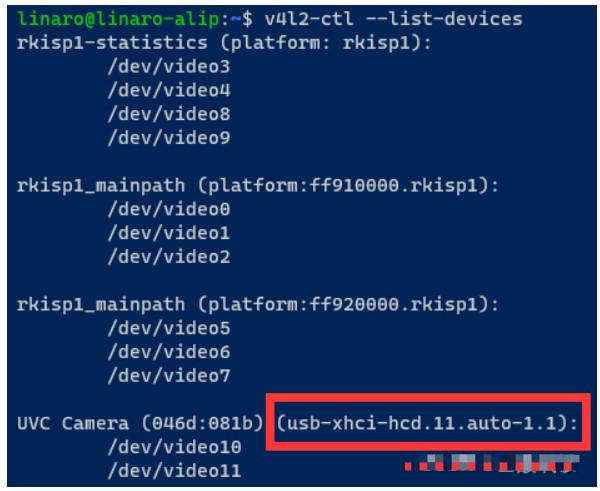

测试u***摄像头

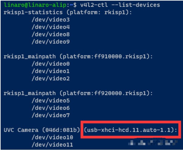

使用
v4l2-ctl --list-devices
检测设备:
可见UVC摄像头是/dev/video10或/dev/video11

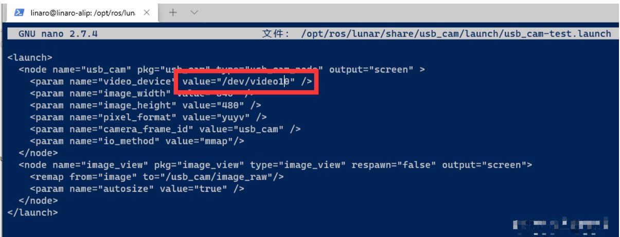

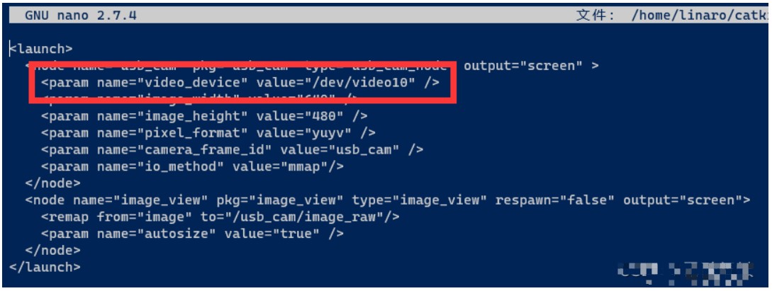

修改u***_cam-test.launch中的video_device :
sudo nano /opt/ros/lunar/share/u***_cam/launch/u***_cam-test.launch

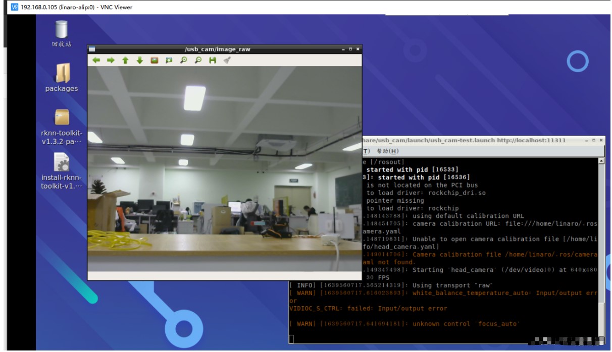

roslaunch u***_cam u***_cam-test.launch

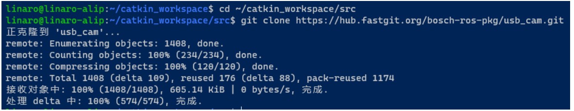

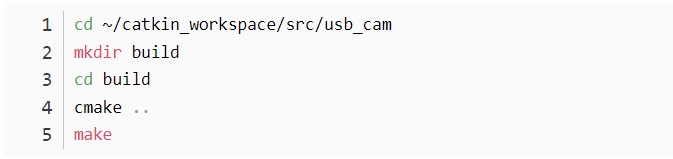

下载u***_cam源码
ource ./devel/setup.bash

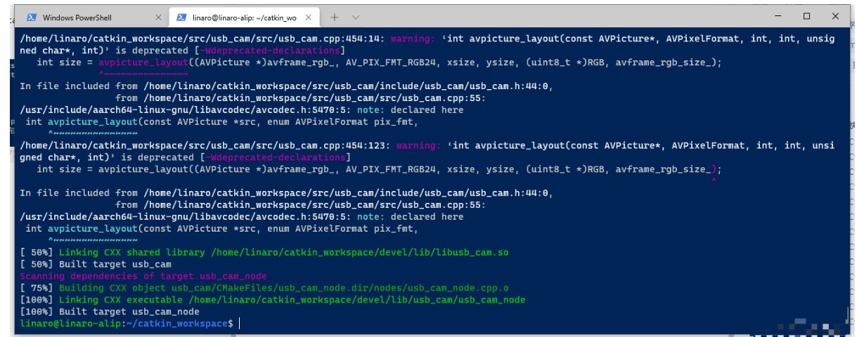

编译
cd ~/catkin_workspace/
catkin_make
检测设备:
sudo nano ~/catkin_workspace/src/u***_cam/launch/u***_cam-test.launch

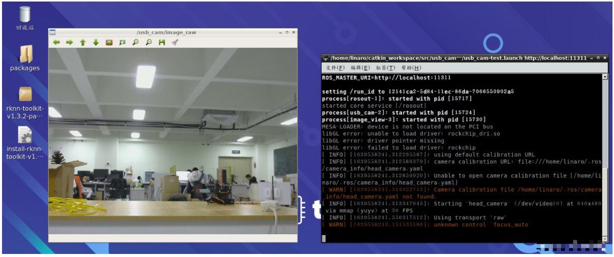

打开新的终端,进入launch文件夹,再运行u***_cam中的launch文件,如果可以成功运行看到图像则安装成功
cd ~/catkin_workspace/src/u***_cam/launch
source ~/catkin_workspace/devel/setup.bash

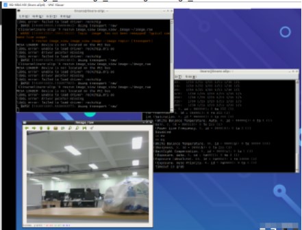

uvc-camera
sudo apt install ros-lunar-uvc-camera
# 打开新的终端
roscore
# 打开新的终端
rosrun uvc_camera uvc_camera_node device:=/dev/video10
# 打开新的终端: 查看话题
rostopic list
# 打开新的终端: /image_raw为对应话题
rosrun image_view image_view image:=/image_raw
