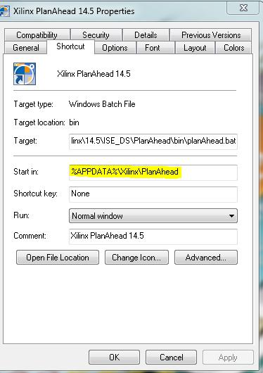

如何更改planahead启动目录?
嗨,
我正在Windows 7上运行planahead 14.7。它给出了一个错误“无法打开句柄planAhead.jou。请检查目录'C:'的访问权限。您应该从可写的工作目录重新启动应用程序。”
我在网上查了一下,这是一个Windows 7权限问题。
谁能给我一个如何更改planahead启动目录的详细说明?
提前致谢。

Hi,
Right click on Planahead icon and select properties. Now change the "start in" location specified here to a directory with full permissions say C:UsersvemuladDocumentstest and click on OK. Now launch Planahead. This will create planahead.log and .jou files at the above mentioned directory.
(or)
  • Go to start --> ISE Design Suite --> Accesories --> 64 bit command prompt
  • Now change the directory to desired location
cd C:UsersvemuladDocumentstest
  • Now type the command planAhead
  • This opens planahead and you can see planahead.log/.jou created at the above mentioned location

Thank you so much. That helps a lot!
