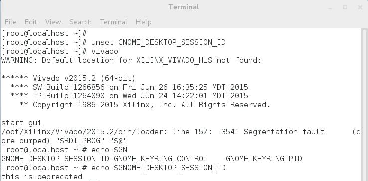

启动Vivado v2015.2(64位)时出现分段错误
你好,
我在CentOS 7中安装了Vivado v2015.2(64位)。
但是,Vivado工具在第二次出现时出现以下错误消息。
/opt/Xilinx/Vivado/2015.2/bin/loader:line 157:3687分段错误(核心转储)“$ RDI_PROG”“$ @”
请让我知道我要做什么。
谢谢,
Chorong Kim
以上来自于谷歌翻译
以下为原文
Hello,
I installed Vivado v2015.2 (64-bit) in CentOS 7.
However, Vivado tool is disappeared in a second with the following error message.
   /opt/Xilinx/Vivado/2015.2/bin/loader: line 157: 3687 Segmentation fault (core dumped) "$RDI_PROG" "$@"
Please, let me know what I have to do.
Thanks,
Chorong Kim

Hi @polaris042
I still observe that the environmental variable GNOME_DESKTOP_SESSION_ID is set. Can you try unsetting it?
Thanks,
Vinay

Hi @polaris042
unset the environmental variable GNOME_DESKTOP_SESSION_ID and try?
Thanks,
Vinay
Have you tried typing your question in Google? If not you should before posting. Also, MARK this is as an answer in case it helped resolve your query/issue.Give kudos to the post that helped you to find the solution.

Yes, I tried it but it doesn't worked.
Hmm.. what is the result after 'unset GNOME_DESKTOP_SESSION_ID' ?
When I tried 'echo $GNOME_DESKTOP_SESSION_ID' after that, I got 'this-is-depreated'.
Is it a correct result?
Thanks,
Chorong Kim

Hi @polaris042
Share the output of the command: env
Thanks,
Vinay
