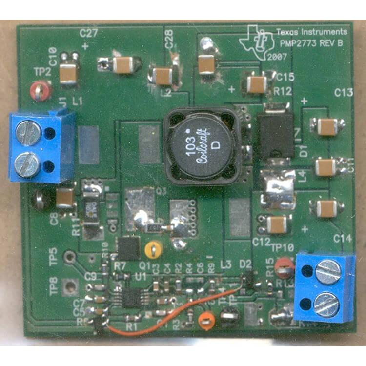

7.5W汽车类单端初级电感转换器设计包括BOM及层图
            The PMP8671 is a single-ended primary-inductor converter (SEPIC) reference design based on an automotive quality controller IC -  the TPS40210-Q1. It operates over a 4.5-V to 24-V input range and delivers 6.25 V at 1.2-A maximum output current. The switching frequency is set to 400 kHz to  (...)
主要特色
  • Low-cost SEPIC
  • Excellent load and line regulation
  • Built on a universal board - for reducing EMI, a layout proposal is provided
