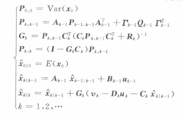

我们知道卡尔曼滤波算法的公式如下:
由于相关系数都为1,于是可以得出如下公式: { P 0 , 0 = 0 P k , k − 1 = P k − 1 , k − 1 + Q G k = P k , k − 1 / ( P k , k − 1 + R ) P k , k = ( 1 − G k ) P k , k − 1 x 0 ∣ 0 = 0 x k ∣ k − 1 = x k − 1 ∣ k − 1 x k ∣ k = x k ∣ k − 1 + G k ( Z k − x k ∣ k − 1 ) begin{cases} P_{0,0} = 0 P_{k,k-1}=P_{k-1,k-1} +Q  G_k = P_{k,k-1}/(P_{k,k-1}+R)  P_{k,k}=(1-G_k)P_{k,k-1}  x_{0|0} = 0  x_{k|k-1} = x_{k-1|k-1}  x_{k|k}=x_{k|k-1}+G_k(Z_k-x_{k|k-1}) end{cases} ⎩⎪⎪⎪⎪⎪⎪⎪⎪⎪⎪⎨⎪⎪⎪⎪⎪⎪⎪⎪⎪⎪⎧​P0,0​=0Pk,k−1​=Pk−1,k−1​+QGk​=Pk,k−1​/(Pk,k−1​+R)Pk,k​=(1−Gk​)Pk,k−1​x0∣0​=0xk∣k−1​=xk−1∣k−1​xk∣k​=xk∣k−1​+Gk​(Zk​−xk∣k−1​)​
