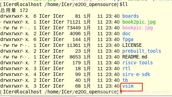

2.Git下载
打开terminal,使用下面命令进行下载,记得虚拟机连接网络。
git clone https://github.com/SI-RISCV/e200_opensource.git

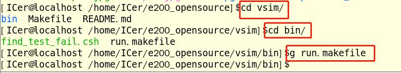

下面就是e203项目的目录,我们现在进入vsim(验证目录),其他先不管,后面的分享会慢慢介绍到。
3.修改环境
进入到仿真的bin目录下,打开run.makefile
仿真脚本修改如下:

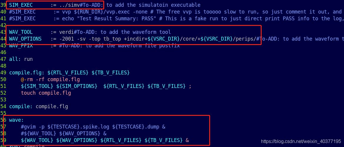

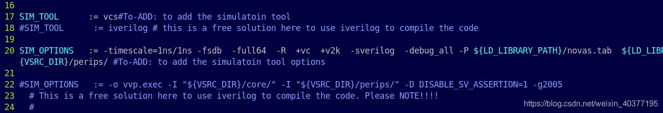

1)修改仿真工具,添加vcs仿真选项,“LD_LIBRARY_PATH”是novas的路径,根据自己环境修改下。
2)添加verdi环境
修改好的仿真环境如下:
RUN_DIR      := ${PWD}TESTCASE     := ${RUN_DIR}/../../riscv-tools/riscv-tests/isa/generated/rv32ui-p-addiDUMPWAVE     := 1VSRC_DIR     := ${RUN_DIR}/../install/rtlVTB_DIR      := ${RUN_DIR}/../install/tbTESTNAME     := $(notdir $(patsubst %.dump,%,${TESTCASE}.dump))TEST_RUNDIR  := ${TESTNAME}RTL_V_FILES                := $(wildcard ${VSRC_DIR}/*/*.v)TB_V_FILES                := $(wildcard ${VTB_DIR}/*.v)# The following portion is depending on the EDA tools you are using, Please add them by yourself according to your EDA vendorsSIM_TOOL      := vcs#To-ADD: to add the simulatoin tool#SIM_TOOL      := iverilog # this is a free solution here to use iverilog to compile the codeSIM_OPTIONS   := -timescale=1ns/1ns -fsdb  -full64  -R  +vc  +v2k  -sverilog  -debug_all -P ${LD_LIBRARY_PATH}/novas.tab  ${LD_LIBRARY_PATH}/pli.a -l vcs.log +incdir+${VSRC_DIR}/core/+${VSRC_DIR}/perips/ #To-ADD: to add the simulatoin tool options #SIM_OPTIONS   := -o vvp.exec -I "${VSRC_DIR}/core/" -I "${VSRC_DIR}/perips/" -D DISABLE_SV_ASSERTION=1 -g2005   # This is a free solution here to use iverilog to compile the code. Please NOTE!!!!   #   # Note:   #   Here we add a macro "DISABLE_SV_ASSERTION" to disable the system-verilog coded   #     assertion in the RTL code because iverilog cannot support that syntax, if you  #     use other EDA tools which support the systemverilog, you should not add this macro "DISABLE_SV_ASSERTION".  #      #   Here we didnt add macro "ENABLE_TB_FORCE"  #     that macro was used to enable the random interrupt and bus-error insertion to make  #           more intensive test in e200_opensource/tb/tb_top.v.  #           Although the test become more intensive, the drawback is it makes the regression   #           simulation running very slower, so by default now it is turned off.  #           If you want to turn on them without caring the the regression speed,  #           you can just add macro `ENABLE_TB_FORCE` here in command line.SIM_EXEC      := ../simv#To-ADD: to add the simulatoin executable#SIM_EXEC      := vvp ${RUN_DIR}/vvp.exec -none # The free vvp is tooooo slow to run, so just comment it out, and replaced with the fake way below#SIM_EXEC      := echo "Test Result Summary: PASS" # This is a fake run to just direct print PASS info to the log, the user need to actually replace it to the real EDA commandWAV_TOOL      := verdi#To-ADD: to add the waveform toolWAV_OPTIONS   := -2001 -sv -top tb_top +incdir+${VSRC_DIR}/core/+${VSRC_DIR}/perips/#To-ADD: to add the waveform tool options WAV_PFIX      := #To-ADD: to add the waveform file postfixall: runcompile.flg: ${RTL_V_FILES} ${TB_V_FILES}        @-rm -rf compile.flg        ${SIM_TOOL} ${SIM_OPTIONS}  ${RTL_V_FILES} ${TB_V_FILES} ;        touch compile.flgcompile: compile.flg wave:         #gvim -p ${TESTCASE}.spike.log ${TESTCASE}.dump &        #${WAV_TOOL} ${WAV_OPTIONS} &         ${WAV_TOOL} ${WAV_OPTIONS} ${RTL_V_FILES} ${TB_V_FILES} &run: compile        rm -rf ${TEST_RUNDIR}        mkdir ${TEST_RUNDIR}        cd ${TEST_RUNDIR}; ${SIM_EXEC} +DUMPWAVE=${DUMPWAVE} +TESTCASE=${TESTCASE} |& tee ${TESTNAME}.log; cd ${RUN_DIR}; .PHONY: run clean all

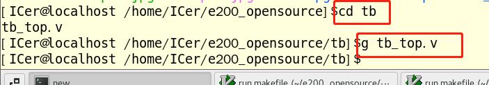

进入tb目录,打开tb_top.v
加入以下代码,这个是产生verdi使用的波形文件。
[color=rgba(0, 0, 0, 0.75)]initial begin    $value$plusargs("DUMPWAVE=%d",dumpwave);    if(dumpwave != 0)begin         // To add your waveform generation function         $fsdbDumpfile("ware.fsdb");         $fsdbDumpvars("+all");    endend

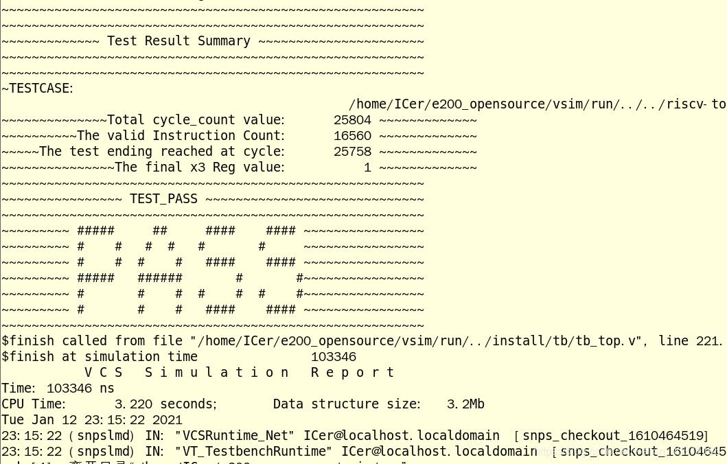

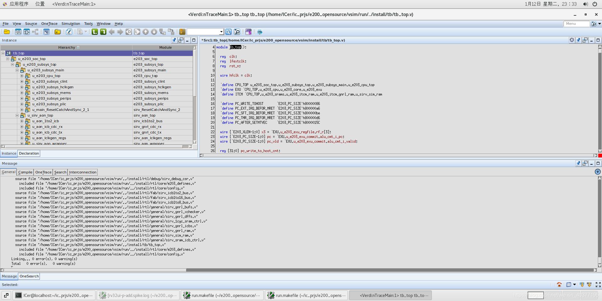

5.运行仿真
进入到vsim目录下,先执行下面命令,会生成install目录,这里面是copy过来源代码和tb。
make install CORE=e203
执行下面命令,执行仿真,仿真结束后打印如下图的“PASS”。
make compilemake run_test
运行以下命令启动verdi;
make wave
6.总结
修改仿真环境比较简单,现在可以使用Verdi去学习RTL代码,这样效率会高很多。这部分基于我之前分享的EDA环境进行的,以后也是基于这个环境,所以想一起学习的盆友,最好使用我的环境,公众号后台回复:EDA虚拟机可以获得完整EDA环境(虚拟机)。这个修改好的E203工程我也上传到gitee,传送门:e203_mod,后面修改的工程也会上传到gitee。
