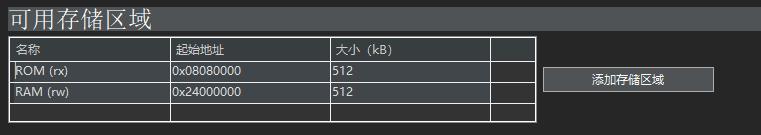

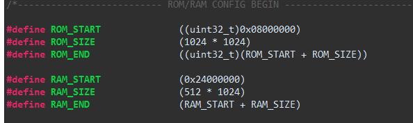

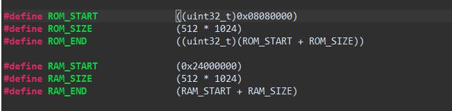

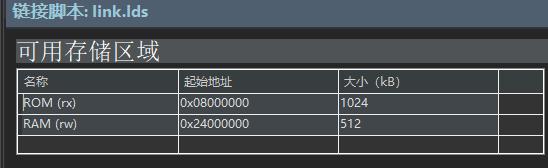

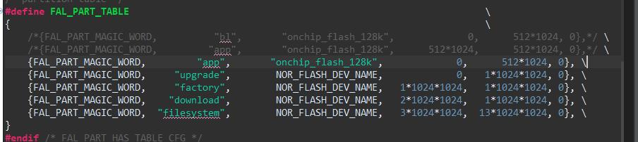

首先是boot工程的配置:
然后是app工程的配置:

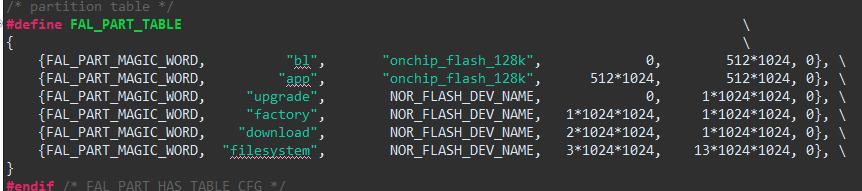

注:boot和app工程中,fal配置内部flash的地址和大小都和对应的#define ROM_START              、#define ROM_SIZE保持一致

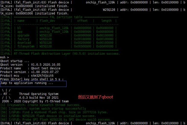

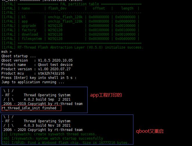

当我把HAL_DeInit();注释掉,其他不变,现象如下图
这是我app中注释的代码段

  • int rtthread_startup(void)
  •     rt_hw_interrupt_disable();
  •     /* board level initialization
  •      * NOTE: please initialize heap inside board initialization.
  •     rt_hw_board_init();
  •     /* show RT-Thread version */
  •     rt_show_version();
  •     /* timer system initialization */
  •     rt_system_timer_init();
  •     /* scheduler system initialization */
  •     rt_system_scheduler_init();
  • #ifdef RT_USING_SIGNALS
  •     /* signal system initialization */
  •     rt_system_signal_init();
  • #endif
  •     /* create init_thread */
  •     rt_application_init();
  •     /* timer thread initialization */
  •     rt_system_timer_thread_init();
  •     /* idle thread initialization */
  •     rt_thread_idle_init();
  •     rt_kprintf("rt_thread_idle_init finshedn");
  • #ifdef RT_USING_SMP
  •     rt_hw_spin_lock(&_cpus_lock);
  • #endif /*RT_USING_SMP*/
  •     /* start scheduler */
  •     rt_system_scheduler_start();
  •     rt_kprintf("rt_system_scheduler_start finshedn");
  •     /* never reach here */
  •     return 0;
