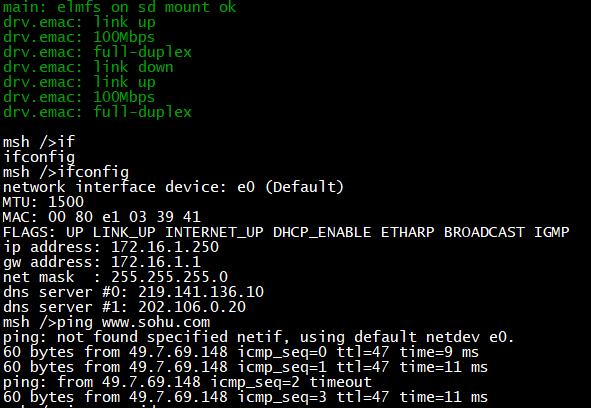

rt-thread LAN8720A+F407 100M连接,开机ping外网都正常, 一段时间后变成10M和半双工,为什么?
然后一段时间后,可能一小时,可能半小时,会出现link down信息,网络就变成10M和半双工了,此时再ping就不行了
不知道是驱动问题还是协议栈有啥问题
下面是drv_eth.c,基本没有改动 rtt5.1.0版本

  •     /* Set Own bit in Rx descriptors: gives the buffers back to DMA */
  •     for (i = 0; i < EthHandle.RxFrameInfos.SegCount; i++)
  •         dmarxdesc->Status |= ETH_DMARXDESC_OWN;
  •         dmarxdesc = (ETH_DMADescTypeDef *)(dmarxdesc->Buffer2NextDescAddr);
  •     /* Clear Segment_Count */
  •     EthHandle.RxFrameInfos.SegCount = 0;
  •     /* When Rx Buffer unavailable flag is set: clear it and resume reception */
  •     if ((EthHandle.Instance->DMASR & ETH_DMASR_RBUS) != (uint32_t)RESET)
  •         /* Clear RBUS ETHERNET DMA flag */
  •         EthHandle.Instance->DMASR = ETH_DMASR_RBUS;
  •         /* Resume DMA reception */
  •         EthHandle.Instance->DMARPDR = 0;
  •     return p;
  • /* interrupt service routine */
  • void ETH_IRQHandler(void)
  •     /* enter interrupt */
  •     rt_interrupt_enter();
  •     HAL_ETH_IRQHandler(&EthHandle);
  •     /* leave interrupt */
  •     rt_interrupt_leave();
  • void HAL_ETH_RxCpltCallback(ETH_HandleTypeDef *heth)
  •     rt_err_t result;
  •     result = eth_device_ready(&(stm32_eth_device.parent));
  •     if (result != RT_EOK)
  •         LOG_I("RxCpltCallback err = %d", result);
  • void HAL_ETH_ErrorCallback(ETH_HandleTypeDef *heth)
  •     LOG_E("eth err");
  • enum {
  •     PHY_LINK        = (1 << 0),
  •     PHY_100M        = (1 << 1),
  •     PHY_FULL_DUPLEX = (1 << 2),
  • static void phy_linkchange()
  •     static rt_uint8_t phy_speed = 0;
  •     rt_uint8_t phy_speed_new = 0;
  •     rt_uint32_t status;
  •     HAL_ETH_ReadPHYRegister(&EthHandle, PHY_BASIC_STATUS_REG, (uint32_t *)&status);
  •     LOG_D("phy basic status reg is 0x%X", status);
  •     if (status & (PHY_AUTONEGO_COMPLETE_MASK | PHY_LINKED_STATUS_MASK))
  •         rt_uint32_t SR = 0;
  •         phy_speed_new |= PHY_LINK;
  •         HAL_ETH_ReadPHYRegister(&EthHandle, PHY_Status_REG, (uint32_t *)&SR);
  •         LOG_D("phy control status reg is 0x%X", SR);
  •         if (PHY_Status_SPEED_100M(SR))
  •             phy_speed_new |= PHY_100M;
  •         if (PHY_Status_FULL_DUPLEX(SR))
  •             phy_speed_new |= PHY_FULL_DUPLEX;
  •     if (phy_speed != phy_speed_new)
  •         phy_speed = phy_speed_new;
  •         if (phy_speed & PHY_LINK)
  •             LOG_I("link up");
  •             if (phy_speed & PHY_100M)
  •                 LOG_I("100Mbps");
  •                 stm32_eth_device.ETH_Speed = ETH_SPEED_100M;
  •             else
  •                 stm32_eth_device.ETH_Speed = ETH_SPEED_10M;
  •                 LOG_I("10Mbps");
  •             if (phy_speed & PHY_FULL_DUPLEX)
  •                 LOG_I("full-duplex");
  •                 stm32_eth_device.ETH_Mode = ETH_MODE_FULLDUPLEX;
  •             else
  •                 LOG_I("half-duplex");
  •                 stm32_eth_device.ETH_Mode = ETH_MODE_HALFDUPLEX;
  •             /* send link up. */
  •             eth_device_linkchange(&stm32_eth_device.parent, RT_TRUE);
  •         else
  •             LOG_I("link down");
  •             eth_device_linkchange(&stm32_eth_device.parent, RT_FALSE);
  • #ifdef PHY_USING_INTERRUPT_MODE
  • static void eth_phy_isr(void *args)
  •     rt_uint32_t status = 0;
  •     HAL_ETH_ReadPHYRegister(&EthHandle, PHY_INTERRUPT_FLAG_REG, (uint32_t *)&status);
  •     LOG_D("phy interrupt status reg is 0x%X", status);
  •     phy_linkchange();
  • #endif /* PHY_USING_INTERRUPT_MODE */
  • static void phy_monitor_thread_entry(void *parameter)
  •     uint8_t phy_addr = 0xFF;
  •     uint8_t detected_count = 0;
  •     while(phy_addr == 0xFF)
  •         /* phy search */
  •         rt_uint32_t i, temp;
  •         for (i = 0; i <= 0x1F; i++)
  •             EthHandle.Init.PhyAddress = i;
  •             HAL_ETH_ReadPHYRegister(&EthHandle, PHY_ID1_REG, (uint32_t *)&temp);
  •             if (temp != 0xFFFF && temp != 0x00)
  •                 phy_addr = i;
  •                 break;
  •         detected_count++;
  •         rt_thread_mdelay(1000);
  •         if (detected_count > 10)
  •             LOG_E("No PHY device was detected, please check hardware!");
  •     LOG_D("Found a phy, address:0x%02X", phy_addr);
  •     /* RESET PHY */
  •     LOG_D("RESET PHY!");
  •     HAL_ETH_WritePHYRegister(&EthHandle, PHY_BASIC_CONTROL_REG, PHY_RESET_MASK);
  •     rt_thread_mdelay(2000);
  •     HAL_ETH_WritePHYRegister(&EthHandle, PHY_BASIC_CONTROL_REG, PHY_AUTO_NEGOTIATION_MASK);
  •     phy_linkchange();
  •     /* configuration intterrupt pin */
  •     rt_pin_mode(PHY_INT_PIN, PIN_MODE_INPUT_PULLUP);
  •     rt_pin_attach_irq(PHY_INT_PIN, PIN_IRQ_MODE_FALLING, eth_phy_isr, (void *)"callbackargs");
  •     rt_pin_irq_enable(PHY_INT_PIN, PIN_IRQ_ENABLE);
  •     /* enable phy interrupt */
  •     HAL_ETH_WritePHYRegister(&EthHandle, PHY_INTERRUPT_MASK_REG, PHY_INT_MASK);
  • #if defined(PHY_INTERRUPT_CTRL_REG)
  •     HAL_ETH_WritePHYRegister(&EthHandle, PHY_INTERRUPT_CTRL_REG, PHY_INTERRUPT_EN);
  • #endif
  • #else /* PHY_USING_INTERRUPT_MODE */
  •     stm32_eth_device.poll_link_timer = rt_timer_create("phylnk", (void (*)(void*))phy_linkchange,
  •                                         NULL, RT_TICK_PER_SECOND, RT_TIMER_FLAG_PERIODIC);
  •     if (!stm32_eth_device.poll_link_timer || rt_timer_start(stm32_eth_device.poll_link_timer) != RT_EOK)
  •         LOG_E("Start link change detection timer failed");
  • /* Register the EMAC device */
  • static int rt_hw_stm32_eth_init(void)
  •     rt_err_t state = RT_EOK;
  •     /* Prepare receive and send buffers */
  •     Rx_Buff = (rt_uint8_t *)rt_calloc(ETH_RXBUFNB, ETH_MAX_PACKET_SIZE);
  •     if (Rx_Buff == RT_NULL)
  •         LOG_E("No memory");
  •         state = -RT_ENOMEM;
  •         goto __exit;
  •     Tx_Buff = (rt_uint8_t *)rt_calloc(ETH_TXBUFNB, ETH_MAX_PACKET_SIZE);
  •     if (Tx_Buff == RT_NULL)
  •         goto __exit;
  •     DMARxDscrTab = (ETH_DMADescTypeDef *)rt_calloc(ETH_RXBUFNB, sizeof(ETH_DMADescTypeDef));
  •     if (DMARxDscrTab == RT_NULL)
  •         goto __exit;
  •     DMATxDscrTab = (ETH_DMADescTypeDef *)rt_calloc(ETH_TXBUFNB, sizeof(ETH_DMADescTypeDef));
  •     if (DMATxDscrTab == RT_NULL)
  •         goto __exit;
  •     /* OUI 00-80-E1 STMICROELECTRONICS. */
  •     stm32_eth_device.dev_addr[0] = 0x00;
  •     stm32_eth_device.dev_addr[1] = 0x80;
  •     stm32_eth_device.dev_addr[2] = 0xE1;
  •     /* generate MAC addr from 96bit unique ID (only for test). */
  •     stm32_eth_device.dev_addr[3] = *(rt_uint8_t *)(UID_BASE + 4);
  •     stm32_eth_device.dev_addr[4] = *(rt_uint8_t *)(UID_BASE + 2);
  •     stm32_eth_device.dev_addr[5] = *(rt_uint8_t *)(UID_BASE + 0);
  •     stm32_eth_device.parent.parent.init       = rt_stm32_eth_init;
  •     stm32_eth_device.parent.parent.open       = rt_stm32_eth_open;
  •     stm32_eth_device.parent.parent.close      = rt_stm32_eth_close;
  •     stm32_eth_device.parent.parent.read       = rt_stm32_eth_read;
  •     stm32_eth_device.parent.parent.write      = rt_stm32_eth_write;
  •     stm32_eth_device.parent.parent.control    = rt_stm32_eth_control;
  •     stm32_eth_device.parent.parent.user_data  = RT_NULL;
  •     stm32_eth_device.parent.eth_rx     = rt_stm32_eth_rx;
  •     stm32_eth_device.parent.eth_tx     = rt_stm32_eth_tx;
  •     /* register eth device */
  •     state = eth_device_init(&(stm32_eth_device.parent), "e0");
  •     if (RT_EOK == state)
  •         LOG_D("emac device init success");
  •     else
  •         LOG_E("emac device init faild: %d", state);
  •         state = -RT_ERROR;
  •         goto __exit;
  •     /* start phy monitor */
  •     rt_thread_t tid;
  •     tid = rt_thread_create("phy",
  •                            phy_monitor_thread_entry,
  •                            RT_NULL,
  •                            1024,
  •                            RT_THREAD_PRIORITY_MAX - 2,
  •                            2);
  •     if (tid != RT_NULL)
  •         rt_thread_startup(tid);
  •     else
  • __exit:
  •     if (state != RT_EOK)
  •         if (Rx_Buff)
  •             rt_free(Rx_Buff);
  •         if (Tx_Buff)
  •             rt_free(Tx_Buff);
  •         if (DMARxDscrTab)
  •             rt_free(DMARxDscrTab);
  •         if (DMATxDscrTab)
  •             rt_free(DMATxDscrTab);
  •     return state;
  • INIT_DEVICE_EXPORT(rt_hw_stm32_eth_init);
  • #endif
