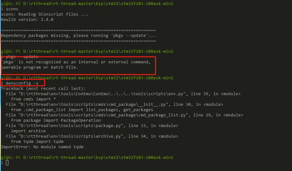

env装好了,执行scons的时候,报错是哪里的问题?
按住官方文档配置完了。然后运行scons,然后就报错:
  • Dependency packages missing, please running 'pkgs --update'...
我继续pkgs --update,然后就报错:
  • 'pkge' is not recognized as an internal or external command,
  • operable program or batch file.
然后执行menuconfig -s,继续报错:
  • Traceback (most recent call last):
  •   File "D:rtthreadenvtoolsConEmuConEmu......toolsscriptsenv.py", line 39, in
  •     from cmds import *
  •   File "D:rtthreadenvtoolsscriptscmdscmd_package__init__.py", line 30, in
  •     from .cmd_package_list import list_packages, get_packages
  •   File "D:rtthreadenvtoolsscriptscmdscmd_packagecmd_package_list.py", line 29, in
  •     from package import PackageOperation
  •   File "D:rtthreadenvtoolsscriptspackage.py", line 33, in
  •     import archive
  •   File "D:rtthreadenvtoolsscriptsarchive.py", line 34, in
  •     from tqdm import tqdm
  • ImportError: No module named tqdm
去大佬帮忙看下。

陈斌
2025-9-11 17:25:00
没有过pkge命令吧
