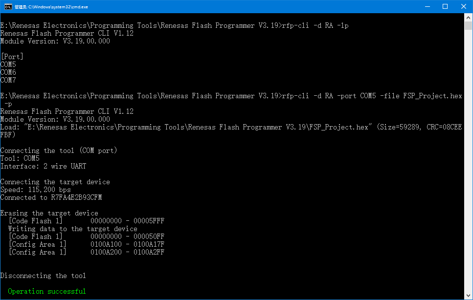

rfp-cli.exe命令行烧录部分
  • MODE CONFIG**MODE配置成sci boot模式
*找到编译后hex文件\FSP_Project\Objects\FSP_Project.hex并copy到Renesas Flash软件安后目录
用type-c usb 连接线连接开发板和电脑在设备管理器找到com口号为com5
在Renesas Flash软件安后目录打开命令窗口每次发送命令前最好按一下复位。运行各命令。
命令rfp-cli -d RA -lp 查看可以用com口
Renesas Flash Programmer CLI V1.12
Module Version: V3.19.00.000
[Port]
COM5
COM6
COM7
命令 rfp-cli -d RA -port COM5 -ls查看可以用速度
Connecting the tool (COM port)
Tool: COM5
Interface: 2 wire UART
Connecting the target device
Disconnecting the tool[Speed]
9600
115200
命令 rfp-cli -d RA -port COM5 -sig查看目标信息
Tool: COM5
Speed: 115,200 bps
Connected to R7FA4E2B93CFM
Signature:
    Device: R7FA4E2B93CFM
    Boot Firmware Version: V7.0.0
    Device Unique ID: 4E4B2D5C5B634B533539393742037771
    Device Code: 05
Memory Info:
    00000000 - 0000FFFF: Code Flash 1 (Block Size: 8 KB)
    00010000 - 0001FFFF: Code Flash 1 (Block Size: 32 KB)
    08000000 - 08000FFF: Data Flash 1 (Block Size: 64)
    0100A100 - 0100A2FF: Config Area 1 (Block Size: 512)
Operation successful
命令rfp-cli -d RA -port COM5 -file FSP_Project.hex -p 烧录
Load: "E:\Renesas Electronics\Programming Tools\Renesas Flash Programmer V3.19\FSP_Project.hex" (Size=42459, CRC=68D14AFE)
Tool: COM5
Speed: 115,200 bps
Erasing the target device
  [Code Flash 1]       00000000 - 00003FFF
Writing data to the target device
  [Code Flash 1]       00000000 - 0000397F
  [Config Area 1]      0100A100 - 0100A17F
  [Config Area 1]      0100A200 - 0100A2FF
