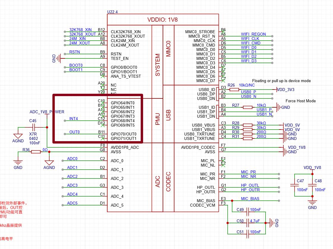

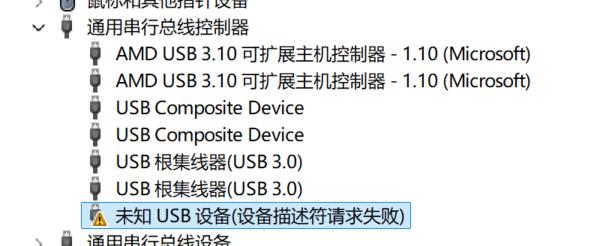

emmc烧录完成后,将BOOT引脚切换到emmc模式,识别不到设备,怎么解决?
软硬件版本信息

U-Boot SPL 2022.10-00008-gd20cb609 (Feb 13 2025 - 20:49:08 -0500)
ddr 1866
00000000: PMU Major Msg: End of CA training
00000000: PMU Major Msg: End of initialization
00000000: PMU Major Msg: End of read enable training
00000000: PMU Major Msg: End of fine write leveling
00000000: PMU Major Msg: End of read dq deskew training
00000000: PMU Major Msg: End of MPR read delay center optimization
00000000: PMU Major Msg: End of Write leveling coarse delay
00000000: PMU Major Msg: End of write delay center optimization
00000000: PMU Major Msg: End of read delay center optimization
00000000: PMU Major Msg: End of max read latency training
00000000: PMU Major Msg: Firmware run has completed
image: uboot load to 1000000 compress =1 src 2aaaacff len=49c48
U-Boot 2022.10-00008-gd20cb609 (Feb 13 2025 - 20:49:08 -0500)
CPU:   rv64imafdcvsu
Model: kendryte k230 canmv dongshanpi 512MiB
DRAM:  1 GiB
Core:  25 devices, 13 uclasses, devicetree: embed
MMC:   mmc0@91580000: 0, mmc1@91581000: 1
Loading Environment from MMC... OK
In:    serial@91400000
Out:   serial@91400000
Err:   serial@91400000
Net:   No ethernet found.
Hit any key to stop autoboot:  0
image: rtt load to 0 compress =1 src 2aaaad07 len=13cc24
Jump to big hart
OpenSBI v1.2.2
heap: [0x0043dc40 - 0x0443dc40], size 65536 KB
page: [0x0443dc48 - 0x1fffec00], size 454403 KB
lwIP-2.1.2 initialized!

        你好,这个是因为你的硬件没有接INT0或者INT4,然后代码里使用了硬件rtc,执行make rtsmart-menuconfig去关掉RTC_PMU驱动,
检查你的板子这部分的原理图。

根据您提供的信息(U-Boot SPL启动日志片段及无法从eMMC启动的问题),这是一个典型的启动流程卡在SPL阶段的故障。以下是详细分析和解决步骤:
核心问题分析:
  1. SPL成功执行但未加载主U-Boot: 日志显示SPL(2022.10版本)已初始化成功,包括DDR内存(ddr 1866...)和PMU相关操作(End of CA training, End of initialization)。这说明硬件初始化(CPU、DDR、PMU)基本通过。卡点在于SPL未能成功从eMMC加载主U-Boot程序
  2. “识别不到设备”: 这里的“设备”指的是主U-Boot以及后续的内核等。系统无法启动,根本原因是主U-Boot没有被加载执行。

解决步骤总结 (按照优先级):
  1. 强制串口输出: 连接串口调试终端,捕获完整的启动日志,尤其注意SPL加载eMMC和尝试加载主U-Boot时的任何错误信息。这将是最直接的线索?。
  2. 三重确认BOOT引脚: 对照硬件手册或原理图,手动确认每个BOOT引脚的电压状态(用万用表测量)是否符合eMMC启动的要求。检查跳线帽、开关或电阻设置。
