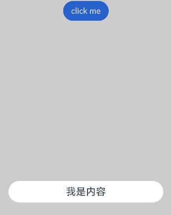

KaihongOS框架提供了弹窗的API接口,开发者可直接使用,详情请参考@ohos.promptAction (弹窗)。但在开发过程中当提供的弹窗接口无法满足需求时,则需要自定义弹窗。
创建自定义弹窗
  • 使用@CustomDialog装饰器装饰自定义弹窗。
  • @CustomDialog装饰器用于装饰自定义弹框,此装饰器内进行自定义内容(也就是弹框内容)。
    @CustomDialogstruct CustomDialogExample {  controller: CustomDialogController = new CustomDialogController({    builder: CustomDialogExample({}),  })  build() {    Column() {      Text('我是内容')        .fontSize(20)        .margin({ top: 10, bottom: 10 })    }  }}
  • 创建构造器,与装饰器呼应相连。
    @Entry @Component struct CustomDialogUser {   dialogController: CustomDialogController = new CustomDialogController({     builder: CustomDialogExample(),   }) }
  • 点击与onClick事件绑定的组件使弹窗弹出。
    @Entry@Componentstruct CustomDialogUser {  dialogController: CustomDialogController = new CustomDialogController({    builder: CustomDialogExample(),  })  build() {    Column() {      Button('click me')        .onClick(() => {          this.dialogController.open()        })    }.width('100%').margin({ top: 5 })  }}

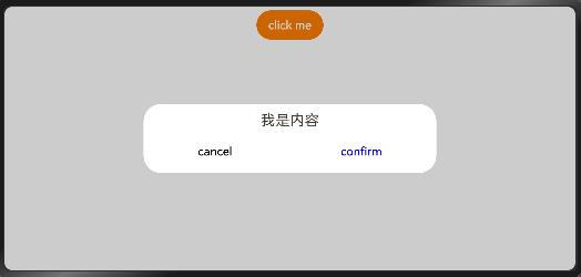

完整示例
@CustomDialogstruct CustomDialogExample {  cancel?: () => void  confirm?: () => void  controller: CustomDialogController  build() {    Column() {      Text('我是内容').fontSize(20).margin({ top: 10, bottom: 10 })      Flex({ justifyContent: FlexAlign.SpaceAround }) {        Button('cancel')          .onClick(() => {            this.controller.close()            if (this.cancel) {              this.cancel()            }          }).backgroundColor(0xffffff).fontColor(Color.Black)        Button('confirm')          .onClick(() => {            this.controller.close()            if (this.confirm) {              this.confirm()            }          }).backgroundColor(0xffffff).fontColor(Color.Red)      }.margin({ bottom: 10 })    }  }}@Entry@Componentstruct CustomDialogUser {  dialogController: CustomDialogController = new CustomDialogController({    builder: CustomDialogExample({      cancel: ()=> { this.onCancel() },      confirm: ()=> { this.onAccept() },    }),  })  onCancel() {    console.info('Callback when the first button is clicked')  }  onAccept() {    console.info('Callback when the second button is clicked')  }  build() {    Column() {      Button('click me')        .onClick(() => {          this.dialogController.open()        })    }.width('100%').margin({ top: 5 })  }}
