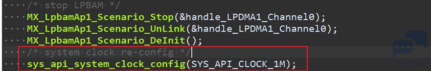

STM32U5退出LPBAM后,重新配置时钟发现MSIK时钟和配置不一致是怎么回事?
  您好,我在LPBAM停止函数后调用时钟重新初始化函数(此函数和CUBEMX生成的SystemClock_Config()函数一致,仅仅只是重新写了一遍而已),通过串口输出MSIS和MSIK的寄存器值(通过调用HAL_RCC_GET_MSI_RANGE()和HAL_RCC_GET_MSIK_RANGE()宏),发现在时钟重新初始化函数执行完后,仅MSIS寄存器值正确(1MHz),MSIK寄存器值为0(对应是48MHz),导致部分使用MSIK时钟的外设运行异常!
  • @brief  系统时钟配置(MSIS和MSIK)
  • @param  clockFlag         : 系统时钟配置标志 @ref sys_api_clock_flag
  • @arg  SYS_API_CLOCK_1M  : 1MHz
  • @arg  SYS_API_CLOCK_2M  : 2MHz
  • @arg  SYS_API_CLOCK_4M  : 4MHz
  • @arg  SYS_API_CLOCK_12M : 12MHz
  • @arg  SYS_API_CLOCK_16M : 16MHz
  • @arg  SYS_API_CLOCK_24M : 24MHz
  • @retval None
void sys_api_system_clock_config(uint8_t clockFlag)
uint32_t clockRange;
RCC_OscInitTypeDef RCC_OscInitStruct = {0};
RCC_ClkInitTypeDef RCC_ClkInitStruct = {0};
switch(clockFlag)
case SYS_API_CLOCK_1M:    clockRange = RCC_MSIRANGE_7;    break;case SYS_API_CLOCK_2M:    clockRange = RCC_MSIRANGE_5;    break;case SYS_API_CLOCK_4M:    clockRange = RCC_MSIRANGE_4;    break;case SYS_API_CLOCK_12M:    clockRange = RCC_MSIRANGE_3;    break;case SYS_API_CLOCK_16M:    clockRange = RCC_MSIRANGE_2;    break;case SYS_API_CLOCK_24M:    clockRange = RCC_MSIRANGE_1;    break;default:    clockRange = RCC_MSIRANGE_7;    break;}
/** Configure the main internal regulator output voltage
if(HAL_PWREx_ControlVoltageScaling(PWR_REGULATOR_VOLTAGE_SCALE4) != HAL_OK)
Error_Handler();}
/** Initializes the CPU, AHB and APB buses clocks
RCC_OscInitStruct.OscillatorType = RCC_OSCILLATORTYPE_LSI|RCC_OSCILLATORTYPE_MSI|RCC_OSCILLATORTYPE_MSIK;
RCC_OscInitStruct.LSIState = RCC_LSI_ON;
RCC_OscInitStruct.MSIState = RCC_MSI_ON;
RCC_OscInitStruct.MSICalibrationValue = RCC_MSICALIBRATION_DEFAULT;
RCC_OscInitStruct.MSIClockRange = clockRange;
RCC_OscInitStruct.LSIDiv = RCC_LSI_DIV1;
RCC_OscInitStruct.MSIKClockRange = clockRange;
RCC_OscInitStruct.MSIKState = RCC_MSIK_ON;
RCC_OscInitStruct.PLL.PLLState = RCC_PLL_NONE;
if(HAL_RCC_OscConfig(&RCC_OscInitStruct) != HAL_OK)
Error_Handler();}
RCC_ClkInitStruct.ClockType = RCC_CLOCKTYPE_HCLK|RCC_CLOCKTYPE_SYSCLK|RCC_CLOCKTYPE_PCLK1|RCC_CLOCKTYPE_PCLK2|RCC_CLOCKTYPE_PCLK3;
RCC_ClkInitStruct.SYSCLKSource = RCC_SYSCLKSOURCE_MSI;
RCC_ClkInitStruct.AHBCLKDivider = RCC_SYSCLK_DIV1;
RCC_ClkInitStruct.APB1CLKDivider = RCC_HCLK_DIV1;
RCC_ClkInitStruct.APB2CLKDivider = RCC_HCLK_DIV1;
RCC_ClkInitStruct.APB3CLKDivider = RCC_HCLK_DIV1;
if(HAL_RCC_ClockConfig(&RCC_ClkInitStruct, FLASH_LATENCY_0) != HAL_OK)
Error_Handler();}
sys_api_clock_get();}

徐非姗
2025-3-7 14:41:20
是RCC_MSIRANGE_1和RCC_MSIKRANGE_1弄错了,两个的宏定义不是一个
