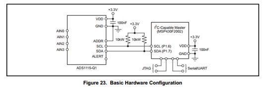

ADS1115是超小型的,宽电压16位AD转换器,通过一个I2c接口与MCU相连,官方给的电路连接图如下
驱动程序如下
#include#include "ads1115.h"void delay(){  uint i;  for(i=0;i<20000;i++);}void wait(){  uchar i=3;  while(i--);  _NOP();}void start(){  S_SDA;                  //数据线拉高  wait();  S_SCL;                  //时钟为高  wait();  C_SDA;                  //数据线拉低,表起始信号  wait();  C_SCL;                  //时钟为低,允许数据改变  wait();}void stop(){  C_SCL;  wait();  C_SDA;  wait();  S_SCL;  wait();  S_SDA;                  //在SCL为高器期间,数据线上升,表停止}void ack()            //应答{  C_SDA;  wait();  S_SCL;  wait();  C_SCL;  wait();  S_SDA;}uchar check_ack(){  uchar ack;  S_SDA;  wait();  S_SCL;  wait();  ack=SDA & 0x80;  C_SCL;  _NOP();  if(ack) return 1;          //无应答  else    return 0;          //有应答}void write_byte(uchar byte){  uchar i;  C_SCL;  for(i=0;i<8;i++)  {    if(byte & 0x80) S_SDA;    else            C_SDA;   //送数据    wait();    S_SCL;                   //拉高控制线    wait();    C_SCL;                  //拉低时钟线,允许数据改变    byte <<= 1;             //准备下一位  }}uchar read_byte(void){  uchar byte=0,i;  P1DIR &= ~BIT7;  wait();  for(i=0;i<8;i++)  {    S_SCL;    wait();    byte <<= 1;    if(SDA & 0X80) byte |= 0x01;    C_SCL;    wait();  }  return byte;}void write_word(uchar addr,uint word){  uchar byte=0x90;           //0b10010000  start();  write_byte(byte);          //写地址  byte = check_ack();  write_byte(addr);          //指定寄存器  byte = check_ack();  write_byte(word>>8);     //写高字节  byte = check_ack();  write_byte(word);        //写低字节  byte = check_ack();  stop();}uint read_word(uchar addr){  uint  word;  uchar byte=0x90;            //0b10010000  start();  write_byte(byte);           //写地址  byte = check_ack();  write_byte(addr);           //指定寄存器  byte = check_ack();  stop();  wait();  start();  byte=0x91;                  //0b10010001  write_byte(byte);           //写地址,操作为读  byte = check_ack();  word = read_byte();         //读高字节  ack();  word <<= 8;  byte = read_byte();         //读低字节  ack();  word += byte;    stop();  return word;}void main(void){  uint value;  uint tmp;  float u;  WDTCTL=WDTPW+WDTHOLD;  P1DIR |= BIT1;  P1OUT &= ~BIT7;  stop();  while(1)  {    write_word(0x01,0xc383);        //0b1100 0011 1000 0011    delay();    value = read_word(0x00);        //读取值    tmp = value & 0x7fff;    u = 4.096 * tmp / 32768;    if(value>0x7fff) u = 0.0;    u *= 1000;  }}

点赞;ADS1115的时序要求比较严格,针对不同的MCU移植时需要注意时间

看起来您正在讨论如何使用ADS1115与MSP430微控制器。ADS1115是一个16位的模数转换器(ADC),它可以通过I2C接口与MSP430微控制器进行通信。以下是一些关键步骤和代码示例,以帮助您实现这一功能。
1. 硬件连接:
   - 将ADS1115的VDD引脚连接到MSP430的3.3V电源。
   - 将ADS1115的GND引脚连接到MSP430的地线。
   - 将ADS1115的SCL引脚连接到MSP430的SCL引脚(P1.6)。
   - 将ADS1115的SDA引脚连接到MSP430的SDA引脚(P1.7)。
2. 初始化I2C接口:
   - 在MSP430中,您需要配置I2C接口以与ADS1115通信。这通常涉及到设置时钟速率和启用I2C模块。
3. 编写驱动程序:
   - 您已经提供了部分驱动程序代码。以下是一些关键函数的解释:
   - `delay()`:这个函数用于创建一个简单的延迟。
   - `wait()`:这个函数用于等待I2C时钟稳定。
   - `start()`:这个函数用于生成I2C起始条件。
4. 读取ADC值:
   - 要读取ADS1115的ADC值,您需要发送一个I2C地址和寄存器地址,然后读取返回的数据。
以下是一个简单的代码示例,用于读取ADS1115的ADC值:
