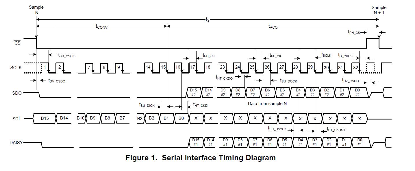

焊接ADS8684的时候9引脚VCC5没焊上,30引脚VCC5焊接上了,会影响芯片的供电吗?
  • 目前在做AD采样,用STM32F407操作ADS8684芯片。
    按照ADS8684的时序图我配置了STM32,使用SPI2,PB12为SPI2_CS,PB13为SPI2_SCK,PC2为SIP2_MISO,PC2为SIP2_MOSI。
    (焊接ADS8684的时候9引脚VCC5没焊上,30引脚VCC5焊接上了,会影响芯片的供电吗)
    //以下是SPI模块的初始化代码,配置成主机模式                          //SPI口初始化//这里针是对SPI1的初始化void SPI2_Init(void){      GPIO_InitTypeDef  GPIO_InitStructure;  SPI_InitTypeDef  SPI_InitStructure;       RCC_AHB1PeriphClockCmd(RCC_AHB1Periph_GPIOB, ENABLE);//使能GPIOB时钟  RCC_AHB1PeriphClockCmd(RCC_AHB1Periph_GPIOC, ENABLE);//使能GPIOC时钟       RCC_APB1PeriphClockCmd(RCC_APB1Periph_SPI2, ENABLE);//使能SPI1时钟    //GPIOB12  GPIO_InitStructure.GPIO_Pin = GPIO_Pin_12;//PB12  GPIO_InitStructure.GPIO_Mode = GPIO_Mode_OUT;//输出  GPIO_InitStructure.GPIO_OType = GPIO_OType_PP;//推挽输出  GPIO_InitStructure.GPIO_Speed = GPIO_Speed_100MHz;//100MHz  GPIO_InitStructure.GPIO_PuPd = GPIO_PuPd_UP;//上拉  GPIO_Init(GPIOB, &GPIO_InitStructure);//初始化  //GPIOFB13初始化设置  GPIO_InitStructure.GPIO_Pin = GPIO_Pin_13;//PB13复用功能输出      GPIO_InitStructure.GPIO_Mode = GPIO_Mode_AF;//复用功能  GPIO_InitStructure.GPIO_OType = GPIO_OType_PP;//推挽输出  GPIO_InitStructure.GPIO_Speed = GPIO_Speed_100MHz;//100MHz  GPIO_InitStructure.GPIO_PuPd = GPIO_PuPd_UP;//上拉  GPIO_Init(GPIOB, &GPIO_InitStructure);//初始化  //GPIOFC2,3初始化设置  GPIO_InitStructure.GPIO_Pin = GPIO_Pin_2 | GPIO_Pin_3;//PC2 PC3复用功能输出   GPIO_InitStructure.GPIO_Mode = GPIO_Mode_AF;//复用功能  GPIO_InitStructure.GPIO_OType = GPIO_OType_PP;//推挽输出  GPIO_InitStructure.GPIO_Speed = GPIO_Speed_100MHz;//100MHz  GPIO_InitStructure.GPIO_PuPd = GPIO_PuPd_UP;//上拉  GPIO_Init(GPIOC, &GPIO_InitStructure);//初始化   PBout(12)=1;     GPIO_PinAFConfig(GPIOB,GPIO_PinSource13,GPIO_AF_SPI2); //PB3复用为 SPI1    GPIO_PinAFConfig(GPIOC,GPIO_PinSource2, GPIO_AF_SPI2); //PB3复用为 SPI1    GPIO_PinAFConfig(GPIOC,GPIO_PinSource3, GPIO_AF_SPI2); //PB3复用为 SPI1    //这里只针对SPI口初始化    RCC_APB1PeriphResetCmd(RCC_APB1Periph_SPI2,ENABLE);//复位SPI2    RCC_APB1PeriphResetCmd(RCC_APB1Periph_SPI2,DISABLE);//停止复位SPI2     SPI_InitStructure.SPI_Direction = SPI_Direction_2Lines_FullDuplex;  //设置SPI单向或者双向的数据模式:SPI设置为双线双向全双工    SPI_InitStructure.SPI_Mode = SPI_Mode_Master;       //设置SPI工作模式:设置为主SPI    SPI_InitStructure.SPI_DataSize = SPI_DataSize_16b;      //设置SPI的数据大小:SPI发送接收16位帧结构    SPI_InitStructure.SPI_CPOL = SPI_CPOL_High;     //串行同步时钟的空闲状态为高电平    SPI_InitStructure.SPI_CPHA = SPI_CPHA_2Edge;    //串行同步时钟的第二个跳变沿(上升或下降)数据被采样    SPI_InitStructure.SPI_NSS = SPI_NSS_Soft;       //NSS信号由硬件(NSS管脚)还是软件(使用SSI位)管理:内部NSS信号有SSI位控制    SPI_InitStructure.SPI_BaudRatePrescaler = SPI_BaudRatePrescaler_256;        //定义波特率预分频的值:波特率预分频值为256    SPI_InitStructure.SPI_FirstBit = SPI_FirstBit_MSB;  //指定数据传输从MSB位还是LSB位开始:数据传输从MSB位开始    SPI_InitStructure.SPI_CRCPolynomial = 7;    //CRC值计算的多项式    SPI_Init(SPI2, &SPI_InitStructure);  //根据SPI_InitStruct中指定的参数初始化外设SPIx寄存器      SPI_Cmd(SPI2, ENABLE); //使能SPI外设     SPI2_ReadWriteByte(0xff);//启动传输      }
    SPI通信没有正常工作,请问是中间哪里没有配置对吗?

   焊接ADS8684的时候9引脚VCC5没焊上,30引脚VCC5焊接上了,建议不这样搞, 不过不大会影响芯片的供电
SPI通信没有正常工作,  先看看和描述一下通信的波形吧

根据您提供的信息,ADS8684的9引脚和30引脚都是VCC5,这两个引脚是供电引脚。理论上,只要有一个VCC5引脚正确焊接并供电,芯片应该可以正常工作。但是,如果两个VCC5引脚都正确焊接并供电,可以提供更稳定的电源。
在您的情况下,9引脚VCC5没有焊接,而30引脚VCC5焊接上了。这可能会影响芯片的供电稳定性,但不一定会导致芯片无法工作。您可以尝试进行AD采样,看看是否能够正常工作。
