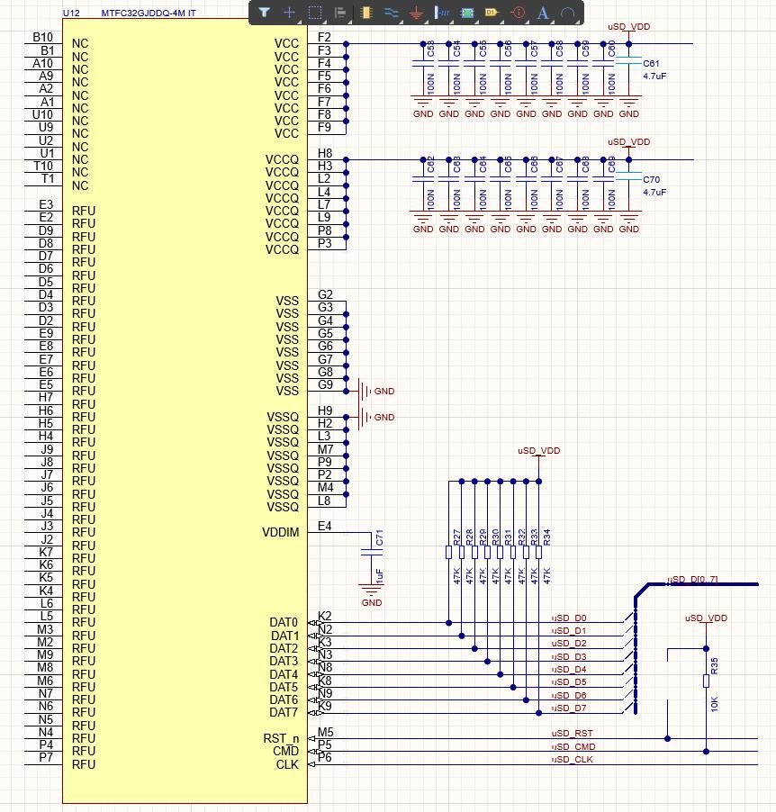

ESP32S3无法挂载EMMC芯片怎么处理?
硬件:ESP32-S3-DevKitC-1
环境:ubuntu+vscode
IDF版本:v4.4
问题描述:
我想使用一个8线的mmc芯片作为外部存储,但是当我稍微修改例程后,发现无法挂载文件系统

使用以上代码后串口打印的信息是:Code: [Select all] [Expand/Collapse]
  • I (0) cpu_start: App cpu up.
  • I (222) cpu_start: Pro cpu start user code
  • I (222) cpu_start: cpu freq: 160000000
  • I (222) cpu_start: Application information:
  • I (225) cpu_start: Project name:     main
  • I (230) cpu_start: App version:      3577b0a-dirty
  • I (235) cpu_start: Compile time:     Nov 24 2021 13:39:56
  • I (241) cpu_start: ELF file SHA256:  1ac03af898982e4b...
  • I (247) cpu_start: ESP-IDF:          v4.4-dev-3235-g3e370c4296-dirty
  • I (254) heap_init: Initializing. RAM available for dynamic allocation:
  • I (262) heap_init: At 3FC94B58 len 0004B4A8 (301 KiB): D/IRAM
  • I (268) heap_init: At 3FCE0000 len 0000EE34 (59 KiB): STACK/DRAM
  • I (275) heap_init: At 3FCF0000 len 00008000 (32 KiB): DRAM
  • I (281) spiram: Adding pool of 2048K of external SPI memory to heap allocator
  • I (289) spi_flash: detected chip: generic
  • I (293) spi_flash: flash io: dio
  • I (298) cpu_start: Starting scheduler on PRO CPU.
  • I (0) cpu_start: Starting scheduler on APP CPU.
  • I (328) spiram: Reserving pool of 64K of internal memory for DMA/internal allocations
  • I (328) SD_EMMC: Initializing SD card
  • I (338) SD_EMMC: Using SDMMC peripheral
  • I (338) SD_EMMC: Mounting filesystem
  • I (348) gpio: GPIO[17]| InputEn: 0| OutputEn: 0| OpenDrain: 0| Pullup: 1| Pulldown: 0| Intr:0
  • I (358) gpio: GPIO[8]| InputEn: 0| OutputEn: 0| OpenDrain: 0| Pullup: 1| Pulldown: 0| Intr:0
  • I (368) gpio: GPIO[14]| InputEn: 0| OutputEn: 0| OpenDrain: 0| Pullup: 1| Pulldown: 0| Intr:0
  • I (368) gpio: GPIO[13]| InputEn: 0| OutputEn: 0| OpenDrain: 0| Pullup: 1| Pulldown: 0| Intr:0
  • I (378) gpio: GPIO[12]| InputEn: 0| OutputEn: 0| OpenDrain: 0| Pullup: 1| Pulldown: 0| Intr:0
  • I (388) gpio: GPIO[11]| InputEn: 0| OutputEn: 1| OpenDrain: 0| Pullup: 0| Pulldown: 0| Intr:0
  • I (398) gpio: GPIO[10]| InputEn: 0| OutputEn: 0| OpenDrain: 0| Pullup: 1| Pulldown: 0| Intr:0
  • I (408) gpio: GPIO[9]| InputEn: 0| OutputEn: 0| OpenDrain: 0| Pullup: 1| Pulldown: 0| Intr:0
  • I (418) gpio: GPIO[46]| InputEn: 0| OutputEn: 0| OpenDrain: 0| Pullup: 1| Pulldown: 0| Intr:0
  • I (428) gpio: GPIO[3]| InputEn: 0| OutputEn: 0| OpenDrain: 0| Pullup: 1| Pulldown: 0| Intr:0
  • I (498) gpio: GPIO[11]| InputEn: 0| OutputEn: 0| OpenDrain: 0| Pullup: 1| Pulldown: 0| Intr:0
  • E (498) sdmmc_cmd: sdmmc_read_sectors_dma: sdmmc_send_cmd returned 0x109
  • E (508) diskio_sdmmc: sdmmc_read_blocks failed (265)
  • W (508) vfs_fat_sdmmc: failed to mount card (1)
  • E (518) vfs_fat_sdmmc: mount_to_vfs failed (0xffffffff).
  • E (518) SD_EMMC: Failed to mount filesystem. If you want the card to be formatted, set the EXAMPLE_FORMAT_IF_MOUNT_FAILED menuconfig option.
