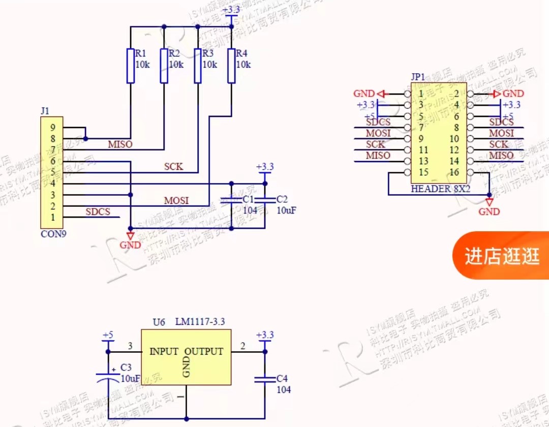

为什么ESP32-WROVER-IE写入数据到SD卡中时无法初始化呢?

E (748) vfs_fat_sdmmc: slot init failed (0x103).
E (749) sd.h: Failed to initialize the card (ESP_ERR_INVALID_STATE).   If you do not have an SD card attached, please ignore this message.  Make sure SD card lines have pull-up resistors in place.

代码如下:

#define PIN_NUM_MISO 2
#define PIN_NUM_MOSI 15
#define PIN_NUM_CLK  14
#define PIN_NUM_CS   13

void sd_init() {
#ifdef CONFIG_SEND_CSI_TO_SD
    sdmmc_host_t host = SDSPI_HOST_DEFAULT();
    sdspi_slot_config_t slot_config = SDSPI_SLOT_CONFIG_DEFAULT();
    slot_config.gpio_miso = (gpio_num_t) PIN_NUM_MISO;
    slot_config.gpio_mosi = (gpio_num_t) PIN_NUM_MOSI;
    slot_config.gpio_sck = (gpio_num_t) PIN_NUM_CLK;
    slot_config.gpio_cs = (gpio_num_t) PIN_NUM_CS;
    esp_vfs_fat_sdmmc_mount_config_t mount_config = {
            .format_if_mount_failed = false,
            .max_files = 1,
            .allocation_unit_size = 16 * 1024
    sdmmc_card_t *card;
    esp_err_t ret = esp_vfs_fat_sdmmc_mount("/sdcard", &host, &slot_config, &mount_config, &card);

SD卡模块如下图,SD卡:Sandisk SDHC 32G
