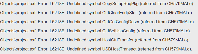

ch579同时用以太网和U盘功能,编译一直报错怎么解决?
ch579同时用以太网和U盘功能,编译一直报错,单独用其中一个就可以,是内存不够吗
compiling CH57x_uart2.c...
compiling CH57x_uart3.c...
linking...
.Objectsproject.axf: Error: L6218E: Undefined symbol CopySetupReqPkg (referred from CH579MAI.o).
.Objectsproject.axf: Error: L6218E: Undefined symbol CtrlClearEndpStall (referred from CH579MAI.o).
.Objectsproject.axf: Error: L6218E: Undefined symbol CtrlGetConfigDescr (referred from CH579MAI.o).
.Objectsproject.axf: Error: L6218E: Undefined symbol CtrlSetUsbConfig (referred from CH579MAI.o).
.Objectsproject.axf: Error: L6218E: Undefined symbol HostCtrlTransfer (referred from CH579MAI.o).
.Objectsproject.axf: Error: L6218E: Undefined symbol USBHostTransact (referred from CH579MAI.o).
Not enough information to list image symbols.
Finished: 1 information, 0 warning and 6 error messages.
".Objectsproject.axf" - 6 Error(s), 6 Warning(s).
Target not created.
Build Time Elapsed:  00:00:04

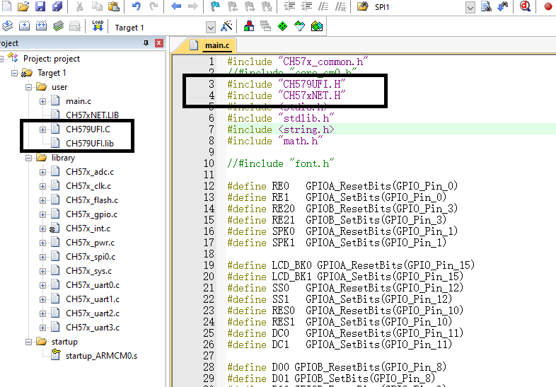

  是在一个正常使用的带以太网的程序上改的,只加上U盘支持的3个文件。还没写功能就编译不下去了
  去掉3个文件,编译通过

王希予
2022-9-28 10:12:16
这个是调用了未声明的函数,
工程需要包含上述C文件
