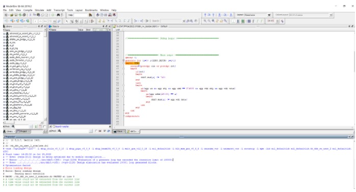

虽然generate for生成的代码是可综合的,但个人更多的在testbench中使用,那么在使用的过程中笔者就发现这个for循环的循环层数是有限制的,最大不能超过100000,如果超过了至少modelsim就会报错,error信息如下。所以我上面的代码中parameter定义成了65536。
# do {tb_ddr_rw_user_2_simulate.do}
# vsim -voptargs=""+acc"" -L xbip_utils_v3_0_10 -L xbip_pipe_v3_0_6 -L xbip_bram18k_v3_0_6 -L mult_gen_v12_0_16 -L xil_defaultlib -L blk_mem_gen_v8_4_4 -L unisims_ver -L unimacro_ver -L secureip -L xpm -lib xil_defaultlib xil_defaultlib.tb_ddr_rw_user_2 xil_defaultlib.glbl
# Start time: 14:25:32 on Jul 28,2022
# ** Note: (vsim-3813) Design is being optimized due to module recompilation...
# ** Error: ../../../../../../src/ddr3.v(45): (vopt-2134) Evaluation of a generate loop has exceeded the iteration limit of 100000.
# ** Note: ../../../../../../src/ddr3.v(45): (vopt-2129) Design elaboration has evaluated 100001 loop generated blocks.
# Optimization failed
# Error loading design
# Error: Error loading design
#        Pausing macro execution
# MACRO ./tb_ddr_rw_user_2_simulate.do PAUSED at line 9
