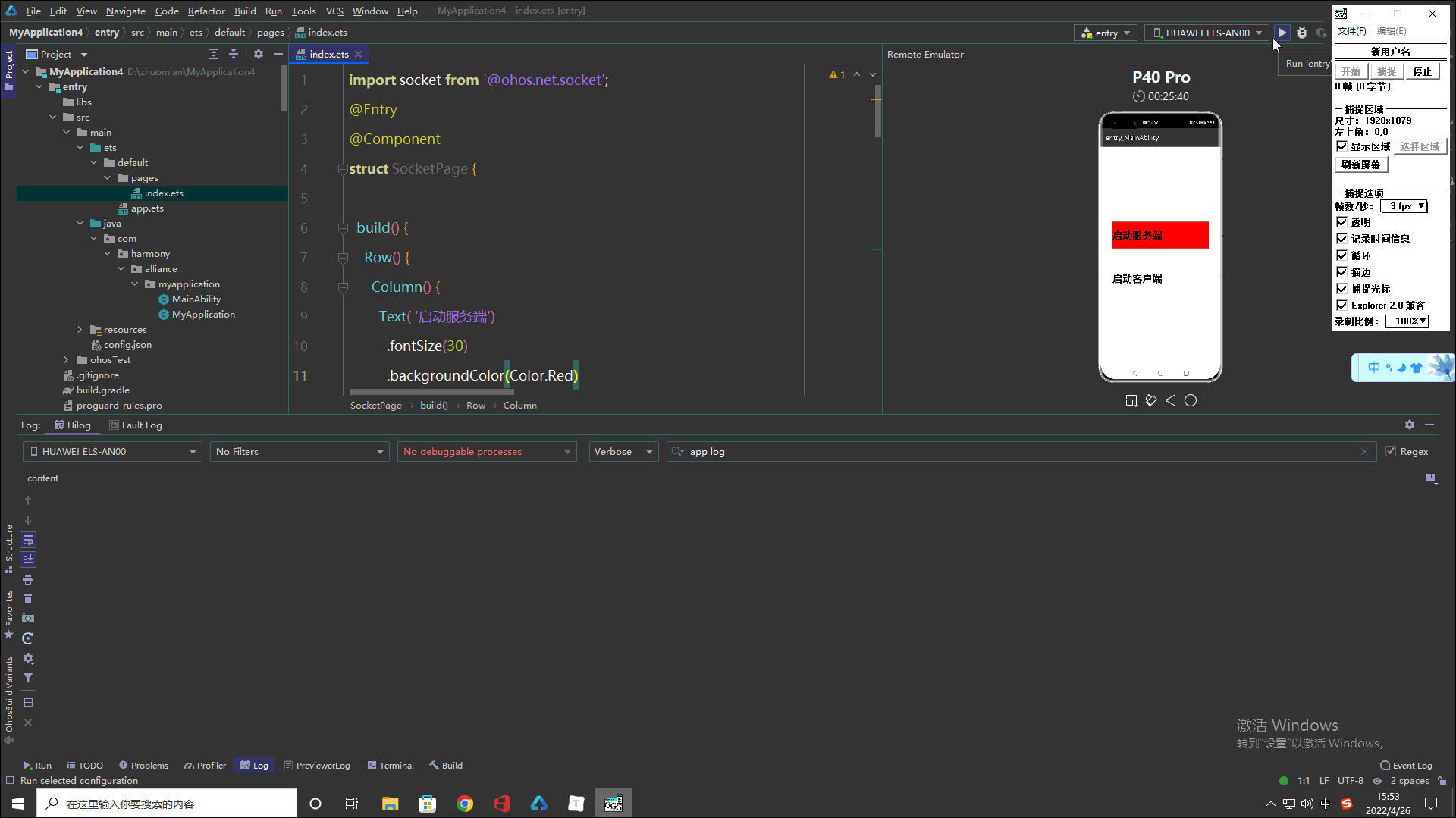

HarmonyOS Socket连接的使用方法分享
代码实现
import socket from '@ohos.net.socket';
@Entry
@Component
struct SocketPage {
  build() {
    Row() {
      Column() {
        Text( '启动服务端')
          .fontSize(30)
          .backgroundColor(Color.Red)
          .width('80%')
          .height(80)
          .fontWeight(FontWeight.Bold)
          .onClick(() => {
            let udp = socket.constructUDPSocketinstance();
            udp.bind({ address: 'localhost', port: 8088 }, err =>{
              if (err){
                console.log('server bind fail:' + JSON.stringify(err));
              console.log('server bind success');
            udp.on("message", value =>{
              console.log("server message:" + value.message + ", remoteInfo:" + JSON.stringify(value.remoteInfo));
        Text( '启动客户端')
          .fontSize(30)
          .width('80%')
          .height(80)
          .margin({top : 50})
          .onClick(() => {
            let udp = socket.constructUDPSocketInstance();
            //TODO 如果bind 则send fail:{"code":22},反之send fail:{"code":88}
            udp.bind({address:'localhost'})
            let send = udp.send({
              data: 'Hello, server!',
              address: {
                port : 8088
            send.then(() => {
              console.log('client send success');
            }).catch(err => {
              console.log('client send fail:' + JSON.stringify(err));
              console.log("client message:" + value.message + ", remoteInfo:" + JSON.stringify(value.remoteInfo));
      .width('100%')
    .height('100%')
运行效果
