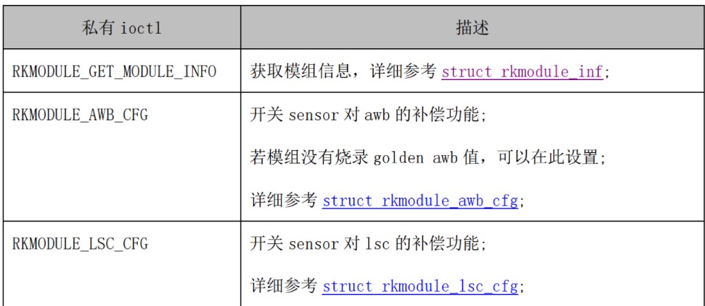

ioctl
//called at the end of ioctl() syscall handler at the V4L2 core. used to provide support for private ioctls used on the driver.
static long gc8034_ioctl(struct v4l2_subdev *sd, unsigned int cmd, void *arg)

目前使用了如下的私有 ioctl 实现模组信息的查询和 OTP 信息的查询设置。
