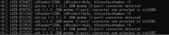

1.3 验证是否修改成功
编译并烧录完成后,插入4G模块通过查询命令:ls /dev/ttyU*,应有 ttyUSB0、ttyUSB1、ttyUSB2 三个端口,如 下图:
或者加载模块时的内核日志,如下图:

1.3 验证是否修改成功
或者加载模块时的内核日志,如下图:

+++ b/drivers/u***/serial/option.c
@@ -425,6 +425,10 @@ static void option_instat_callback(struct urb *urb);
#define YUGA_PRODUCT_CLM920_NC5_GPS 0x9125
//end
+// add for M5700
+#define Longsung_VENDOR_M5700 0x1782
+#define Longsung_PRODUCT_M5700 0x4d10
+// end
#define YUGA_VENDOR_ID 0x257A
#define YUGA_PRODUCT_CEM600 0x1601
@@ -480,6 +484,8 @@ static void option_instat_callback(struct urb *urb);
#define YUGA_PRODUCT_CLU528 0x360D
#define YUGA_PRODUCT_CLU526 0x360F
/* Viettel products */
#define VIETTEL_VENDOR_ID 0x2262
#define VIETTEL_PRODUCT_VT1000 0x0002
@@ -645,6 +651,7 @@ static const struct option_blacklist_info YUGA_9X07_blacklist = {
// add end
static const struct u***_device_id option_ids[] = {
//add by ZHQ 2017-11-23 for Quectel EC20
//{ USB_DEVICE(QUECTEL_VENDOR_ID, QUECTEL_PRODUCT_ID) },
@@ -1846,6 +1853,7 @@ static const struct u***_device_id option_ids[] = {
.driver_info = (kernel_ulong_t)&YUGA_9X07_GPS_blacklist },
{ USB_DEVICE(YUGA_VENDOR_AC3, YUGA_PRODUCT_AC3),
.driver_info = (kernel_ulong_t)&YUGA_VENDOR_AC3_blacklist },
+ { USB_DEVICE(Longsung_VENDOR_M5700, Longsung_PRODUCT_M5700)},
{ USB_DEVICE(CLM920_VENDOR_ID, YUGE_PRODUCT_CLM920_EC5) },
{ USB_DEVICE(CLM920_VENDOR_ID, YUGE_PRODUCT_CLM920_NC5_2) },
/* add end */
