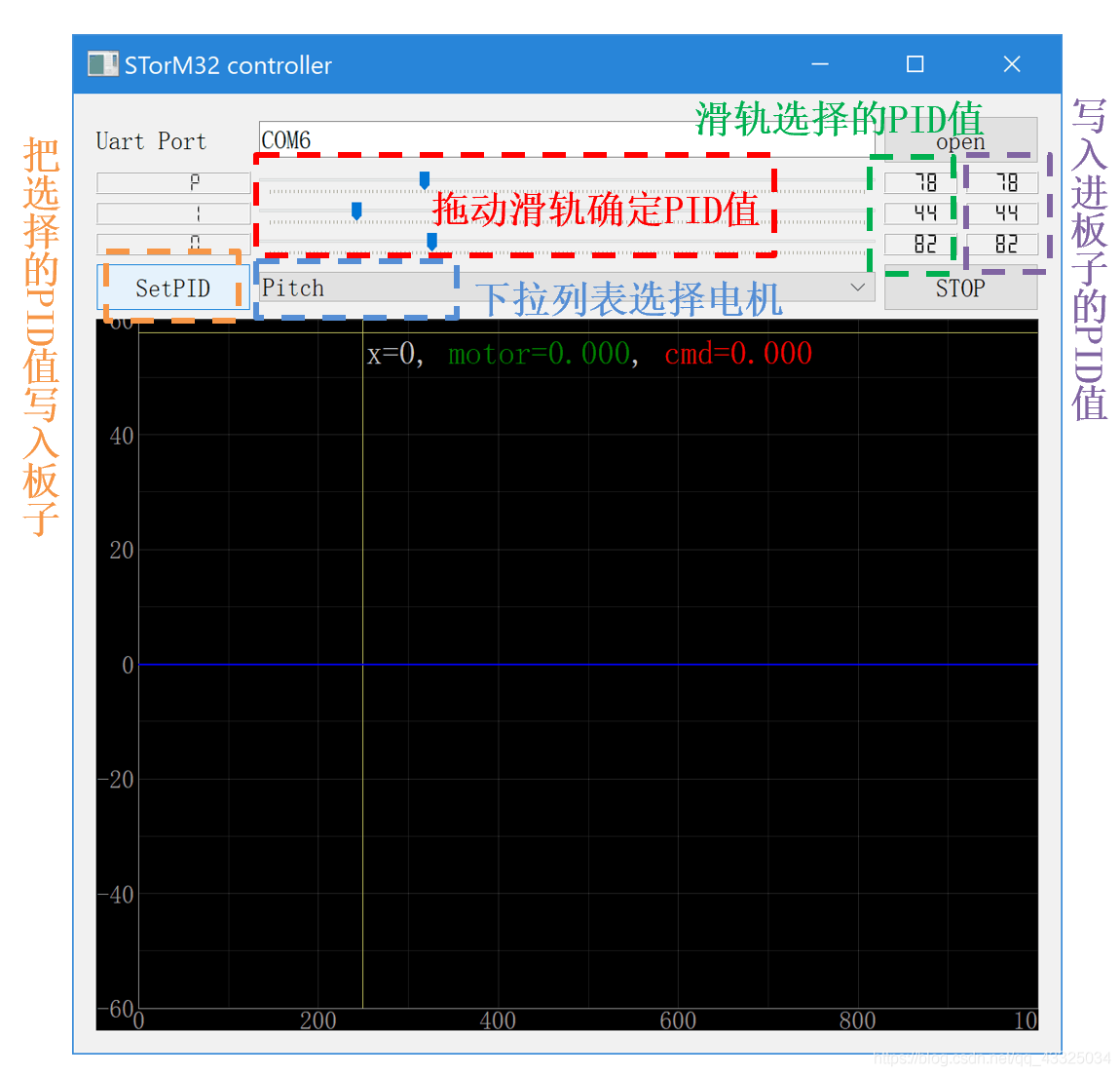

每改一次pid都要重新烧太麻烦了,能在线调多美好啊
这是设计好的gui,核心部分是上面的滑轨以及右边显示的两列lcd,左边一列lcd是实时lcd,反应滑轨;右边一列lcd是lcd_saved,显示storm开发板中pid的参数。

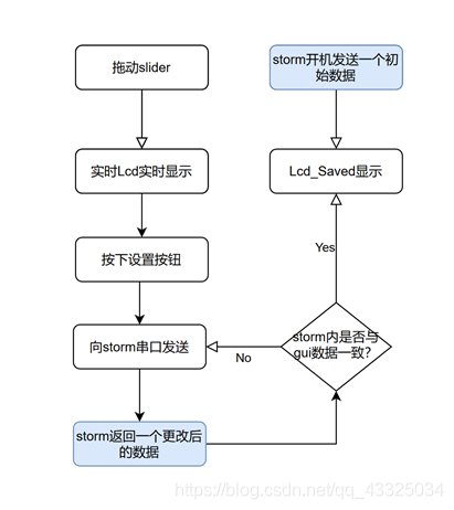

大概的交互逻辑大致如下:

class GuiController(QWidget):
    def initUI(self):
##################参数P调整#########################
        self.PLcd_text = QLCDNumber(self)
        self.PLcd_text.setSegmentStyle(QLCDNumber.Filled)
        self.PLcd_text.display('P')#固定显示“P”这个字符
        self.PSlider = QSlider(Qt.Horizontal, self)
        self.PSlider.setFocusPolicy(Qt.NoFocus)
        self.PSlider.setMinimum(0)#设置滑轨最小值以及最大值
        self.PSlider.setMaximum(300)
        self.PSlider.setSingleStep(2)#滑轨的调整间隔
        self.PSlider.setTickPosition(QSlider.TicksBelow)
        self.PSlider.valueChanged.connect(self.PChange_temp)#与一个函数PChange_temp连接,在滑轨值变化时调用这个函数
        self.PLcd = QLCDNumber(self) #设置一个lcd,PChange_temp的改变反应到这上面来
        self.PLcd.setSegmentStyle(QLCDNumber.Flat)
        self.PLcd.setSmallDecimalPoint(True)
        self.PLcd.setDigitCount(3)
##################参数I调整#########################
        self.ILcd_text = QLCDNumber(self)
        self.ILcd_text.setSegmentStyle(QLCDNumber.Filled)
        self.ILcd_text.display(1)
        self.ISlider = QSlider(Qt.Horizontal, self)
        self.ISlider.setFocusPolicy(Qt.NoFocus)
        self.ISlider.setMinimum(0)
        self.ISlider.setMaximum(300)
        self.ISlider.setSingleStep(2)
        self.ISlider.setTickPosition(QSlider.TicksBelow)
        self.ISlider.valueChanged.connect(self.IChange_temp)
        self.ILcd = QLCDNumber(self)
        self.ILcd.setSegmentStyle(QLCDNumber.Flat)
        self.ILcd.setSmallDecimalPoint(True)
        self.ILcd.setDigitCount(3)
##################参数D调整#########################
        self.DLcd_text = QLCDNumber(self)
        self.DLcd_text.setSegmentStyle(QLCDNumber.Filled)
        self.DLcd_text.display(0)
        self.DSlider = QSlider(Qt.Horizontal, self)
        self.DSlider.setFocusPolicy(Qt.NoFocus)
        self.DSlider.setMinimum(0)
        self.DSlider.setMaximum(300)
        self.DSlider.setSingleStep(2)
        self.DSlider.setTickPosition(QSlider.TicksBelow)
        self.DSlider.valueChanged.connect(self.DChange_temp)
        self.DLcd = QLCDNumber(self)
        self.DLcd.setSegmentStyle(QLCDNumber.Flat)
        self.DLcd.setSmallDecimalPoint(True)
        self.DLcd.setDigitCount(3)
        self.Select_motor =QComboBox(self) #下拉菜单
        self.Select_motor.addItem('Pitch')
        self.Select_motor.addItem('Roll')
        self.Select_motor.addItem('Yaw')
        # self.Select_motor.setCurrentIndex('Pitch')
        self.Select_motor.currentIndexChanged[str].connect(self.motor_selected)  # 条目发生改变,发射信号,传递条目内容
        self.SetPIDButton = QPushButton("SetPID") #设置PID,将pid传入bgc,并显示到最右栏
        self.SetPIDButton.clicked.connect(self.SetPIDCB)
这些功能都只在class中相互调用:如Xlcd显示XSlider的值;而上面说到的lcd_saved(写入板子的PID值)需要被多个class调用,如读到串口数据要更改,按下按钮“setPID”也要更改,所以写在代码开头,方便被各个class调用
#因为要跨类调用,所以定义在函数外部作全局用
PLcd_saved = QLCDNumber()
PLcd_saved.setSegmentStyle(QLCDNumber.Flat)
PLcd_saved.setSmallDecimalPoint(True)
PLcd_saved.setDigitCount(3)
ILcd_saved = QLCDNumber()
ILcd_saved.setSegmentStyle(QLCDNumber.Flat)
ILcd_saved.setSmallDecimalPoint(True)
ILcd_saved.setDigitCount(3)
DLcd_saved = QLCDNumber()
DLcd_saved.setSegmentStyle(QLCDNumber.Flat)
DLcd_saved.setSmallDecimalPoint(True)
DLcd_saved.setDigitCount(3)
回到gui的class下,在grid形式下编程:确定模块的位置
        self.grid.addWidget(self.PLcd_text, 2, 0)#显示“P”字符
        self.grid.addWidget(self.PSlider, 2, 1, 1, 1)#滑轨
        self.grid.addWidget(self.PLcd, 2, 2)#滑轨上的参数
        self.grid.addWidget(PLcd_saved, 2, 3)#已保存到bgc的
        self.grid.addWidget(self.ILcd_text, 3, 0)
        self.grid.addWidget(self.ISlider, 3, 1, 1, 1)
        self.grid.addWidget(self.ILcd, 3, 2)
        self.grid.addWidget(ILcd_saved, 3, 3)
        self.grid.addWidget(self.DLcd_text, 4, 0)
        self.grid.addWidget(self.DSlider, 4, 1, 1, 1)
        self.grid.addWidget(self.DLcd, 4, 2)
        self.grid.addWidget(DLcd_saved, 4, 3)
        self.grid.addWidget(self.Select_motor, 5, 1)
        self.grid.addWidget(self.SetPIDButton, 5, 0)

新建一个class,完成串口发送以及确认的功能。如果发送的数据的返回值跟发送值不同,则不停重发,有点暴力的协议但是实际还是有用的。
class sendThread(QThread):  #send bytes
    def __init__(self):
        super().__init__()
    def run(self):
        global P, I, D
        global conn_flag, set_PID_flag
        global write_success_flag
        while True:
            time.sleep(0.01)
            if (conn_flag == 0) & (set_PID_flag == 1):#当串口连接以及按下写入按钮后执行
                # data = [int(0), float(vmax),
                #        float(angle), float(0.0)]
                while write_success_flag==0: #确定是否写入成功
                    data = [int(motor_num), float(P),
                            float(I), float(D)]
                    serial.writeData(data) #这是一个自己写的函数,通过串口发送数据,顺序为time yaw roll pitch
                    print("write:", motor_num, "P:", P, "I:", I, "D:", D)
                    time.sleep(0.005)
                print("Motor:", motor_num, "P:", P, "I:", I, "D:", D)
                PLcd_saved.display(P) #显示到最右侧的LCD上去
                ILcd_saved.display(I)
                DLcd_saved.display(D)
                write_success_flag=0
                set_PID_flag=0

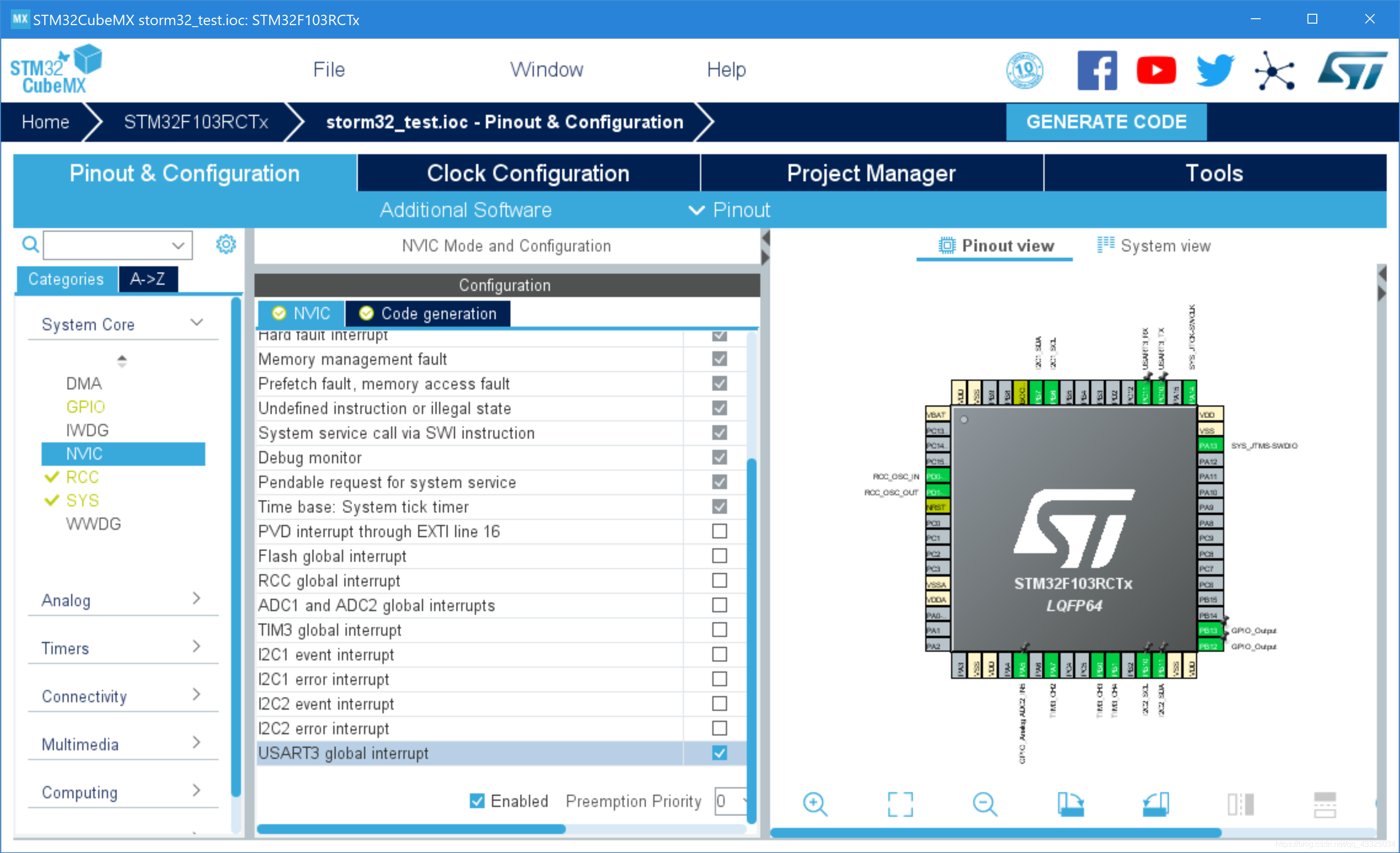

接下来进入pio中,首先使能usart3的中断
允许usart接受中断:
HAL_UART_Receive_IT(uart3_it.uart,&(uart3_it.tmp_buff),1);

通过串口发回去后,gui会判断是否停止发送。
至此,逻辑闭环
