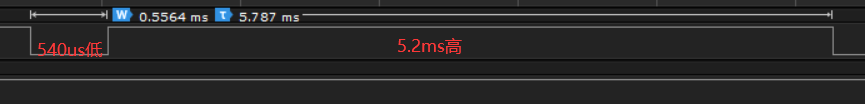

L引导码:4.5ms低电平+4.5ms高电平(以解析方分析,编码方刚好相反,下面不再概述)

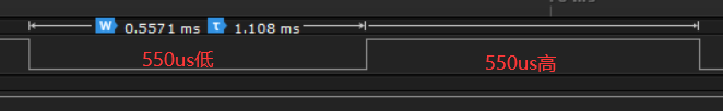

3.数据0格式
4.数据1格式
5.分隔码
6.完整时序图

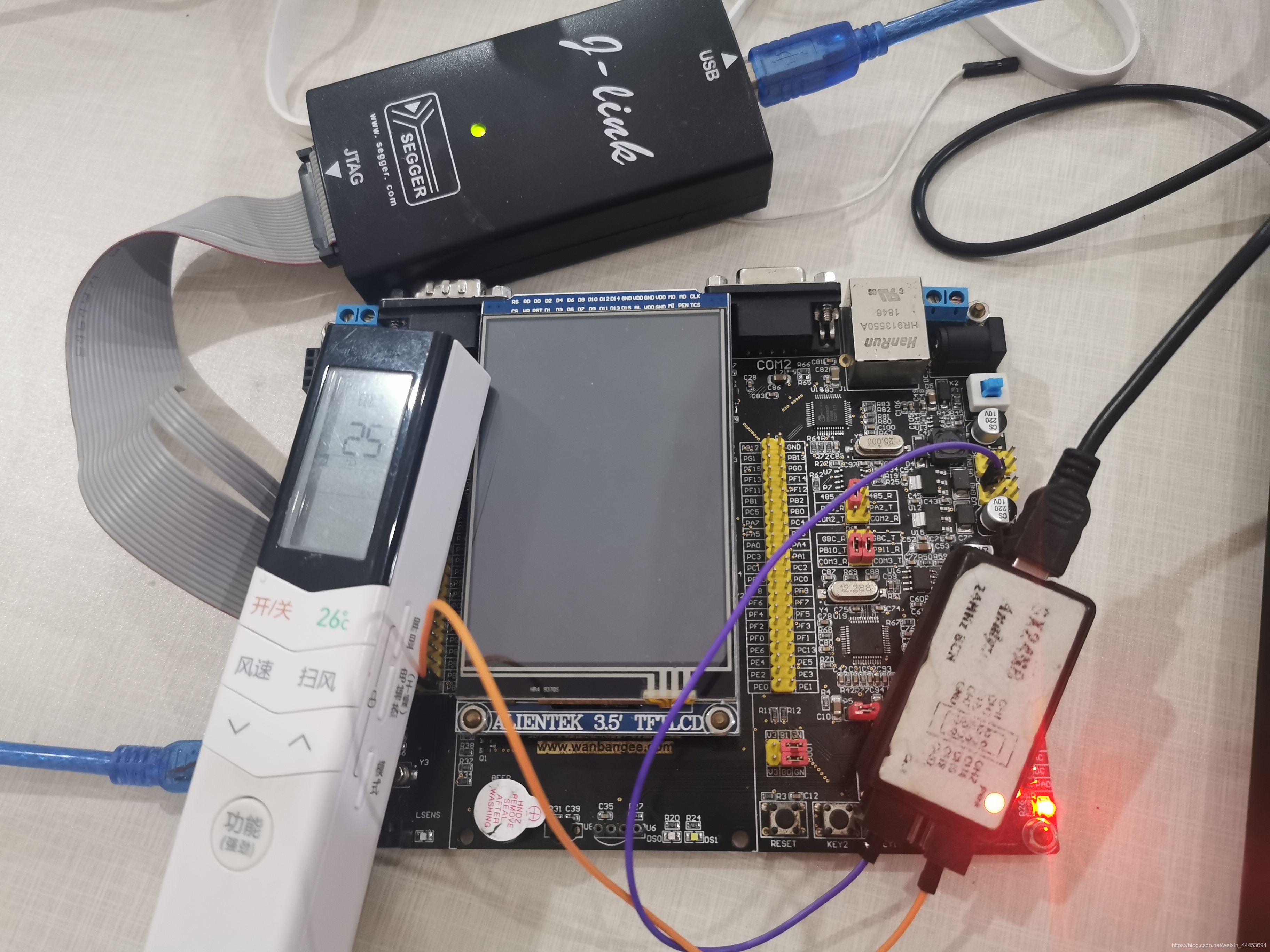

本次采用外部中断+定时器方式完成红外数据解析。

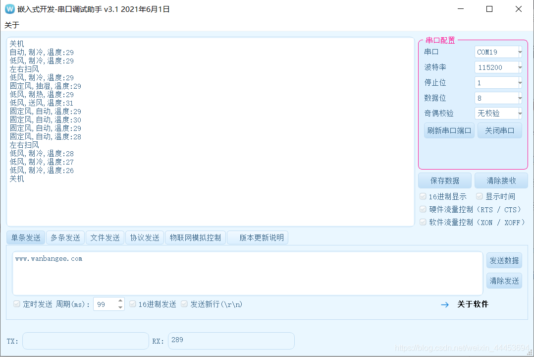

//printf("data:%#xrn",infrared_data);
if(data[2]==0x7B && data[4]==0xE0)
printf("关机rn");
else if(data[2]==0x6b && data[4]==0xE0)
printf("左右扫风rn");
else if(data[0]==0xb5 && data[2]==0xf5)//其它
else
wind=(data[2]>>5)&0x7;//风速
mode=(data[4]>>2)&0x3;//模式
temp=(data[4]>>4)&0xf;//温度
//printf("风速:%drn",wind);
//printf("模式:%drn",mode);
//printf("温度:%#xrn",temp);
if(wind==WIND_1)printf("自动,");
else if(wind==WIND_2)printf("低风,");
else if(wind==WIND_3)printf("中风,");
else if(wind==WIND_4)printf("高风,");
else if(wind==WIND_5)printf("固定风,");
if(mode==MODE_1)printf("自动,");
else if(mode==MODE_2)printf("制冷,");
else if(mode==MODE_3 && temp==T_31)printf("送风,");
else if(mode==MODE_3)printf("抽湿,");
else if(MODE_4)printf("制热,");
for(i=0;i<15;i++)
if(temp==r05d_temp)printf("温度:%drn",17+i);
infrared_stat=0;

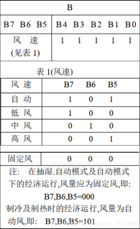

//风速设置B(5,7)
typedef enum R05D_WIND
WIND_1 =5,//B(5,7)=101,自动
WIND_2 =4,//B(5,7)=100,低风
WIND_3 =2,//B(5,7)=010,中风
WIND_4 =1,//B(5,7)=001,高风
WIND_5 =0,//B(5,7)=000,固定风
}R05d_W;

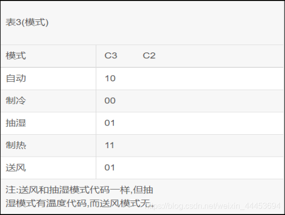

//模式C(2,3)
typedef enum R05D_Mode
MODE_1 =2, //C(2,3)=10,自动
MODE_2 =0, //C(2,3)=00,制冷
MODE_3 =1, //C(2,3)=01,抽湿,送风
MODE_4 =3, //C(2,3)=11,制热
}R05d_M;

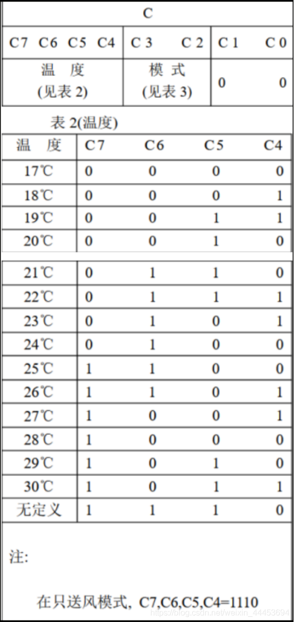

//温度C(4,7)
typedef enum R05D_Temp
T_17 =0,//C(4,7)=0000,17℃
T_18 =1,//C(4,7)=0001,18℃
T_19 =3,//C(4,7)=0011,19℃
T_20 =2,//C(4,7)=0010,20℃
T_21 =6,//C(4,7)=0110,21℃
T_22 =7,//C(4,7)=0111,22℃
T_23 =5,//C(4,7)=0101,23℃
T_24 =4,//C(4,7)=0100,24℃
T_25 =12,//C(4,7)=1100,25℃
T_26 =13,//C(4,7)=1101,26℃
T_27 =9,//C(4,7)=1001,27℃
T_28 =8,//C(4,7)=1000,28℃
T_29 =10,//C(4,7)=1010,29℃
T_30 =11,//C(4,7)=1011,30℃
T_31 =14,//C(4,7)=1110,无定义,送风模式下使用
}R05d_T;
