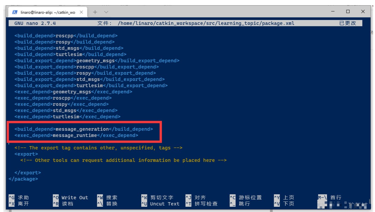

在package.xml中添加功能包依赖
nano ~/catkin_workspace/src/learning_topic/package.xml
message_generation
message_runtime

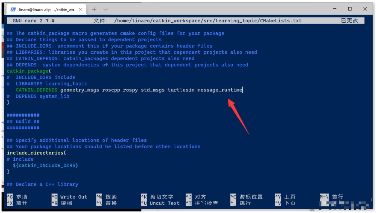

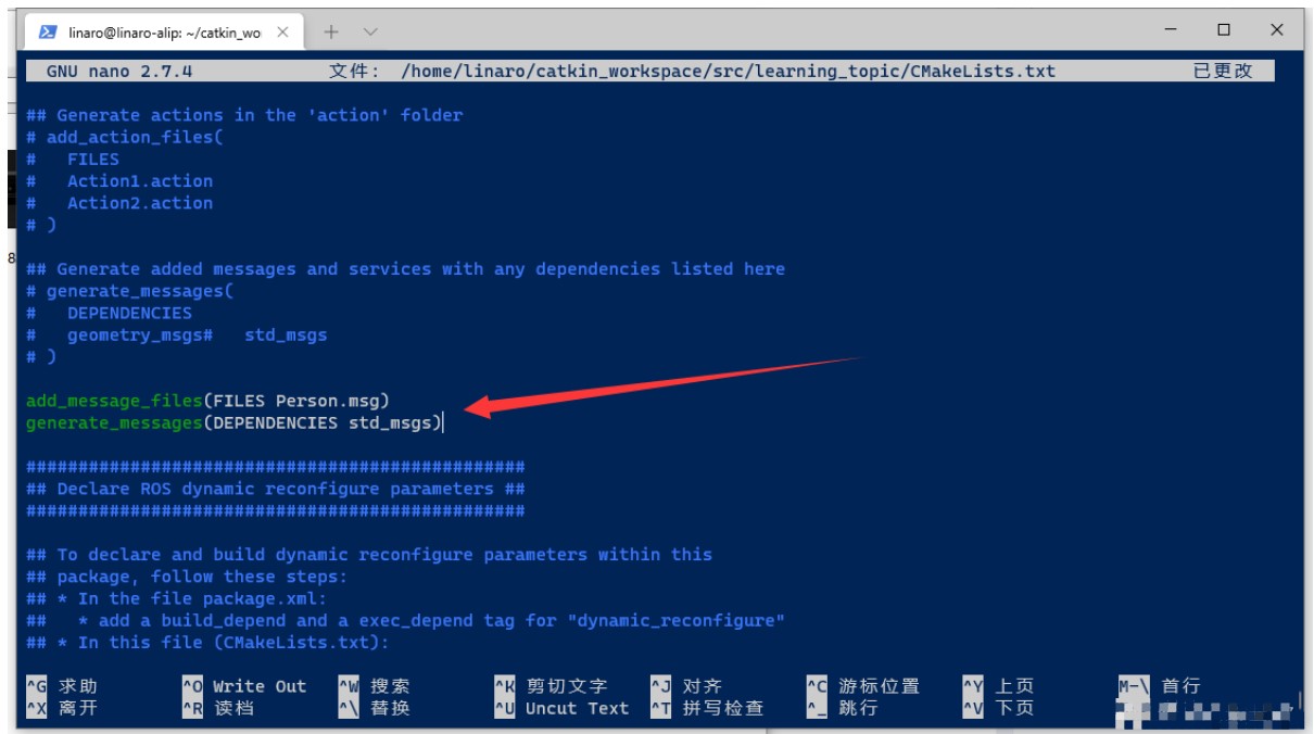

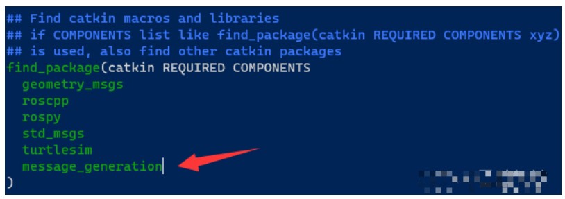

在CMakeLists.txt添加编译选项
find_package(... message_generation)
add_message_files(FILES Person.msg)
generate_messages(DEPENDENCIES std_msgs)
catkin_package(... message_runtime)
nano ~/catkin_workspace/src/learning_topic/CMakeLists.txt

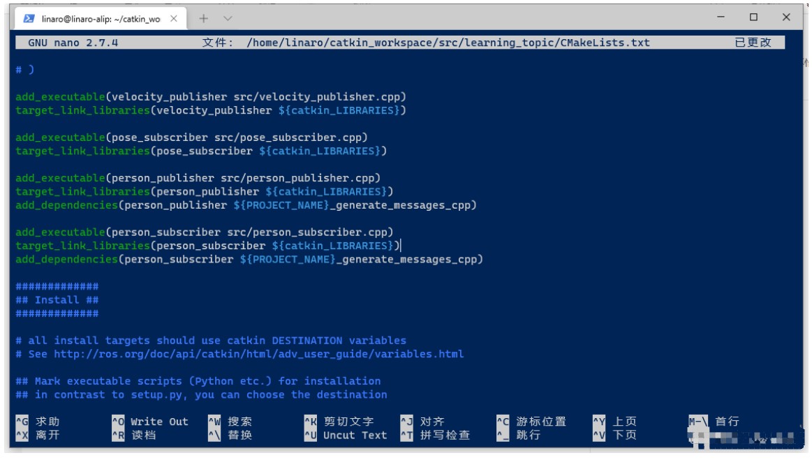

配置CMakeLists.txt
添加
add_executable(person_publisher src/person_publisher.cpp)
target_link_libraries(person_publisher ${catkin_LIBRARIES})
add_dependencies(person_publisher ${PROJECT_NAME}_generate_messages_cpp)
add_executable(person_subscriber src/person_subscriber.cpp)
target_link_libraries(person_subscriber ${catkin_LIBRARIES})
add_dependencies(person_subscriber ${PROJECT_NAME}_generate_messages_cpp)
设置需要编译的代码和生成的可执行文件;
设置链接库;
添加依赖项。

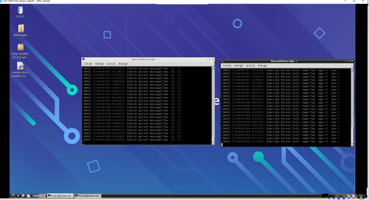

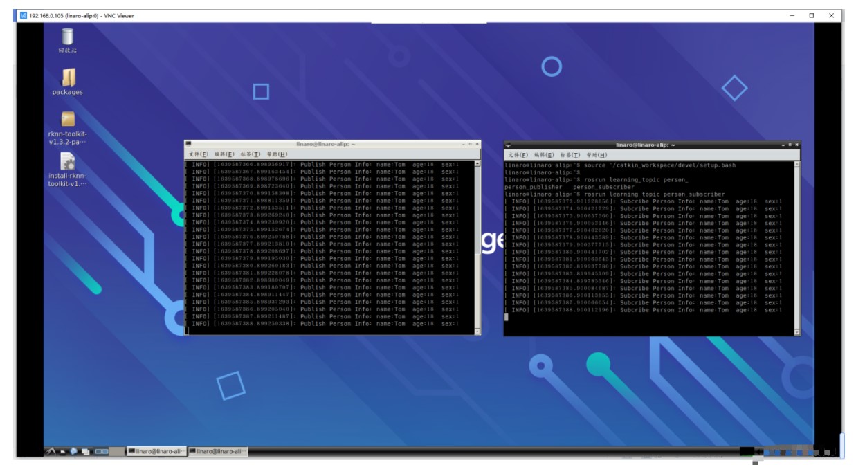

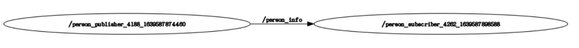

编译并运行
cd ~/catkin_workspace
catkin_make
# 新建一个终端
source ~/catkin_workspace/devel/setup.bash
roscore
# 新建一个终端
rosrun learning_topic person_publisher
# 新建一个终端
rosrun learning_topic person_subscriber
# 新建一个终端
rqt_graph

运行
sudo chmod +x ~/catkin_workspace/src/learning_topic/scripts/person_publisher.py
sudo chmod +x ~/catkin_workspace/src/learning_topic/scripts/person_subscriber.py
# 新建一个终端
roscore
# 新建一个终端
rosrun learning_topic person_publisher.py
# 新建一个终端
rosrun learning_topic person_subscriber.py
# 新建一个终端
rqt_graph
