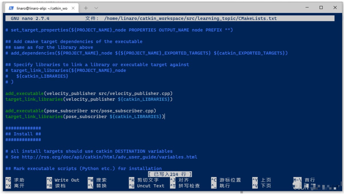

配置CMakeLists.txt
nano ~/catkin_workspace/src/learning_topic/CMakeLists.txt
在Build内,Install前加入
add_executable(pose_subscriber src/pose_subscriber.cpp)
target_link_libraries(pose_subscriber ${catkin_LIBRARIES})

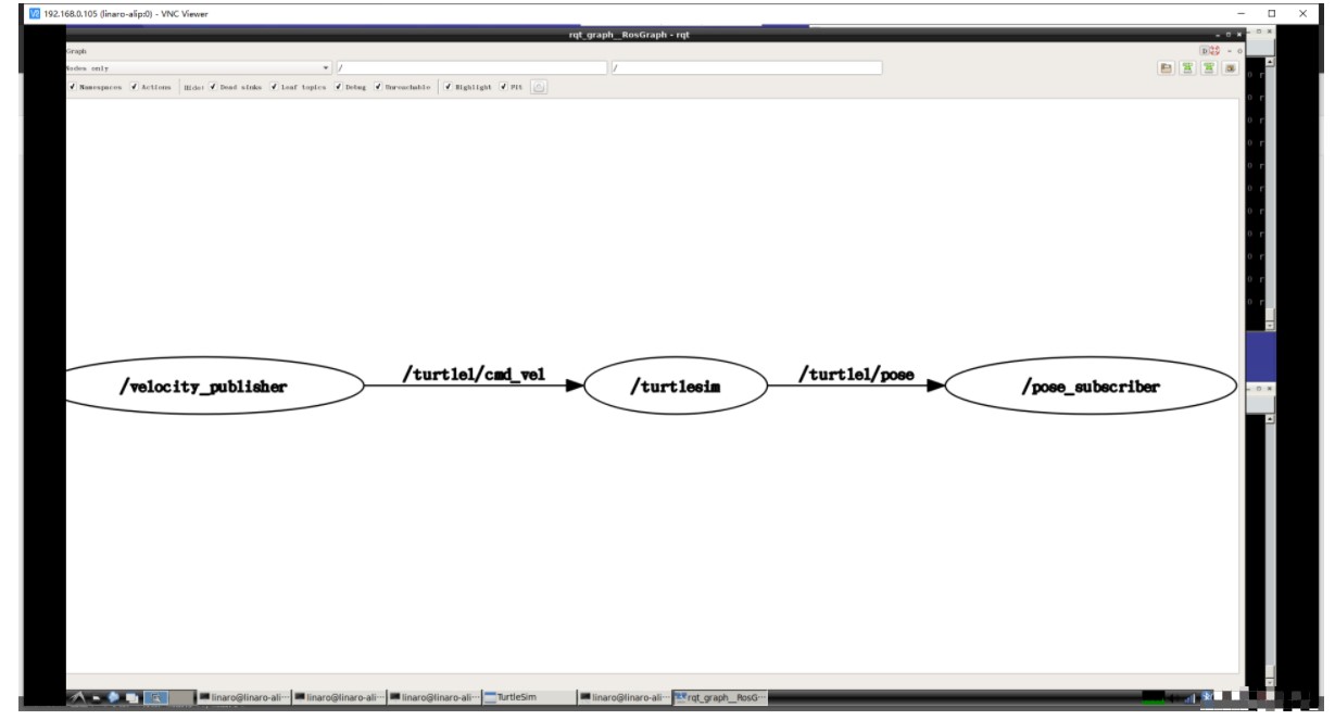

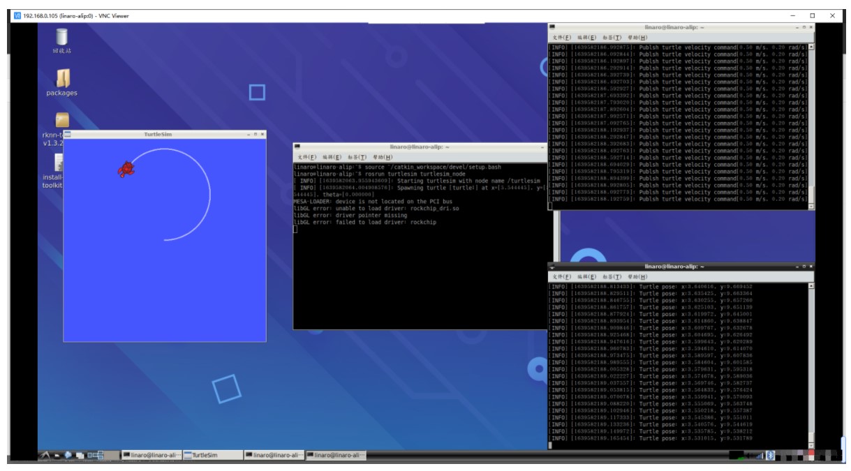

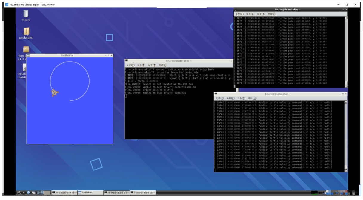

编译并运行发布者
cd ~/catkin_workspace
catkin_make
# 新建一个终端
source ~/catkin_workspace/devel/setup.bash
roscore
# 新建一个终端
rosrun turtlesim turtlesim_node
# 新建一个终端
rosrun learning_topic velocity_publisher
# 新建一个终端
rosrun learning_topic pose_subscriber
# 新建一个终端
rqt_graph
rqt_graph

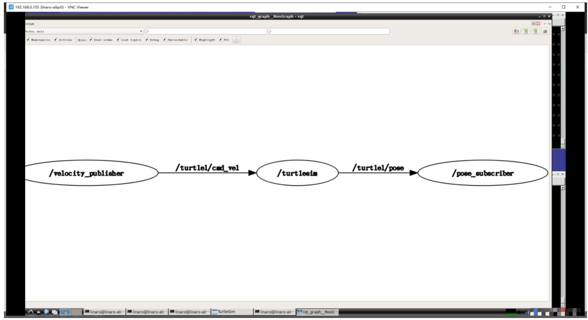

rqt_graph
