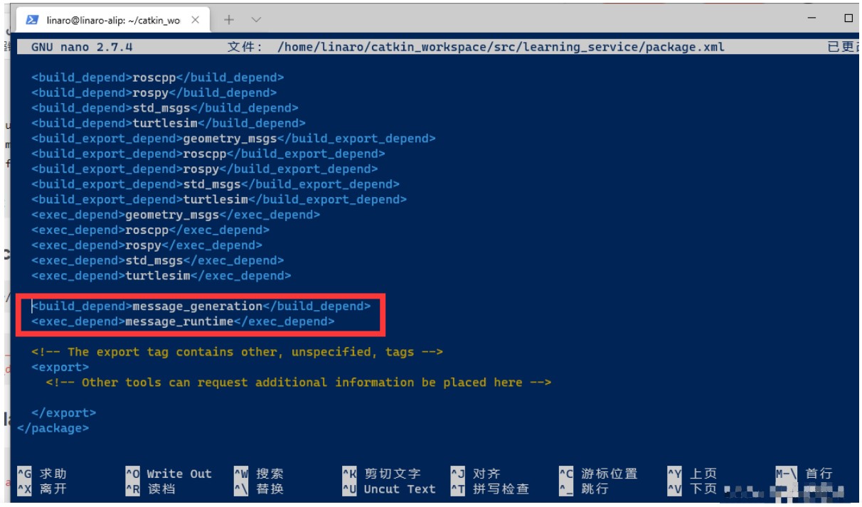

在package.xml中添加功能包依赖
nano ~/catkin_workspace/src/learning_service/package.xml
message_generation
message_runtime

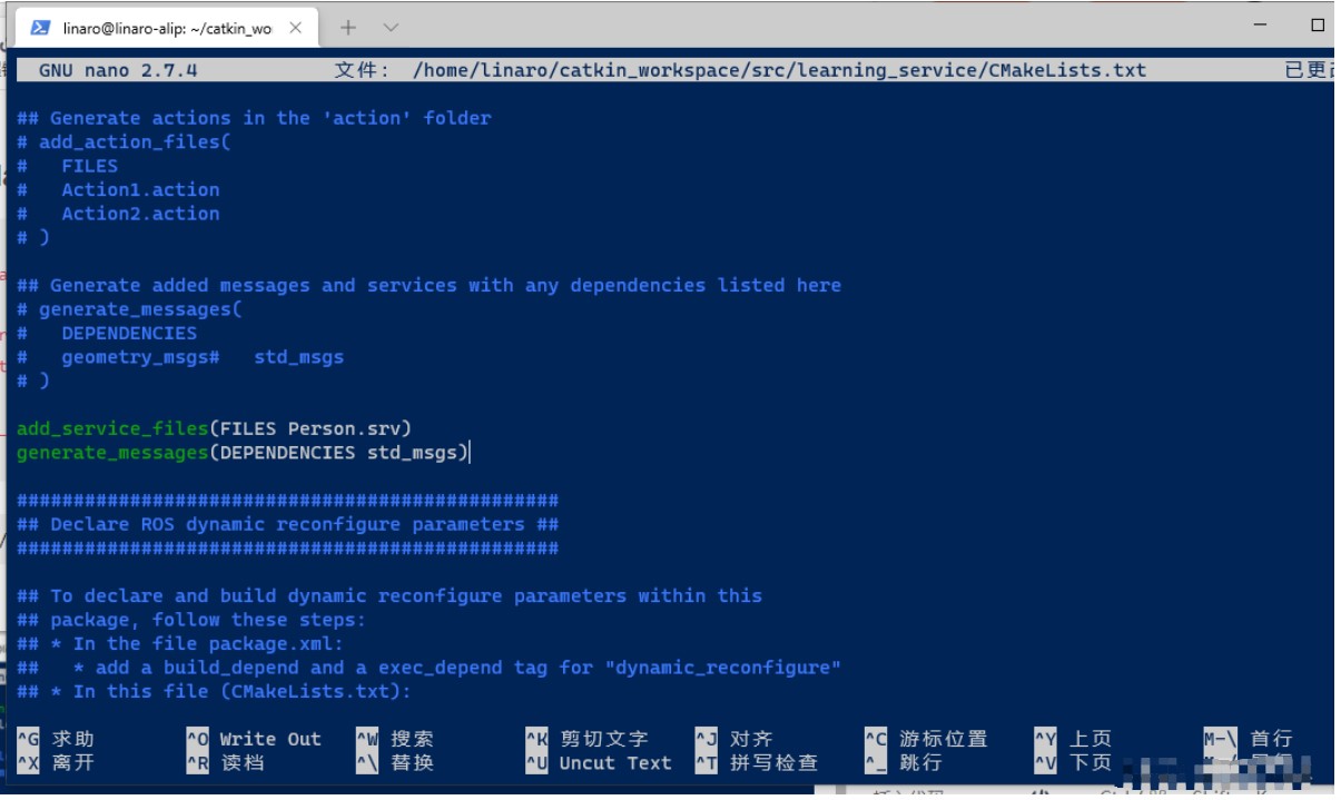

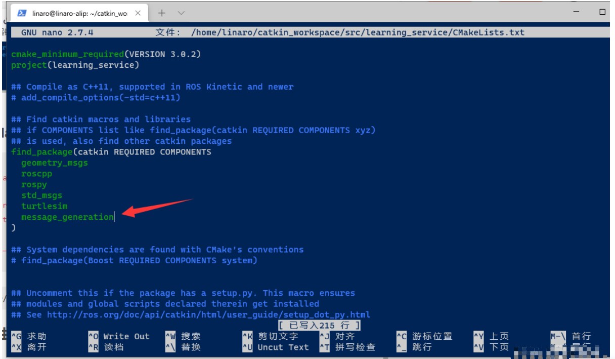

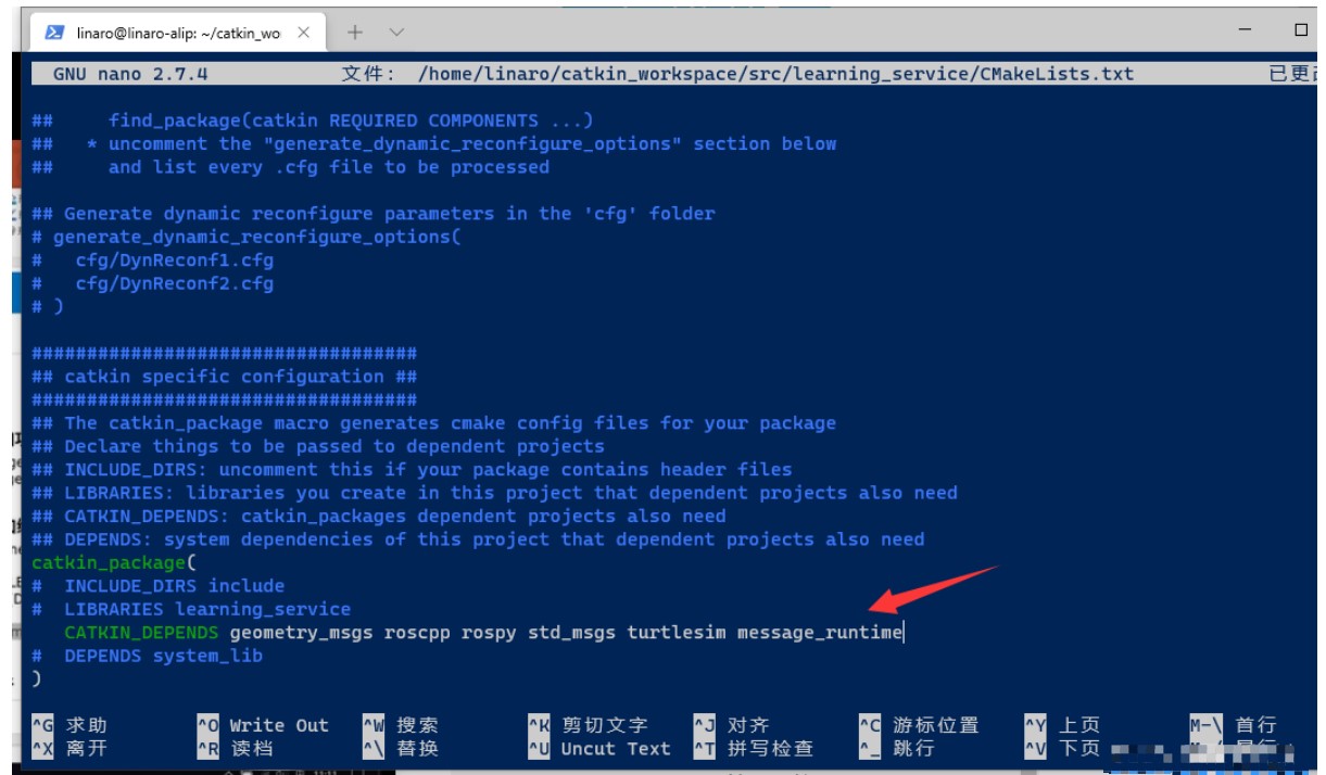

在CMakeLists.txt添加编译选项
find_package(... message_generation)
add_service_files(FILES Person.srv)
generate_messages(DEPENDENCIES std_msgs)
catkin_package(... message_runtime)
nano ~/catkin_workspace/src/learning_service/CMakeLists.txt

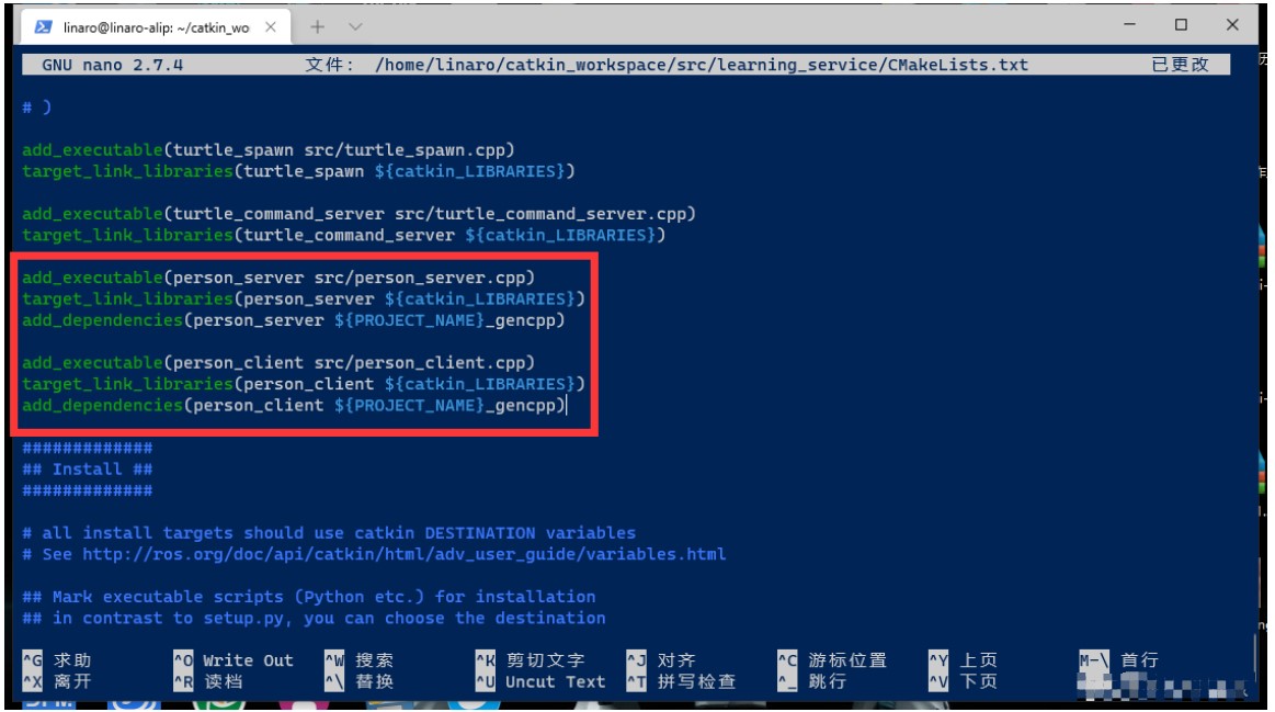

配置CMakeLists.txt
添加
add_executable(person_server src/person_server.cpp)
target_link_libraries(person_server ${catkin_LIBRARIES})
add_dependencies(person_server ${PROJECT_NAME}_gencpp)
add_executable(person_client src/person_client.cpp)
target_link_libraries(person_client ${catkin_LIBRARIES})
add_dependencies(person_client ${PROJECT_NAME}_gencpp)
设置需要编译的代码和生成的可执行文件;
设置链接库;
添加依赖项。

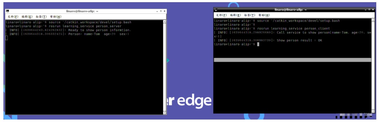

编译并运行
cd ~/catkin_workspace
catkin_make
# 新建一个终端
source ~/catkin_workspace/devel/setup.bash
roscore
# 新建一个终端
rosrun learning_service person_server
# 新建一个终端
rosrun learning_service person_client

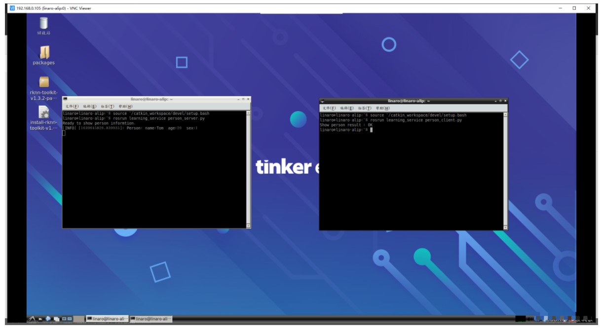

运行
sudo chmod +x ~/catkin_workspace/src/learning_service/scripts/person_server.py
sudo chmod +x ~/catkin_workspace/src/learning_service/scripts/person_client.py
# 新建一个终端
roscore
# 新建一个终端
rosrun learning_service person_server.py
# 新建一个终端
rosrun learning_service person_client.py
message_generation
message_runtime

配置CMakeLists.txt
添加
设置需要编译的代码和生成的可执行文件;
设置链接库;
添加依赖项。
编译并运行
catkin_make
# 新建一个终端
roscore
# 新建一个终端
# 新建一个终端

运行
# 新建一个终端
roscore
# 新建一个终端
# 新建一个终端
