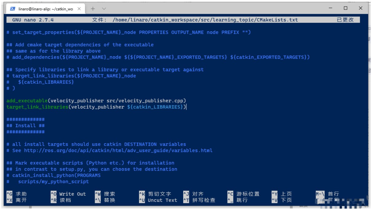

配置CMakeLists.txt
nano ~/catkin_workspace/src/learning_topic/CMakeLists.txt
在Build内,Install前加入
add_executable(velocity_publisher src/velocity_publisher.cpp)
target_link_libraries(velocity_publisher ${catkin_LIBRARIES})
设置需要编译的代码和生成的可执行文件;
设置链接库;

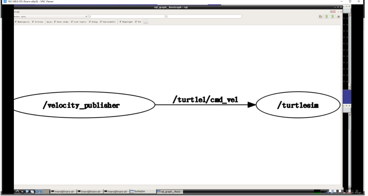

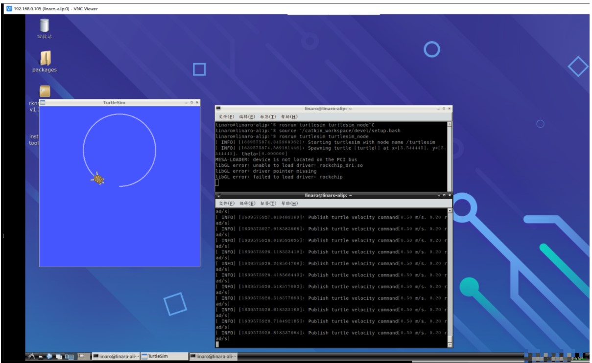

编译并运行发布者
cd ~/catkin_workspace
catkin_make
# 新建一个终端
source ~/catkin_workspace/devel/setup.bash
roscore
# 新建一个终端
rosrun turtlesim turtlesim_node
# 新建一个终端
rosrun learning_topic velocity_publisher
# 新建一个终端
rqt_graph

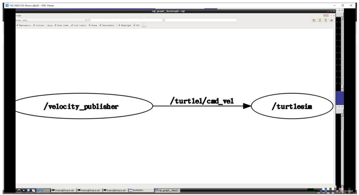

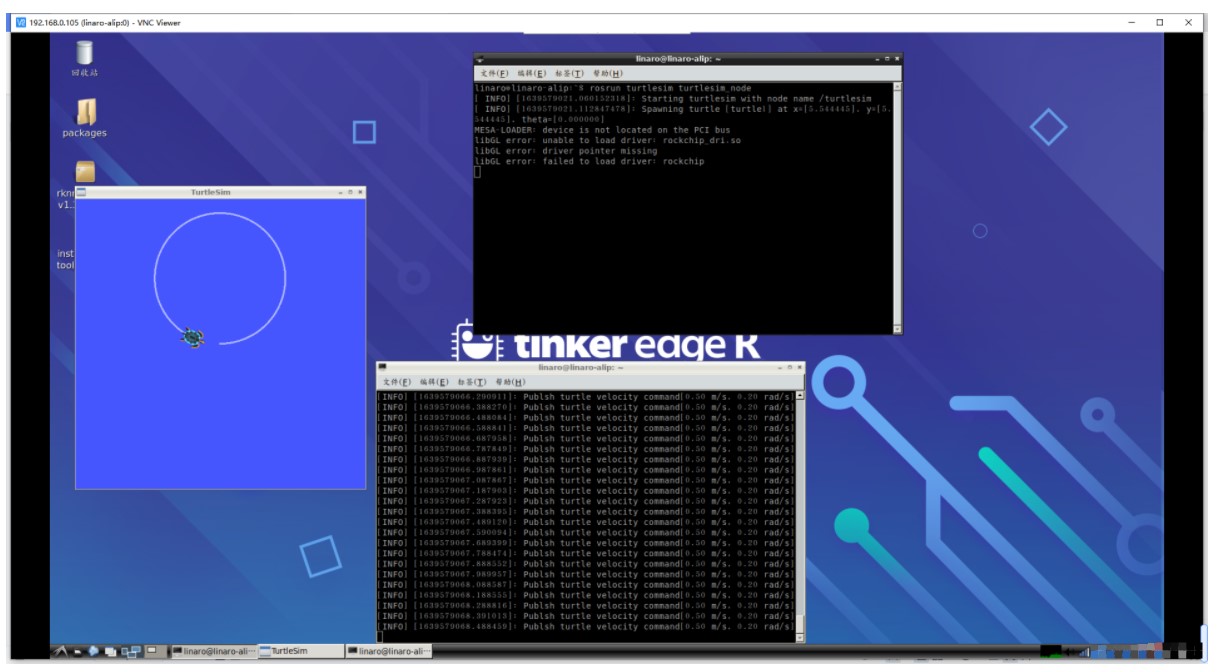

运行
sudo chmod +x ~/catkin_workspace/src/learning_topic/scripts/velocity_publisher.py
# 新建一个终端
roscore
# 新建一个终端
# 新建一个终端
rosrun learning_topic velocity_publisher.py
# 新建一个终端
rqt_graph
