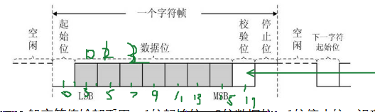

1.3 接收
接收数据的时候,下降沿激发产生外部中断事件,开启定时器2。每隔一段时间读取一下gpio引脚的电平状态,保存在临时数组,到停止位则一个字节数据接收完成,读取字节数据,放在全局256大小的缓冲区。
注意:这里读取GPIo引脚的状态,应该在每个bit位的1/2读取GPIO的状态,这样读取的数据比较准确。

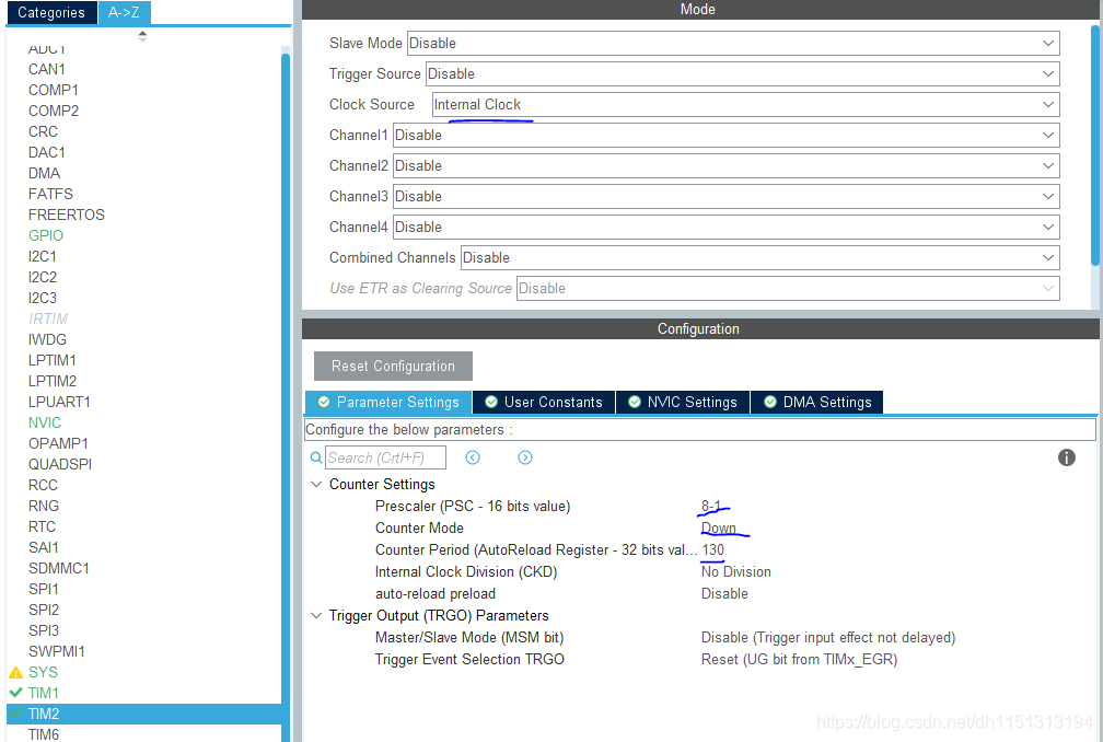

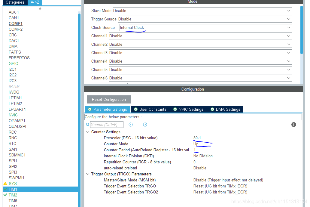

二 crubeMX配置

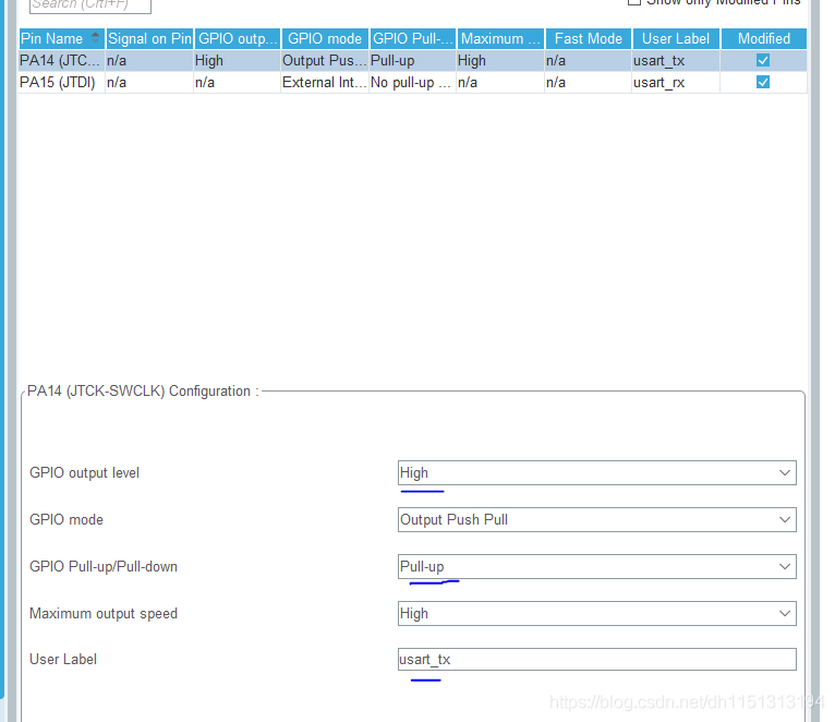

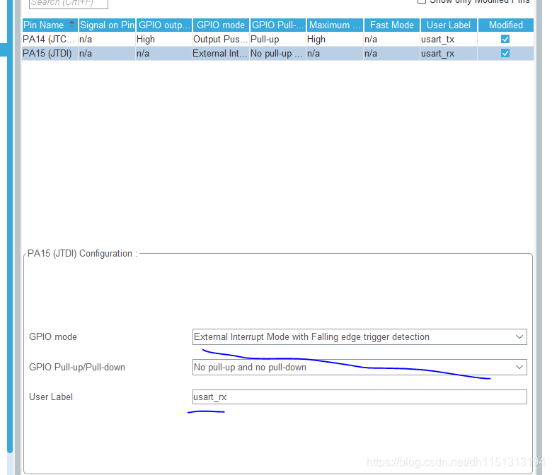

2.1 GPIO配置

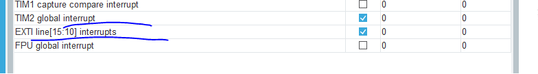

2.2 定时器2中断,外部中断
2.3 定时器1配置

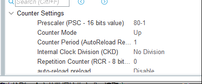

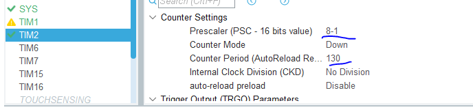

2.4 定时器2配置
配置好后生成工程

3.1 修改tim.c
实现定时器初始化,delay_ms(),delay_us(),定时器2回调

TIM_HandleTypeDef htim1;
TIM_HandleTypeDef htim2;
/* TIM1 init function */
void MX_TIM1_Init(void)
TIM_ClockConfigTypeDef sClockSourceConfig = {0};
TIM_MasterConfigTypeDef sMasterConfig = {0};
htim1.Instance = TIM1;
htim1.Init.Prescaler = 80-1;
htim1.Init.CounterMode = TIM_COUNTERMODE_UP;
htim1.Init.Period = 1;
htim1.Init.ClockDivision = TIM_CLOCKDIVISION_DIV1;
htim1.Init.RepetitionCounter = 0;
htim1.Init.AutoReloadPreload = TIM_AUTORELOAD_PRELOAD_DISABLE;
if (HAL_TIM_Base_Init(&htim1) != HAL_OK)
Error_Handler();
sClockSourceConfig.ClockSource = TIM_CLOCKSOURCE_INTERNAL;
if (HAL_TIM_ConfigClockSource(&htim1, &sClockSourceConfig) != HAL_OK)
Error_Handler();
sMasterConfig.MasterOutputTrigger = TIM_TRGO_RESET;
sMasterConfig.MasterOutputTrigger2 = TIM_TRGO2_RESET;
sMasterConfig.MasterSlaveMode = TIM_MASTERSLAVEMODE_DISABLE;
if (HAL_TIMEx_MasterConfigSynchronization(&htim1, &sMasterConfig) != HAL_OK)
Error_Handler();
/* TIM2 init function */
void MX_TIM2_Init(void)
htim2.Instance = TIM2;
htim2.Init.Prescaler = 8-1;
htim2.Init.CounterMode = TIM_COUNTERMODE_DOWN;
htim2.Init.Period = 130;
htim2.Init.ClockDivision = TIM_CLOCKDIVISION_DIV1;
htim2.Init.AutoReloadPreload = TIM_AUTORELOAD_PRELOAD_DISABLE;
if (HAL_TIM_Base_Init(&htim2) != HAL_OK)
Error_Handler();
if (HAL_TIM_ConfigClockSource(&htim2, &sClockSourceConfig) != HAL_OK)
Error_Handler();
if (HAL_TIMEx_MasterConfigSynchronization(&htim2, &sMasterConfig) != HAL_OK)
Error_Handler();

/* TIM2 interrupt Init */
HAL_NVIC_SetPriority(TIM2_IRQn, 0, 0);
HAL_NVIC_EnableIRQ(TIM2_IRQn);

/* Configure GPIO */
/* USER CODE BEGIN 1 */
/* USER CODE END 1 */
/** Configure pins
void MX_GPIO_Init(void)
GPIO_InitTypeDef GPIO_InitStruct = {0};
/* GPIO Ports Clock Enable */
__HAL_RCC_GPIOA_CLK_ENABLE();
/*Configure GPIO pin Output Level */
HAL_GPIO_WritePin(usart_tx_GPIO_Port, usart_tx_Pin, GPIO_PIN_SET);
/*Configure GPIO pin : PtPin */
GPIO_InitStruct.Pin = usart_tx_Pin;
GPIO_InitStruct.Mode = GPIO_MODE_OUTPUT_PP;
GPIO_InitStruct.Pull = GPIO_PULLUP;
GPIO_InitStruct.Speed = GPIO_SPEED_FREQ_HIGH;
HAL_GPIO_Init(usart_tx_GPIO_Port, &GPIO_InitStruct);
GPIO_InitStruct.Pin = usart_rx_Pin;
GPIO_InitStruct.Mode = GPIO_MODE_IT_FALLING;
GPIO_InitStruct.Pull = GPIO_NOPULL;
HAL_GPIO_Init(usart_rx_GPIO_Port, &GPIO_InitStruct);
/* EXTI interrupt init*/
HAL_NVIC_SetPriority(EXTI15_10_IRQn, 0, 0);
HAL_NVIC_EnableIRQ(EXTI15_10_IRQn);

if(recvStat == COM_STOP_BIT)
for(uint8_t i=1;i<9;i++ )
if(USART_8buf[2*i])//2 4 6 8 10 12 14 16
recvData |= (1 << (i - 1));
}else{
recvData &= ~(1 << (i - 1));
USART_buf[len++] = recvData;

二 crubeMX配置
2.1 GPIO配置
2.2 定时器2中断,外部中断
2.3 定时器1配置
2.4 定时器2配置
配置好后生成工程
