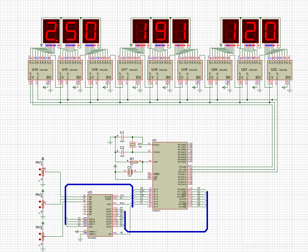

如何实现ADC0808/ADC0809的多通道电压采集程序设计?

一、Proteus仿真电路图如下
二、程序见附件也可加群免费获取
#include
#include
#define uint unsigned int
#define uchar unsigned char
#define ulong unsigned long
/*74HC595所用引脚宏定义*/
***it HC595_DAT = P2^0;
***it HC595_CLK = P2^1;
***it HC595_STC = P2^2;
/*ADC0832所用引脚宏定义*/
***it OE = P1^0;
***it EOC = P1^1;
***it ST = P1^2;
***it CLK = P1^3;
***it CC = P1^6;
***it BB = P1^5;
***it AA = P1^4;
/*数码管段选码数组定义(不带小数点)*/
uchar LEDData[10]=
0x03, /*0*/
0x9F, /*1*/
0x25, /*2*/
0x0D, /*3*/
0x99, /*4*/
0x49, /*5*/
0x41, /*6*/
0x1F, /*7*/
0x01, /*8*/
0x09 /*9*/
/*数码管段选码数组定义(带小数点)*/
uchar LEDData1[10]=
0x02, /*0*/
0x9E, /*1*/
0x24, /*2*/
0x0C, /*3*/
0x98, /*4*/
0x48, /*5*/
0x40, /*6*/
0x1E, /*7*/
0x00, /*8*/
0x08 /*9*/
/*毫秒延时函数ms*/
//void DelayMS(uint ms)
// uchar i;
// while(ms--)
// for(i=0;i<120;i++);
/*74HC595显示函数1->显示ADC电压值*/
uchar v1[3] = {0x03,0x03,0x03};
uchar v2[3] = {0x03,0x03,0x03};
uchar v3[3] = {0x03,0x03,0x03};
void Send_HC595_Byte(uchar temp8)
uchar i;
for(i = 0; i < 8; i++)
HC595_DAT = temp8&0x01;//从高位开始传输
HC595_CLK = 0;
_nop_();
_nop_();
HC595_CLK = 1;
temp8=temp8>>1;
void Display(uchar v1[3],uchar v2[3],uchar v3[3])
HC595_STC = 0;
Send_HC595_Byte(v1[0]);
Send_HC595_Byte(v1[1]);
Send_HC595_Byte(v1[2]);
Send_HC595_Byte(v2[0]);
Send_HC595_Byte(v2[1]);
Send_HC595_Byte(v2[2]);
Send_HC595_Byte(v3[0]);
Send_HC595_Byte(v3[1]);
Send_HC595_Byte(v3[2]);
HC595_STC = 1;
void main()
TMOD = 0x02;
TH0 = 0xFB;
TL0 = 0xFB; //500KHZ
TR0 = 1;
ET0 = 1;
EA = 1;
while(1)
/*通道0转换*/
CC = 0;BB = 0;AA = 0;
ST = 0;
ST = 1;
ST = 0;
_nop_();_nop_();_nop_();
while(EOC == 0);
OE = 1;
v3[2] = LEDData1[P3/100];
v3[1] = LEDData[P3%100/10];
v3[0] = LEDData[P3%10];
OE = 0;
/*通道1转换*/
CC = 0;BB = 0;AA = 1;
ST = 0;
ST = 1;
ST = 0;
while(EOC == 0);
OE = 1;
v2[2] = LEDData[P3/100];
v2[1] = LEDData[P3%100/10];
v2[0] = LEDData[P3%10];
OE = 0;
/*通道2转换*/
CC = 0;BB = 1;AA = 0;
ST = 0;
ST = 1;
ST = 0;
while(EOC == 0);
OE = 1;
v1[2] = LEDData[P3/100];
v1[1] = LEDData[P3%100/10];
v1[0] = LEDData[P3%10];
OE = 0;
/*595数码管显示三通道采集到的ADC数值*/
Display(v1,v2,v3);
void Timer0_INT() interrupt 1
TH0 = 0xFB;
TL0 = 0xFB;
CLK = !CLK;
