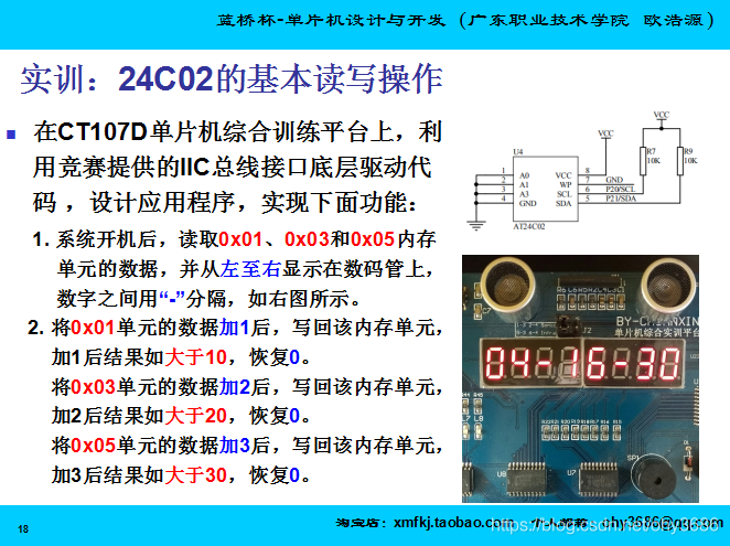

【9】基本读写操作流程
24C02的字节写操作,参考代码:

【10】进阶强化实训
【11】参考源码共享
#include "regx52.h"
#include "absacc.h"
#include "iic.h"
unsigned char dat1 = 0, dat2 = 0, dat3 = 0;
unsigned char code SMG_duanma[18]=
{0xc0,0xf9,0xa4,0xb0,0x99,0x92,0x82,0xf8,0x80,0x90,
0x88,0x80,0xc6,0xc0,0x86,0x8e,0xbf,0x7f};
void DelaySMG(unsigned int t)
while(t--);
void DisplaySMG_Bit(unsigned char pos, unsigned char value)
XBYTE[0xE000] = 0xFF;
XBYTE[0xC000] = 0x01 << pos;
XBYTE[0xE000] = value;
void Write_24C02(unsigned char addr, unsigned char dat)
IIC_Start();
IIC_SendByte(0xa0);
IIC_WaitAck();
IIC_SendByte(addr);
IIC_WaitAck();
IIC_SendByte(dat);
IIC_WaitAck();
IIC_Stop();
unsigned char Read_24C02(unsigned char addr)
unsigned char tmp;
IIC_Start();
IIC_SendByte(0xa0);
IIC_WaitAck();
IIC_SendByte(addr);
IIC_WaitAck();
IIC_Start();
IIC_SendByte(0xa1);
IIC_WaitAck();
tmp = IIC_RecByte();
IIC_Ack(0);
IIC_Stop();
return tmp;
void Read_Write()
dat1 = Read_24C02(0x01);
dat2 = Read_24C02(0x03);
dat3 = Read_24C02(0x05);
dat1 = dat1 + 1;
dat2 = dat2 + 2;
dat3 = dat3 + 3;
if(dat1 > 10)
dat1 = 0;
if(dat2 > 20)
dat2 = 0;
if(dat3 > 30)
dat3 = 0;
Write_24C02(0x01, dat1);
DelaySMG(1000);
Write_24C02(0x03, dat2);
DelaySMG(1000);
Write_24C02(0x05, dat3);
DelaySMG(1000);
void DisplaySMG_24C02()
DisplaySMG_Bit(0, SMG_duanma[dat1/10]);
DelaySMG(500);
DisplaySMG_Bit(1, SMG_duanma[dat1%10]);
DelaySMG(500);
DisplaySMG_Bit(2, SMG_duanma[16]);
DelaySMG(500);
DisplaySMG_Bit(3, SMG_duanma[dat2/10]);
DelaySMG(500);
DisplaySMG_Bit(4, SMG_duanma[dat2%10]);
DelaySMG(500);
DisplaySMG_Bit(5, SMG_duanma[16]);
DelaySMG(500);
DisplaySMG_Bit(6, SMG_duanma[dat3/10]);
DelaySMG(500);
DisplaySMG_Bit(7, SMG_duanma[dat3%10]);
DelaySMG(500);
main()
XBYTE[0x8000] = 0xFF;
XBYTE[0xA000] = 0x00;
Read_Write();
while(1)
DisplaySMG_24C02();
