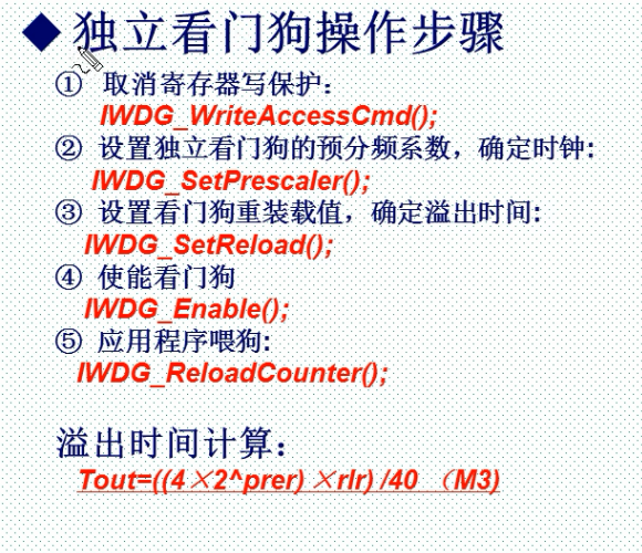

iwdg.c
1 #include"iwdg.h"
2

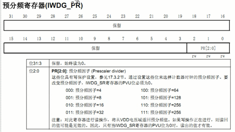

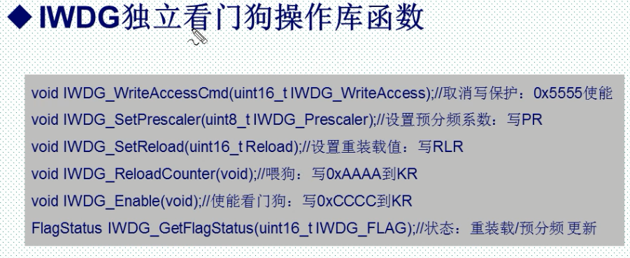

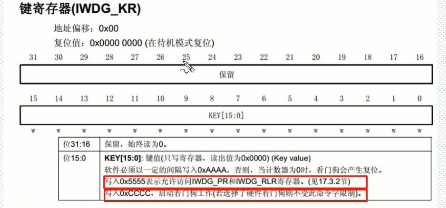

3 void iwdg_init(uint8_t IWDG_Prescaler,uint16_t Reload)
4 {
5 IWDG_WriteAccessCmd(IWDG_WriteAccess_Enable);
6 IWDG_SetPrescaler(IWDG_Prescaler);
7 IWDG_SetReload(Reload);
8 IWDG_ReloadCounter();
9 IWDG_Enable();
10
11 }

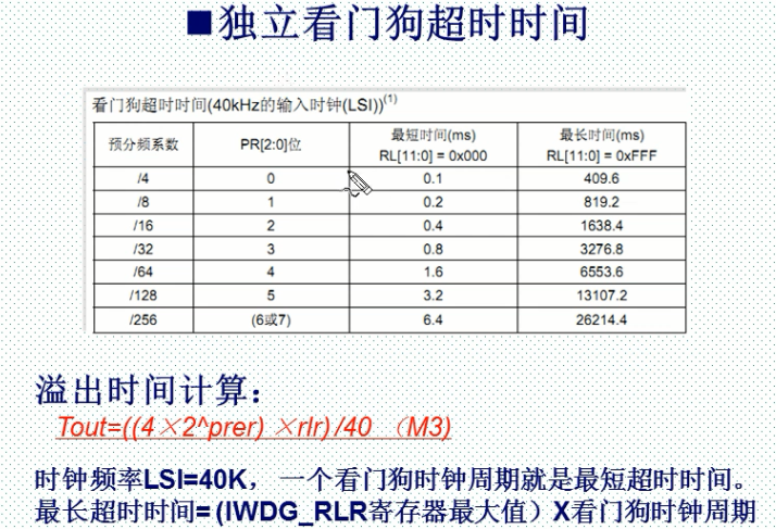

10 iwdg_init(4,625);//1s,看门狗超时时间

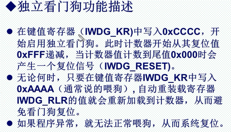

14 while(1)
15 {
16 if(KEY0_PRES==KEY0_PRES)
17 {
18 IWDG_ReloadCounter();
19 }
20 }
