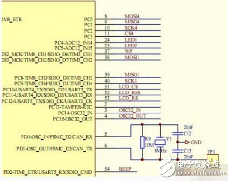

以下是硬件电路图,主芯片为stm32rbt6.
贴上代码
void SPI_FLASH_Init1(void)//io初始化配置
GPIO_InitTypeDef GPIO_InitStructure;
RCC_APB2PeriphClockCmd(RCC_APB2Periph_GPIOA | RCC_APB2Periph_GPIOC, ENABLE);
GPIO_InitStructure.GPIO_Pin = GPIO_Pin_7 | GPIO_Pin_9;//CS CLK
GPIO_InitStructure.GPIO_Mode = GPIO_Mode_Out_PP;
GPIO_InitStructure.GPIO_Speed = GPIO_Speed_50MHz;
GPIO_Init(GPIOC, &GPIO_InitStructure);
GPIO_InitStructure.GPIO_Pin = GPIO_Pin_8 ;
GPIO_InitStructure.GPIO_Mode = GPIO_Mode_IN_FLOATING; //MOSI要用模拟输入
GPIO_InitStructure.GPIO_Pin = GPIO_Pin_8;
GPIO_InitStructure.GPIO_Mode = GPIO_Mode_Out_PP;//MISO
GPIO_Init(GPIOA, &GPIO_InitStructure);
//关键在读取函数
//包括读取和发送
u8 SPIx_FLASH_SendByte(u8 byte)
uint8_t i;
u8 Temp=0x00;
unsigned char SDI;
for (i = 0; i 《 8; i++)
GPIO_SetBits(GPIOC, GPIO_Pin_9);//sclk = 0;//先将时钟拉高
if (byte&0x80)
GPIO_SetBits(GPIOC, GPIO_Pin_7); // //SO=1
else
GPIO_ResetBits(GPIOC, GPIO_Pin_7);// //SO=0
byte 《《= 1;
GPIO_ResetBits(GPIOC, GPIO_Pin_9);// //sclk = 1; 拉低时钟
SDI = GPIO_ReadInputDataBit(GPIOC, GPIO_Pin_8);//判断si是否有输入
Temp《《=1;
if(SDI) //读到1时
Temp++; //置1 即向右移动一位同时加1 因上边有《《=1
GPIO_SetBits(GPIOC, GPIO_Pin_9);//sclk = 0;// 拉高时钟
return Temp; //返回读到miso输入的值
//下面是以读写spi flash为例具体的实现
//此函数中 时钟机时序很重要。Cs在读写中只能出现一次,不能在sendwrite
//读写里边有,被调用时还出现,就肯定不行了。
