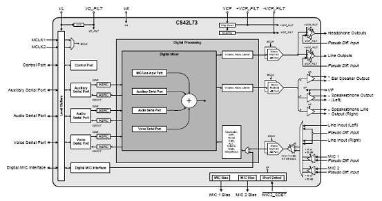

图1. CS42L73方框图

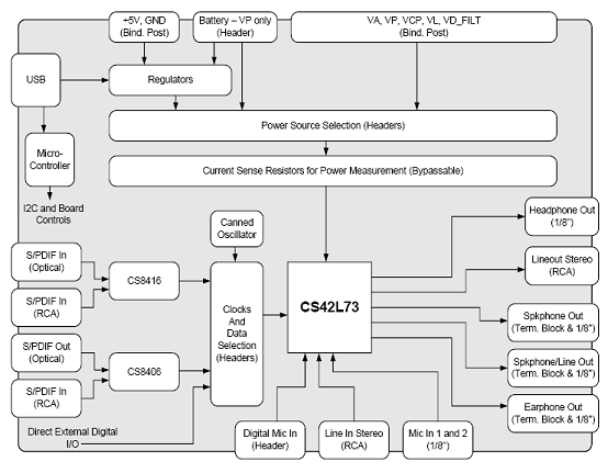

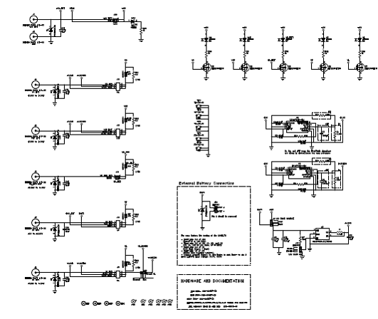

图3.评估板CDB42L73系统框图

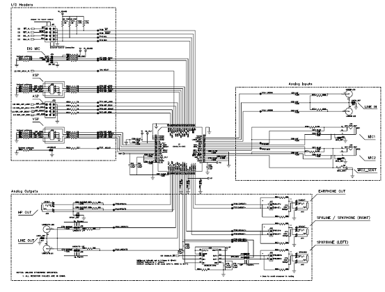

图4.评估板CDB42L73电路图: CS42L73

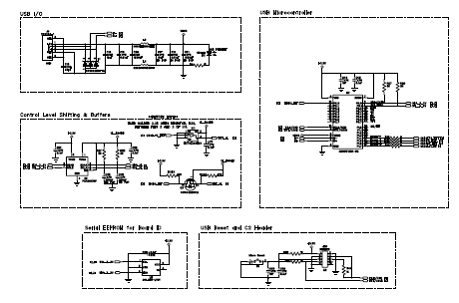

图5.评估板CDB42L73电路图:USB和MCU
图6.评估板CDB42L73电路图:S/PDIF接收器和发送器,时钟缓冲器
图7.评估板CDB42L73电路图:电源

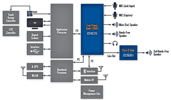

图8.智能手机中的CS42L73应用

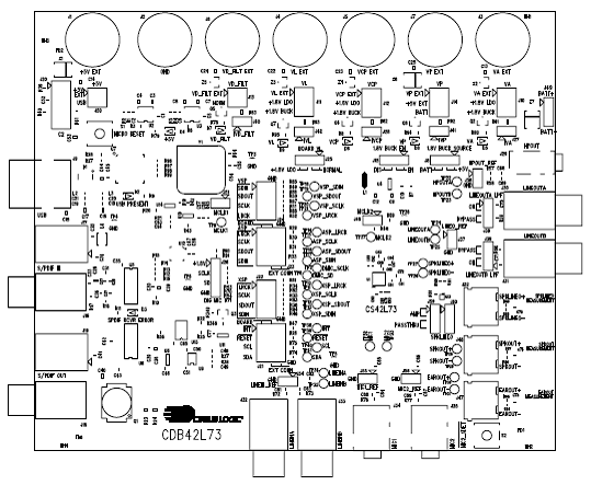

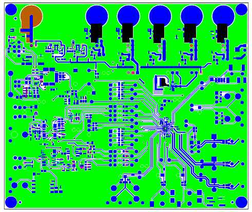

图9.评估板CDB42L73元件布局图
图10.评估板CDB42L73 PCB布局图(层1)

图1. CS42L73方框图
图2. CS42L73典型应用电路图
评估板CDB42L73
Evaluation Board for the CS42L73
The CDB42L73 board is a dedicated platform for testing and evaluating the CS42L73, an ultralow power mobile audio and telephony CODEC.
To allow comprehensive testing of CS42L73 features and performance, extensive hardware and software configurable options are available on the CDB42L73.
Hardware options, such as power-supply settings, are configured via jumpers on the stake headers. Software options, such as registry settings for the CS42L73, are configured with the FlexGUI software, which communicates with the CDB42L73 via USB from a Windows® compatible computer. In addition, digital I/O headers on the CDB42L73 allow external control signals (for example, an external DSP or microcontroller) to configure and interface with the CS42L73 and other devices directly without the use of FlexGUI.
The CDB42L73 also serves as a good component and layout reference for the CS42L73.
评估板CDB42L73主要特性:
Analog Inputs
– Line-level In via 2x mono RCA jacks
– Microphone In via 2x mono 1/8” jacks
Analog outputs
– Headphone out via 1x stereo 1/8” jack
– Line-level out via 2x mono RCA jacks
– Earphone out via terminal block
– Speakerphone out via terminal blocks
S/PDIF interface via RCA/optical jacks
– Input: CS8416 digital audio receiver
– Output: CS8406 digital audio transmitter
External digital I/O via stake headers
– Digital mic in
– Serial audio port I/O
– External I²C™ control port I/O
Flexible power-supply configuration
– USB, external power supply, or battery
FlexGUI software control
– Windows® compatible
– Predefined and user-configurable scripts
图3.评估板CDB42L73系统框图
图8.智能手机中的CS42L73应用
图9.评估板CDB42L73元件布局图
