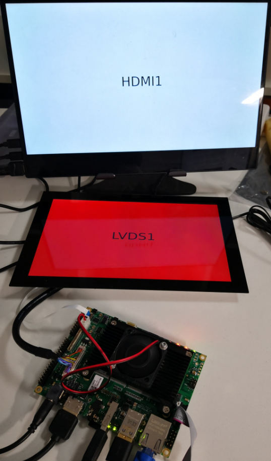

e). 测试qtwayland compositor
# disable default wayland qt demo app systemd service
$ systemctl disable wayland-app-launch
$ reboot
重启后,可以看到下面双屏显示结果,qtwayland compositor启动成功
