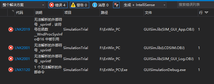

用Visual studio2017 做Enwin PC仿真时出现问题的解决办法?
之前已经经过以下步骤后综合例程可以跑了1. Right-Click on the Project (e.g. SimulationTrial) -> Properties
2  Set Configuration to "All Configurations"
3. Goto Configuration Properties -> Linker -> Input.
4. Set Ignore All Default Libraries: "No"
5. Set Ignore Specific Default Libraries: "LIBC.lib;LIBCMTD.lib"
6. Goto Configuration Properties -> Linker -> Advanced
7. Set Image Has Safe Exception Handlers:"No (/SAFESEH:NO)"
8. Click "OK"-Button.
但是关掉综合例程再开启其他小工具的例程的时候就会出现如下问题
求大神关爱

薛丽娜
2020-5-8 10:32:00
用2012打开
