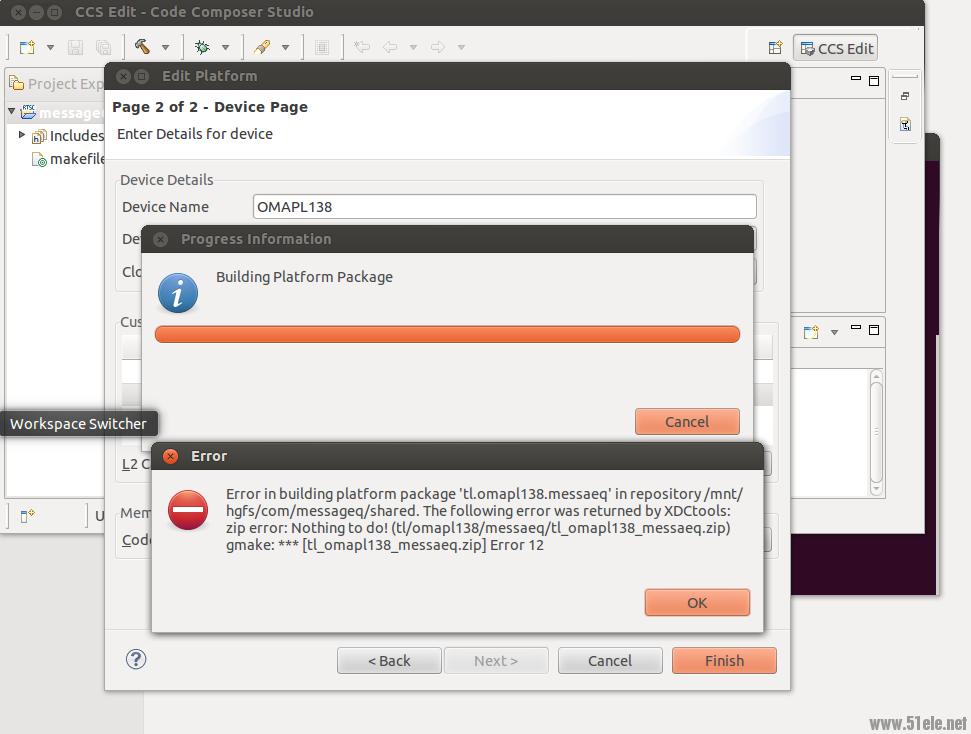

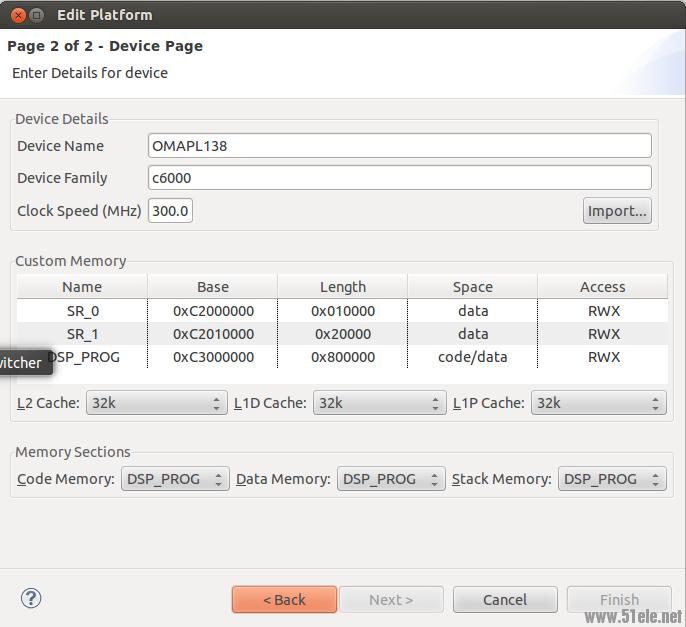

请问新建RTSC Platform时报错是什么原因?
我在编译创龙例子ex02_messageq时,新建RTSC Platform文件时报错,您遇到过相似的问题吗?希望您空闲时能为我解答,非常感谢!!
再Platform报错后,我无视它继续跟着教程走,之后就有了下面的错误

error: ti.sdo.ipc.SharedRegion: "/home/cj/ti/ipc_1_25_03_15/packages/ti/sdo/ipc/SharedRegion.xs", line 236: ti.sdo.ipc.SharedRegion : Base Address of 0xc2010001 is not aligned to cache boundary (128)
js: "/opt/ti/ccs/xdctools_3_25_03_72/packages/xdc/cfg/Main.xs", line 153: Error: Configuration failed!
gmake: *** [package/cfg/Dsp_pe674.xdl] Error 1
js: "/opt/ti/ccs/xdctools_3_25_03_72/packages/xdc/tools/Cmdr.xs", line 51: Error: xdc.tools.configuro: configuration failed due to earlier errors (status = 2); 'linker.cmd' deleted.

汪芳
2019-10-10 10:58:03
不要将platform的路径放在共享文件夹里。
