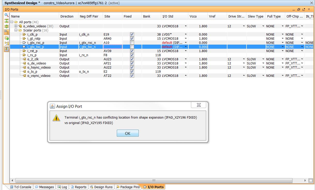

I try to do a prototype design in VC707 about Aurora interface. I configure the Aurora IP working 1 lane simplex mode, I plan to put the TX in bank 119 while RX in bank 118.
I follow the Aurora example design provided from Xilinx, to write my Xdc file. After synthesised, I open the synthesised design, in I/O planning, I can the serial pin of o_tx_p  is assigned in E2 while i_rx_p is assigned in F8. I checked the VC707 shcematic and I am sure they have been assigned in bank 119 and 118 sucessfully. However, when I try to assign the pin of GTX reference clock into bank 119 (A10) and 118 (E10), Vivado always forbid me to do that and show me a message as attachment, that said I have conflicts. However, this does not make sense.
In Aurora example design from Xilinx, the Xdc file does not constrain the pin location for GTX, but after synthesis and implementation, the refrernce clock is assigned in the right pins without problem. So I am confused why my design does not work as that.
I wonder does anyone confront the similar issue before? What does this mean?
Thanks in advance.

由于H19和G19都是SelectIO引脚,我的假设是你的设计没有在时钟输入上正确包含IBUFDS_GTE2原语,这些需要修复。

你的帖子说你把TX放在119而RX放在118,但是然后时钟输入i_gtx_rxc分配给A10,它是119中的参考时钟。

嗨mcgett,对不起,屏幕截图可能有点令人困惑。但我确信:我尝试将GTX参考时钟的引脚分配给TX的bank 119(A10)和RX的118(E10)。
或者我换了(A10用于RX,E10用于TX,我知道这是错误的,我不应该这样做)。
但无论怎样,我都会得到与我的截图相同的信息,Vivado禁止我做这个操作。谢谢。

您提供的信息不明确。
请提供您应用的确切约束。
