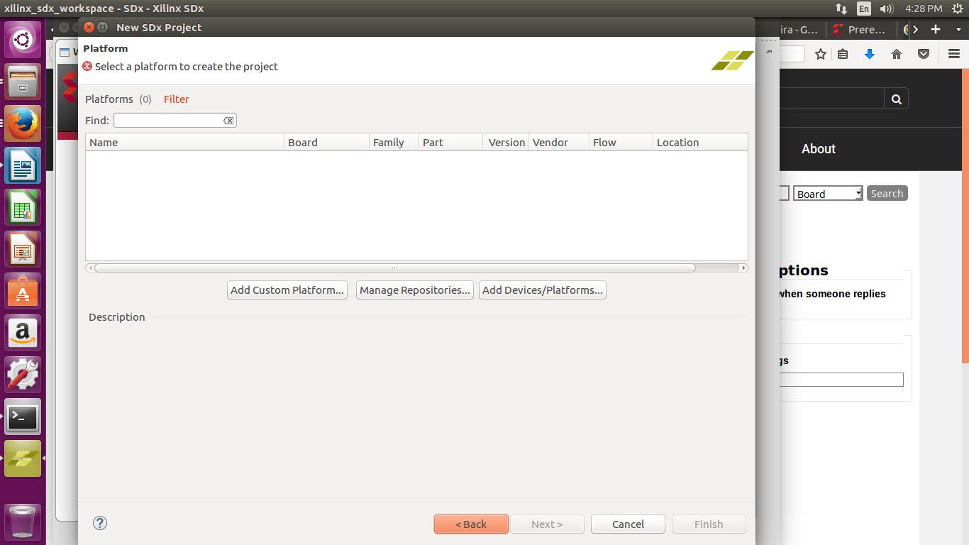

启动sdx时没有平台可用
我按照链接和第7.1节http://www.wiki.xilinx.com/reVISION+Getting+Started+Guide+2017.4在zcu102_es2中构建光流示例应用程序。
在这里,我在“创建sdx项目窗口”中选择项目名称并给出下一个。
现在出现平台对话框,但不显示平台。
我只是尝试使用“自定义平台项目”添加。
但它给出的错误是“没有平台可用”。

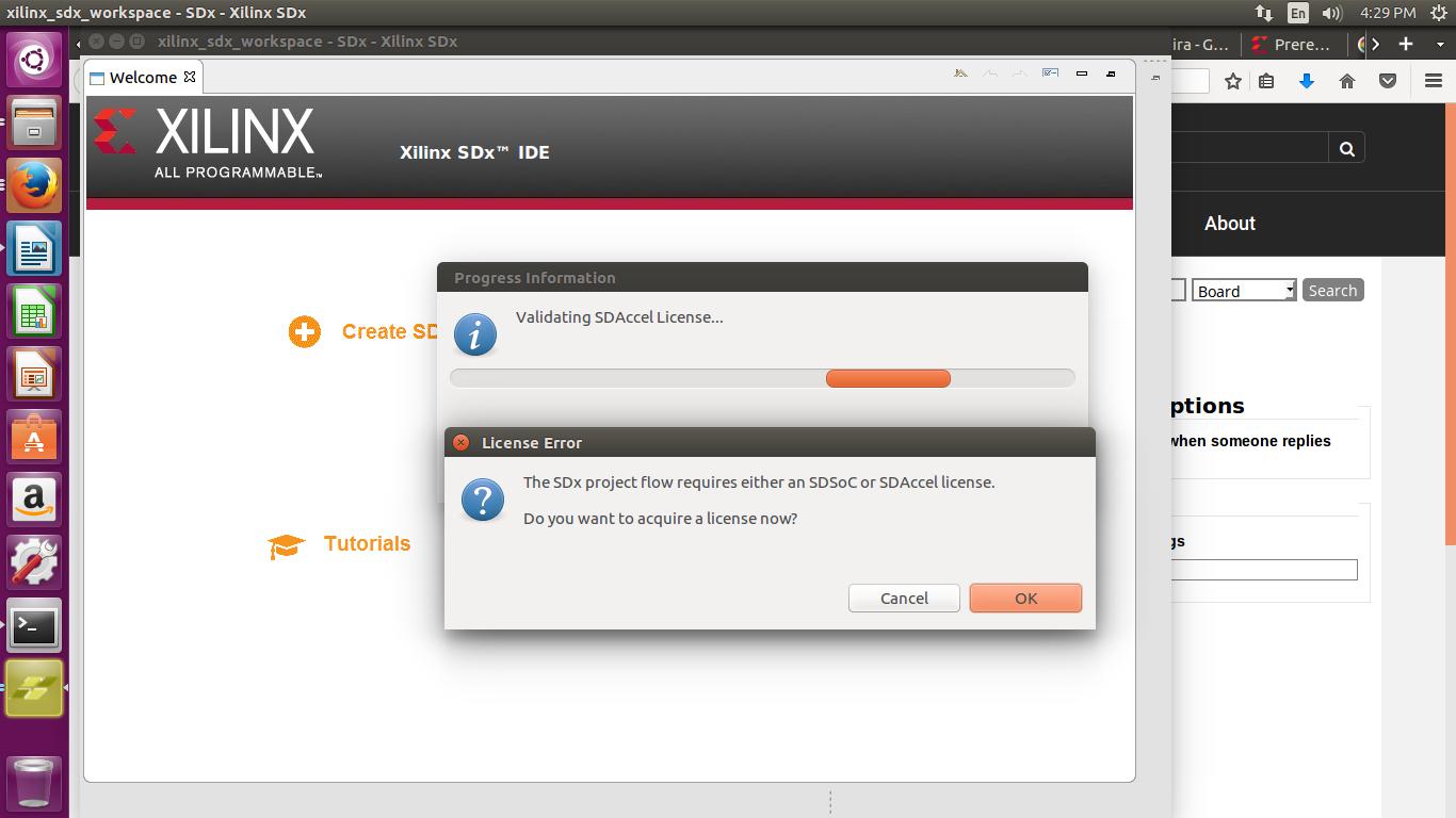

启动sdx时,它为SDAccel提供许可证错误。
许可是否是平台不可用的问题。
我为SDSoc生成了许可证,但我没有SDAccel的许可证。
如何生成?
请澄清。
我附上了有关此问题的屏幕截图。
提前致谢。

I follow the link and section 7.1  http://www.wiki.xilinx.com/reVISION+Getting+Started+Guide+2017.4 to build the optical flow sample application in zcu102_es2.  In this, I select project name in "create sdx project window" and give next.  Now platform dialog appears but no platform is displayed. I just try to add using "Custom platform project". But it is giving error as "No platform available".  when launching sdx, It is giving licence error for SDAccel. Whether licensing is the problem for platforms unavailability.  I generated license for SDSoc but I dont have license for  SDAccel. How It can be generated? Please clarify.
I have attached screenshots about this issue.
Thanks in Advance.

要了解下载和安装相关信息,请参阅UG1238.https://www.xilinx.com/support/documentation/sw_manuals/xilinx2016_3/ug1238-sdx-rnil.pdfno可用于SDAccel的EVAL许可证。您可以联系Xilinx FAE / Sales
了解更多信息。

To know about download and installation related information please refer UG1238.
no EVAL license available for SDAccel.
You can contact Xilinx FAE/ Sales for more information.

嗨@ sankareswari,
似乎SDSoClicense也没有被采用。
你能否附上以下内容:
SDSoClicense
输出Tcl命令的xinfo.txt报告report_environment -file xinfo.txt
