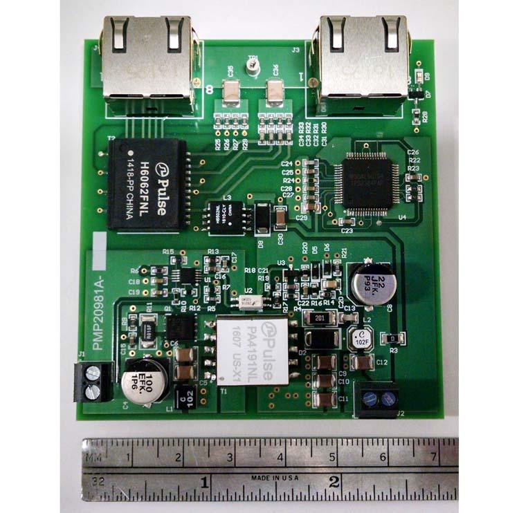

无需数字接口的全自主式单端口Type 1 PoE PSE设计
            The PMP20981 reference design utilizes the TPS2384 PSE Power Manager to implement a single port Type 1 PoE PSE.  An isolated flyback converter, utilizing the LM3481 current mode PWM controller, accepts a 12Vdc input and provides a 48Vdc/360mA output source for the PSE.  This design is  (...)
主要特色
  • Fully autonomous, no digital interface required
  • Port ON status LED
  • 1500Vrms isolation from input to PSE output
