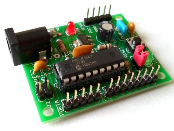

    Hello,
I want to design a PIC16F877A dev board for our microcontrollers' laboratory at the college.
The trainees are working on breadboards, and for beginners that takes a lot of time and a lot of laboratory's time is spent on wiring the simple and basic wiring; like, MCLR resistor, power lines, bridging power lines, connecting the PICkit 3 wires and connecting the load which is a simple LED.
So, I thought to save a lot of time for me and the trainees and design PCBs for the lab.
I've looked into different pictures on google images, and there are very nice ones.
And I have questions about the basic and the very important components to include in the design.
The first thing is what important capacitors to include?
I learned before the there should be 100nF caps on both power lines, but in the following picture, I see only one for the power lines.
https://images-na.ssl-ima...2BiRpABRSL._SX355_.jpg
Also, why the 4 caps at the RS-232 power? Are they in parallel to the incoming data lines like decoupling capacitors?
In the following picture, why there are different types of capacitors?
Also, the yellow ones here:
What other factors than capacitors I should consider?

是的,如果可以的话,使用一个新的PIC!对于晶体帽,有时来自PCB或布线的寄生电容使其振荡相同。不过,最好还是提供它们。
以上来自于百度翻译
      以下为原文
    Yep, use a newer PIC if you can!
As for crystal caps, sometimes the parasitic capacitance from pcb or wiring make it oscillate all the same. Still, it's better to provide them.

不,我不能把电子部的仓库装满PIC16F87A,因为它是最好的,可能还有其他PIC16F84A或其他类似的旧芯片。好吧,还有其他的PCB设计的建议或想法吗?
以上来自于百度翻译
      以下为原文
    No, I can't the warehouse of electronics department is full of PIC16F877A as it's the best one, there might be some other PIC16F84A or other similar old chips.
OK, any other advice or ideas for the PCB design?

PIC16F87将是一个更好的选择。
以上来自于百度翻译
      以下为原文
    The PIC16F887 would be a better choice.

是的,但是我们的股票是PIC16F87A。正如我提到的一个部门,他们买了很多筹码来训练。
以上来自于百度翻译
      以下为原文
    Yes, but the stock we have is the PIC16F877A. As one of the department mentioned to me that they bought a lot of these chips for training.
