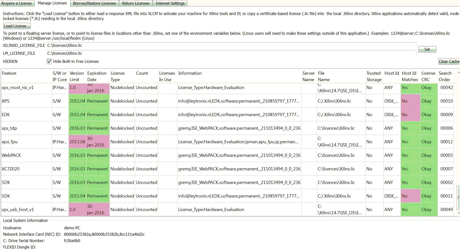

Hello,
When I try to running map, I am getting below error. Please let me know how to resolve this problem.
ISE: 14.7
I just download the license so it should be the last one.
Started : "Map".
Running map...
Command Line: map -intstyle ise -p xc6slx45-fgg484-3 -w -logic_opt off -ol high -t 1 -xt 0 -register_duplication off -r 4 -global_opt off -mt off -ir off -pr off -lc off -power off -o dfshf_map.ncd dfshf.ngd dfshf.pcf
Using target part "6slx45fgg484-3".
vvvvvvvvvvvvvvvvvvvvvvvvvvvvvvvvvvvvvvvvvvvvvvvvvvvvvvvvvvvvvvvvvvvvvv
INFO:Security:54 - 'xc6slx45' is a WebPack part.
INFO:Security:60 - The XILINXD_LICENSE_FILE environment variable is set to
'C:licencesXilinx.lic'.
INFO:Security:62 - The LM_LICENSE_FILE environment variable is set to
INFO:Security:68 - For more information or for assistance in obtaining
a license, please run the Xilinx License Configuration Manager
       (xlcm or "Manage Xilinx Licenses".)
INFO:Security:68a - user is demo, on host DEMO-PC.
ERROR:Security:9c - No 'ISE' nor 'WebPack' feature version 2013.10 was available
for part 'xc6slx45'.
Feature start date is in the future.
Feature:       WebPack
Start date:    05-Mar-2015
License path:
C:licencesXilinx.lic;C:/.XilinxXilinx.lic;C:Xilinx14.7ISE_DSISE/coregen/
core_licensesXilinx.lic;C:Xilinx14.7ISE_DSISE/coregen/core_licensesXilinx
Free.lic;C:Xilinx14.7ISE_DSEDK/data/core_licensesXilinx.lic;
FLEXnet Licensing error:-31,392
For further information, refer to the FLEXnet Licensing documentation,
available at "www.flexerasoftware.com".No such feature exists.
Feature:       ISE
License path:
FLEXnet Licensing error:-5,357
ERROR:Map:258 - A problem was encountered attempting to get the license for this
   architecture.
Design Summary
Number of errors   :   1
Number of warnings :   0
Process "Map" failed

Hi,
Can you check if your system date and time are correct?
As per the xinfo and license file the start date is March 5th 2015, your system date should be greater than this inorder to use the license.
From the xinfo file the system date today seems to be 28th Feb 2014. If this is true please set the correct system date and restart ISE. See if this helps.
Thanks,
Deepika.

Hi,
Please attach the xinfo file.
You can run it from here.
Programs -> Xilinx Design Tools -> ISE Design suite -> Accessories -> Xinfo system Checker.
Attach the license file also.

I have attached the xinfo file and the license file also.
Thank you for your help
            xinfo.txt ‏66 KB                Xilinx09-03-15.lic ‏1 KB
