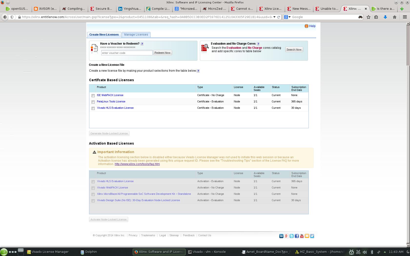

你好。
在发布这个问题之前,我曾在谷歌和本论坛上寻找可能的答案。
关于这件事似乎还有一个主题。
我已经执行了该线程中描述的步骤,但我仍然无法在产品许可网站中选择“Vivado WebPack许可证”来使用我所做的Vivado安装来生成比特流。
我总结了到目前为止执行的步骤:
1.从以下链接下载Linux许可证管理工具:http://www.xilinx.com/support/download/index.htm,以root身份执行install_fnp.sh脚本。
2.执行以下命令:./ xlicsrvrmgr -v“format = long”
并获得以下输出:
查看服务器可信存储。
可信存储中没有履行记录。
3.执行以下命令:./ xlicclientmgr -cr create_request.xml
并获得以下输出
重新使用相同的存储请求,序列号1写入create_request.xml的请求请求(html)写入create_request.html
4.我尝试使用以下命令访问create_request.html:firefox -new-window create_request.html,我仍然得到我在此消息末尾附加的屏幕。
我正在使用openSUSE 13.1(x86_64)。
希望能从你那听到答复。
美好的一天。

Hello.
Before posting this question, I had looked in google and this forums for possible answers. There seems to be one thread ongoing regarding this matter. I've executed the steps described in that thread, but I am still not able to select "Vivado WebPack License" in the Product Licensing Website to enable bitstream generation with the Vivado installation I've made.
I summarize the steps executed so far:
1. Downloaded the linux license management tools from the link: http://www.xilinx.com/support/download/index.htm, Executed the install_fnp.sh script as root.
2. Ran the following command: ./xlicsrvrmgr -v "format=long"
And got the following output:
                                        Viewing server trusted storage.
                                        No fulfillment records in trusted storage.
3. Ran the following command: ./xlicclientmgr -cr create_request.xml
                                        Re-using identical stored request, sequence number 1
                                        Request written to create_request.xml
                                        Request (html) written to create_request.html
4. I try to access the create_request.html, with the following command: firefox -new-window create_request.html, and I still get the screen that I attach at the end of this message.
I am using openSUSE 13.1 (x86_64).
Hope to hear from you.
Good day.

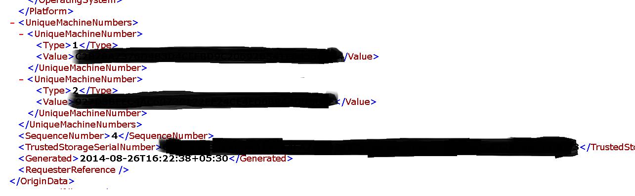

王慕涛
2018-12-11 11:55:06
嗨,
在请求字段中,我可以看到唯一的机器号1和2字段为空。
这些字段应如下所示存在于要突出显示的基于激活的许可证中。
以上来自于谷歌翻译
以下为原文
Hi,
From the request fiel I can see that Unique machine Number1 and 2 fields are empty.
These fields should be present as shown below to the activation based licenses to be highlighted.
举报
