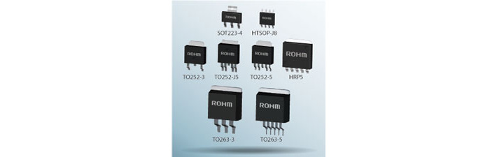

封装BD4xxM2系列有2种,BD4xxM5系列有4种。之所以具有电气规格相同而封装不同的产品,是为了可以根据不同安装PCB板的空间和形状进行灵活选择。

BD433M2WFP3-CBD450M2WFP3-CSOT223-4
BD433M2WEFJ-CBD450M2WEFJ-CHTSOP-J8
BD433M2FP3-CBD450M2FP3-CSOT223-4
BD433M2EFJ-CBD450M2EFJ-CHTSOP-J8
● BD4xxM5系列(45V耐压500mA)
[tr]输出电压封装关断[/tr][tr]3.3V5V[/tr]
BD433M5WFPJ-CBD450M5WFPJ-CTO252-J5
BD433M5WFP2-CBD450M5WFP2-CTO263-5
BD433M5FP-CBD450M5FP-CTO252-3
BD433M5FP2-CBD450M5FP2-CTO263-3

BD33C0AWFP-CBD50C0AWFP-CBD80C0AWFP-CBD90C0AWFP-CBD00C0AWFP-CTO252-5
BD33C0AFP-CBD50C0AFP-CBD80C0AFP-CBD90C0AFP-CTO252-3
BD33C0AWHFP-CBD50C0AWHFP-CBD80C0AWHFP-CBD90C0AWHFP-CBD00C0AWHFP-CHRP5
BD33C0AHFP-CBD50C0AHFP-CBD80C0AHFP-CBD90C0AHFP-CHRP5
BD33C0AWFP2-CBD50C0AWFP2-CBD80C0AWFP2-CBD90C0AWFP2-CBD00C0AWFP2-CTO263-5
BD33C0AFP2-CBD50C0AFP2-CBD80C0AFP2-CBD90C0AFP2-CTO263-3
