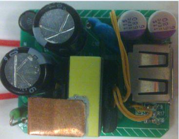

通过EMI和热测试的完全验证的高功率密度适配器解决方案
PMP4378 is fully verified adapter solution which passes EMI and thermal test.The PSR controller UCC28713 and S.R controller UCC24610 are used in the design and achieves high efficiency which easily meets Energy star 6 (average 82.7%@230Vac with 180mohm cable). The overall form factor is limited in  (...)
