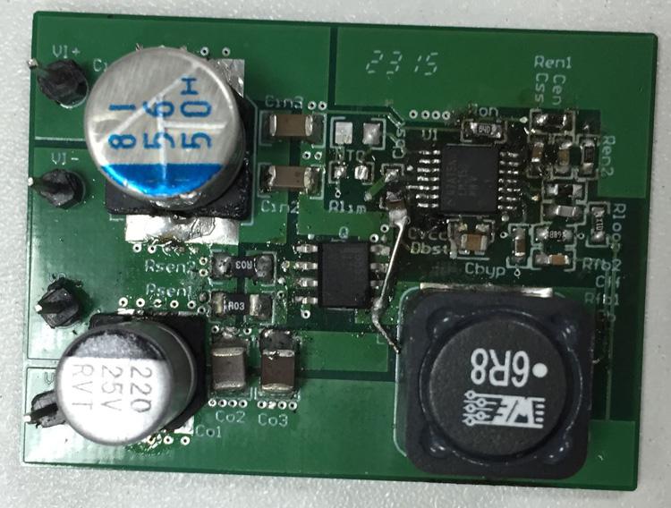

13.2V至36V宽输入、10V/4A输出同步降压解决方案
PMP10668 is synchronous buck solution which accepts an input voltage of 13.2V to 36Vin and provides a 10V output capable of supplying continuous 4A and transient 10A of current to the load. With COT control, no loop compensation circuit needed and could get good load transient performance. Synchronous grants the high efficiency. This reference design could be used for high power and the requirements of load transient in applications such as a ginbal motor.
主要特色
  • COT control, no loop compensation needed
  • Good load transient performance
  • 13.2V to 36V Wide Vin, supporting up to 10A transient
  • Synchronous solutions, high efficiency
